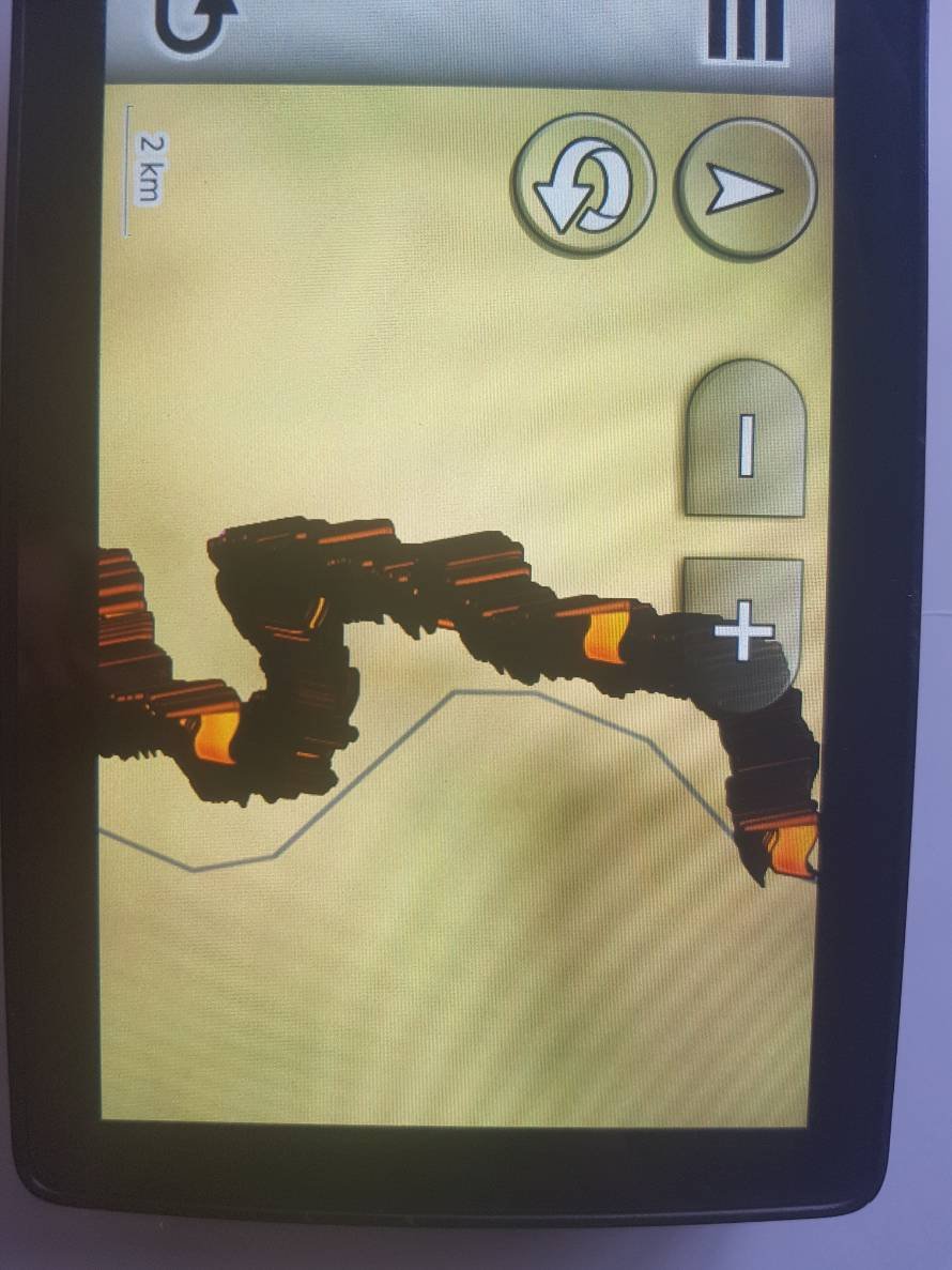

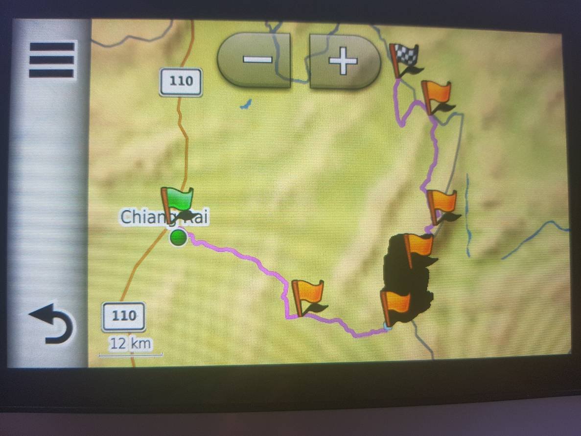

Hi,
when I use Basecamp (I use Trip Planner) and upload the route to Navigator 5 or 6 I suddenly see hundreds of points (see pics)
This happens only when I use shaping point (dragging the shaping point on another road to change the way)
And it happens not to all Navigator devices. If I use waypoints it works fine.
Any idea what might be the problem here?
Problem with Basecamp when uploading the route onto GPS
- Garmin fault 1.jpg (110.49 KiB) Viewed 11138 times
- Garmin fault 2.jpg (129.82 KiB) Viewed 11138 times

The first diagram looks as though it contains hundreds of individual points that might (for example) make up a tracklog or a route that has been converted to a track, or a route that has been converted FROM a track. Also I wonder if the route was imported from some other program first.

Usually on the Zumo satnavs, Via Points will show up as flags.
Flags are what you seem to have - but there is a limit to the number of Via points. Any more than 31 and the route may be split into 2 or more separate routes, each with 29 or 30 Via points. You seem to have hundreds of flags - which suggests that something else is going on here, but I cannot work out what from what you have described.
If you are still looking in to this thread and haven't yet sorted it, I'd be happy to help work out what is happening.
