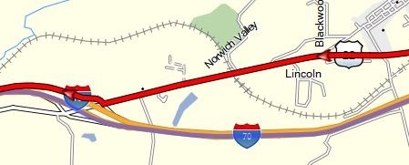

ALL of the colors for a selected route are bold and opaque - they ALL block highway markers, which are placed on the road. Text road names sit next to the road and usually peek out from under the color. Un-selected routes are muted and somewhat transparent.

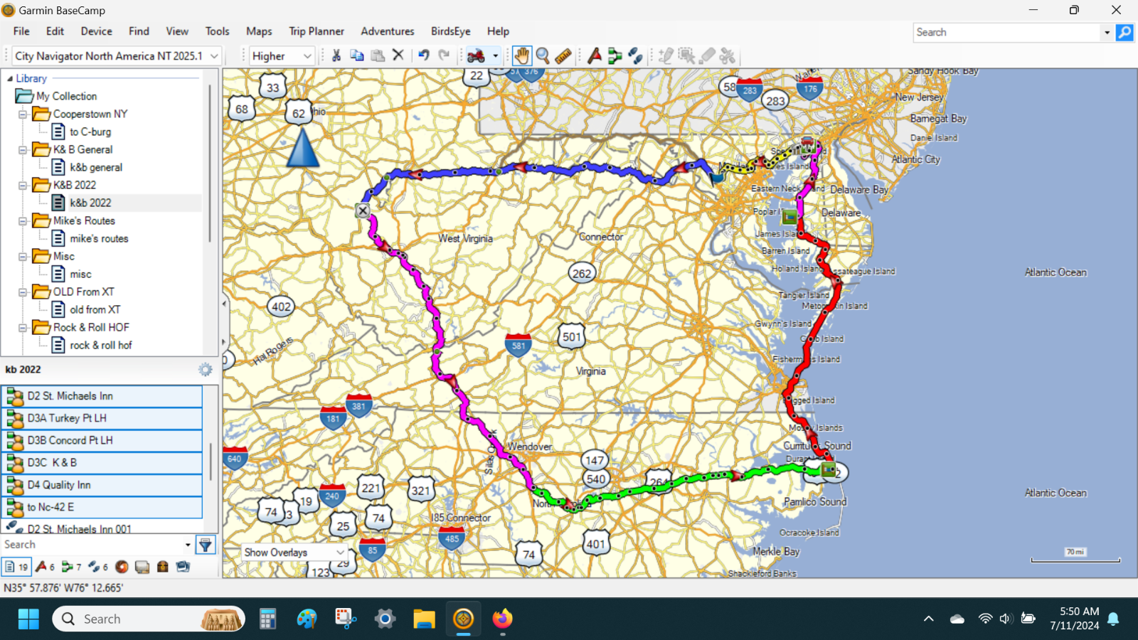

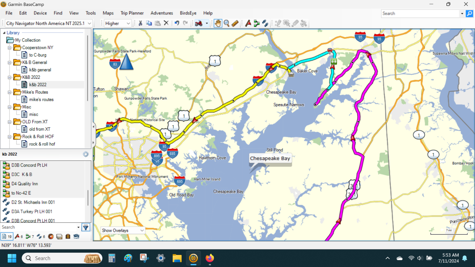

Thanks All. I know how to change the colors per route. I was down to Green Cyan Magenta and sometimes Blue. I ruled out Yellow because it didn't provide contrast to the map road colors. Blue and water didn't mix so I avoided it for shoreline rides. Dark colors appear to obscure road markings. They don't in reality, it's just my perception, so I don't us them.

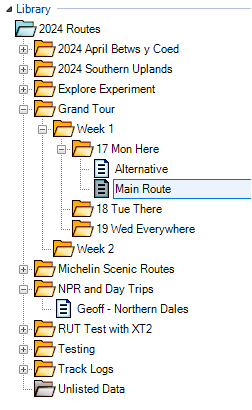

Not that I ever use them - but you can have folders within folder within folders if you wish.
There comes a point where it is so organised that you cannot find anything !
The Grand Tour Folder is way over the top and just for illustration.
Typically I have a few folders each with few lists in them. - Like the NPR and Day Trips folder.
It doesn't seem much for someone who has been using Basecamp for many years. That is because I start a new database each year. I can switch to the old databases if and when I need them. That is quite easy to manage too and it keeps old planned routes well away from the current ones.

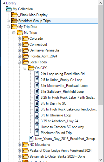

Yup. Below is the upper portion of my current Library list.
BTW, if anyone is frustrated by Basecamp always opening to routes displayed on the map, notice my first Library folder is named "_Blank Map Display". This is an empty folder. The leading underscore in the name sorts it to the top. I select it before shutting down Basecamp resulting in Basecamp always opening with an empty map. I'm sure some of you prefer it to open to the route last being worked on but if you like a clean slate from which to chose what you want to work on, this method works well.

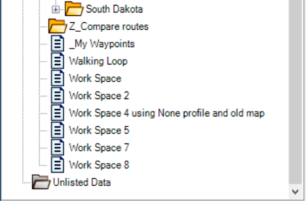

Sounds like you use "_Blank Map Display" much like I keep a Temp folder, holding only an empty Temp list. That list produces a (usually) blank map and is my Basecamp workspace, where any work in progress resides. (I was tired of trying to do something and being told I need to create a new list first). When real trip plans are finalized, the contents are moved from Temp to one of the permanent folders, with appropriate renaming. For experimental "what if" routing, the Temp list contents get the Ctrl-A, Delete treatment.
- Posts: 2126
Re: What colors do you use for routes?
I keep a number of temp working lists going, deleting or copying content as needed, sometimes renaming and moving.
