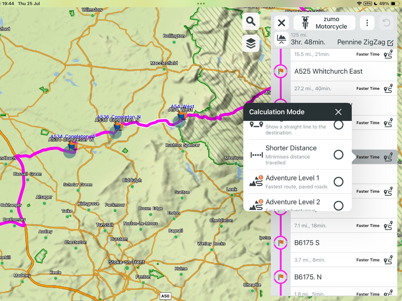

Take a look at the screen shot of my Ipad taken from the route that I planned in a hotel room on Tuesday night. Click the image for a better view.
You can see that I have a number of Via Points (orange flags). You can also see that there is a little blue flag as well - in the same place. This is because before creating the route, I zoomed in and created a few waypoints first. (Remember that a Waypoint is a saved location, it is not a point on a route as many people believe).
Once I had my waypoints accurately placed - by zooming in on the ipad screen to get the cross-wires locate in the middle of a road - and named so that I can recognise the location - then I can start to create a route.
THis is very easy on the screen. Start by tapping the dotted s-bend button.
Tap a waypoint. The Ipad offers Start here/Start with Cringles
So I start with Cringles. The right hand pane pops up with my new point at the top.
Tap another Waypoint - A525 Whitchurch East flag. More options - I choose 'Add A525 Whitchurch East'
The list at the side grows.
And so it goes on. You get the options because the Tread app recognises that you might have been pointing to something near the flag, not to the flag itself. So it lists all of the things that you might have been wanting to point at.
And so it goes on until you have tapped each little blue flag on the screen and added that waypoint to your route.
What I do then is save it. You save it by pointing to the cross at the top left of the right hand menu.
Yes you want to save it - and the route disappears. Which is odd, and inclined to force you to mutter something like 'Tish, Oh dear me'
But the route that you saved is now in the top left 3-bar menu - Explore Library.
You'll have a job finding it becasue you forgot to name it and you didn't notice what the Ipad had called it. But it is there. So you choose that, and the first thing you then notice is the little pencil in tht top right corner - next to Pennine ZigZag in my screen shot. THat is what you use to rename it.
While you are there - spot the three dot menu. Delete Route/ Route Settings/ Garmin Adventurous routing.
I am not going to dwell on that (yet) becasue on my screen shot, I have tapped aprt of the map where the route is. The bit between A536 Congletone N and A54 West. I got a pop up asking me what I was pointing at, and one option was 'Select this segment'. For Tread a new term 'Segement' has been defined. It is the bit of route that lies between two Via Points - (or stops as they now seem to be named). That segment is highlighted with a white outline. Very pretty. Frills.
Note that the route list has a line between each pair of Via Points - with some distance and timing information - but also 'FAster Time'. You can change the route preferecne for each segment. You could never do this with Basecamp. The options are Faster, Straight, Shorter and Adventurous 1,2,3,4. And it applies just to that section.
Unlike BAsecamp routes - this information is sent to the XT2 it is recognised by the XT2 and if the route is recalculated, that segement will be recalculated using the setting that it was saved with.
Overriding all of this are a few settings which apply to the whole route. Popular Paths (Moto), Michelin Scenic Roads, Hills and Curves.
You select whichever you want the route planner (and the XT2) to consider using when calculating your scenic route segement.
