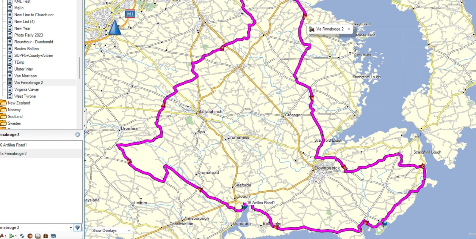

Ok from the description of your test it might be too simple. Try conceiving a route with at least three or four shaping points and a via point. Normal behaviour is that if you skip a shaping point and it recalculates the route it will take you to the next closest shaping point on the magenta line. Try to make the next shaping point after the one you miss (and the unit recalculates the route) closer to you than the one you missed, or the unit will try to take you back to it until you are closer to the next shaping point on the magenta line. If you skip a via point the unit will try to take you back to it unless you use the skip button on the unit. I always have this shown on my navigation screen so that if I want to delete a via point I can. If you do this the unit should route you to the closest shaping point. My test route (because I have been extensively testing MRA and OSMand on Android auto on my Africa Twin as replacement for Garmin) is 85 miles with a start and finish point 2 via points and 20 odd shaping points routing round very minor roads (to test the XT and other options Faster route /faster road behaviour). The route has several options for me to test behaviour on missing shaping and via points. Always a good idea to create a track of the route as well so that you can see that the route is exactly as you've intended. Good to practice/check these things mind before you need to use them for real.

Thanks - yeah, I was wondering if it was just that the distances involved in my tests are too small, since I'm testing in an urban neighborhood on a grid. Though I still can't imagine any reason why it would route me past the destination just to go back to a shaping point in the middle!
