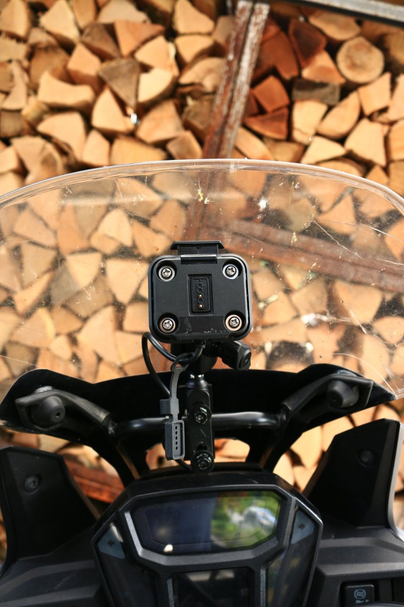

I bought my unit about a month ago and installed it pretty much a few days after I got it.
My bike is a Africa Twin 2017
I have done one short tour with it and it has worked to my expectations except for one large issue
The mount! In particular the hot shoe connector
I have the mount center above the dash of the bike and nicely tucked in behind the windscreen.

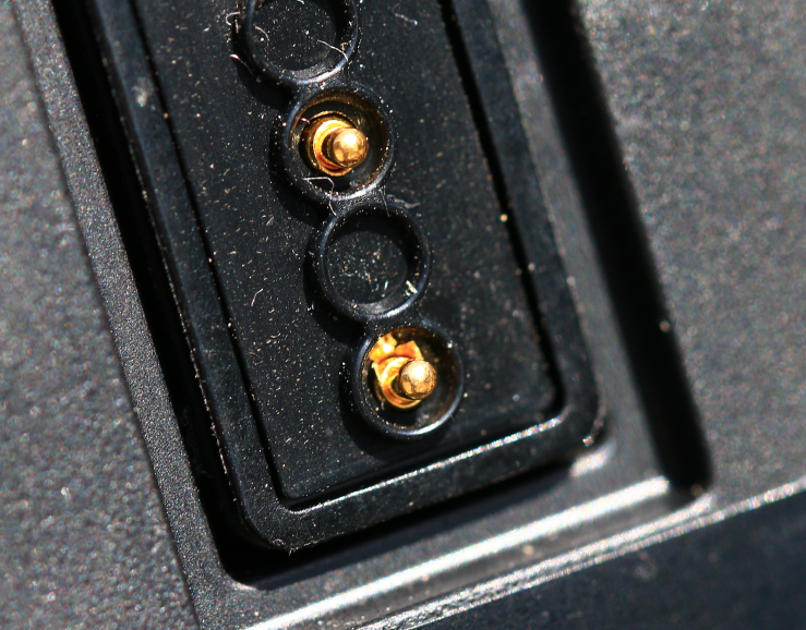

One day during my ride, I noticed the navi just switched off!
It would not switch back on and so I began to investigate.
Seems the battery was flat, so when I powered it with the USB cable, it powered up.
A further look around uncovered this...
Screenshot from 2020-06-24 15-32-32.png (1.18 MiB) Viewed 19497 times
The metal sheath of the lower pin is badly damaged.
If you mount the unit to the cradle and the lower pin is bent upwards, no power is fed to the unit.
I found that the pin is still connected to power, but for how much longer?
So how did this happen?
I have a few theories:
  • During packing and riding around, something snagged onto the pin while the unit was off, and the hot shoe rubber cover was not on.
    Considering how weak these pins seem, I think it could easy be done with a jacket or some other bit of riding gear carelessly thrown over the dash during wardrobe adjustments
  • Or, it is the rubber cover for the hot shoe connectors. After inspection, I noticed this thing is rather finicky to get on and one is tempted to push down on it to make it catch and seal the connectors. Upon closer inspection of this cover, seems it is not inconceivable that the act of covering the pins with this cap could damage the pins.
  • The pin was damaged from the start and was made worse with use. I did not look so carefully at the state of the pins when I got the unit. It is off course possible that these sensitive pins could catch on something and get damaged, e.g. the loop side of a Velcro tab on clothing(This is more a reinforcement of point 1 I think).

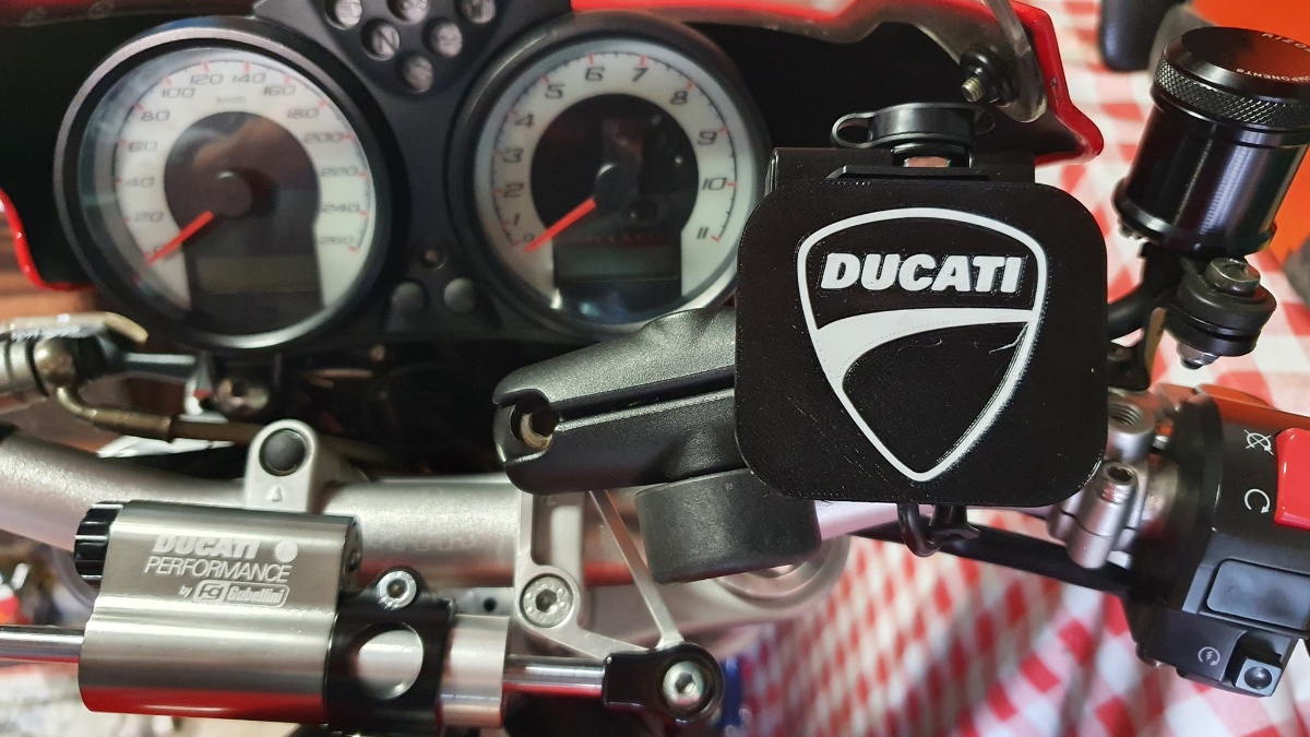

axamax wrote: Wed Jul 01, 2020 2:50 pm Has anyone made an alternative mount cover more in line with that of the 595/590?
Here you go https://www.thingiverse.com/thing:4208663 The Dutch guys on their Facebook page have been making these.

Vespamarc
Posts: 47
Location: Adinkerke
Been liked: 14 times
Belgium
Re: WARNING - Garmin Zumo XT hot-shoe connector weakness
Post by Vespamarc »
There is also Bert Klein, a Dutch guy who printing covers on demand, normally black or with logo. Find him @ Dutch XT facebook, or b.klein@chello.nl
