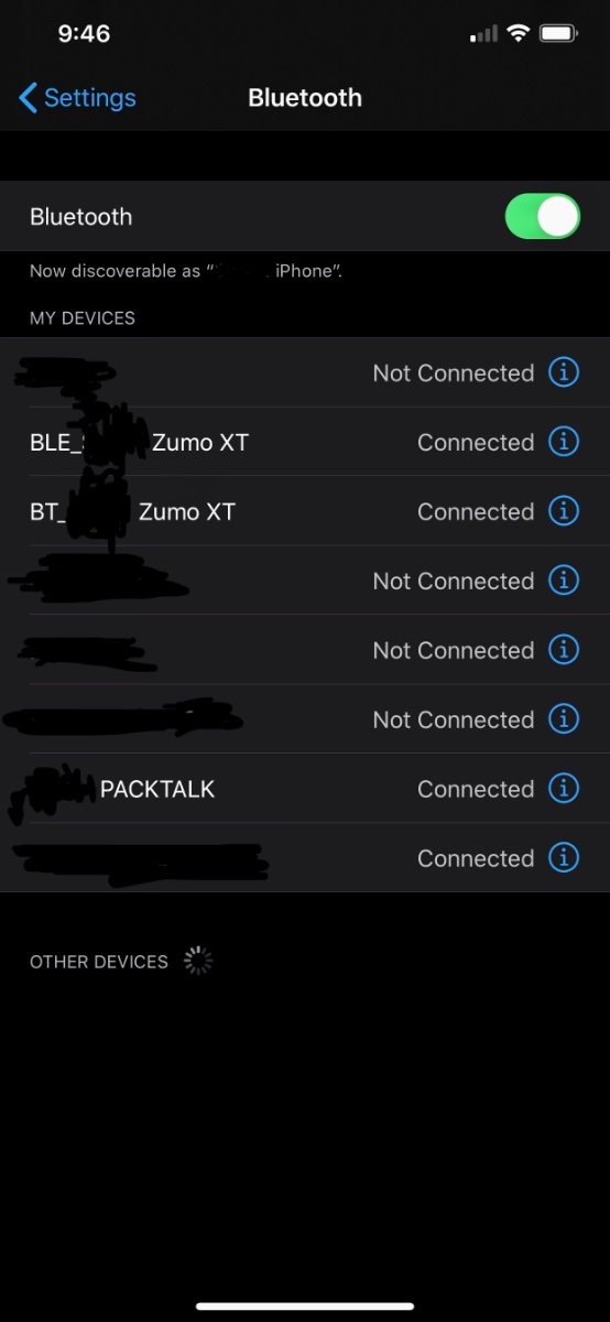

I followed the sequence you mentioned and it actually fixed issues #1 see picture attached. I need to check call status when I will in DMC mode. Don’t have riding in my weekend plan. Hope this will work as well. I will report once tested.

I would like to update on issues I was facing. The workaround posted by [mention]mrmagloo[/mention] fixed the issue.
