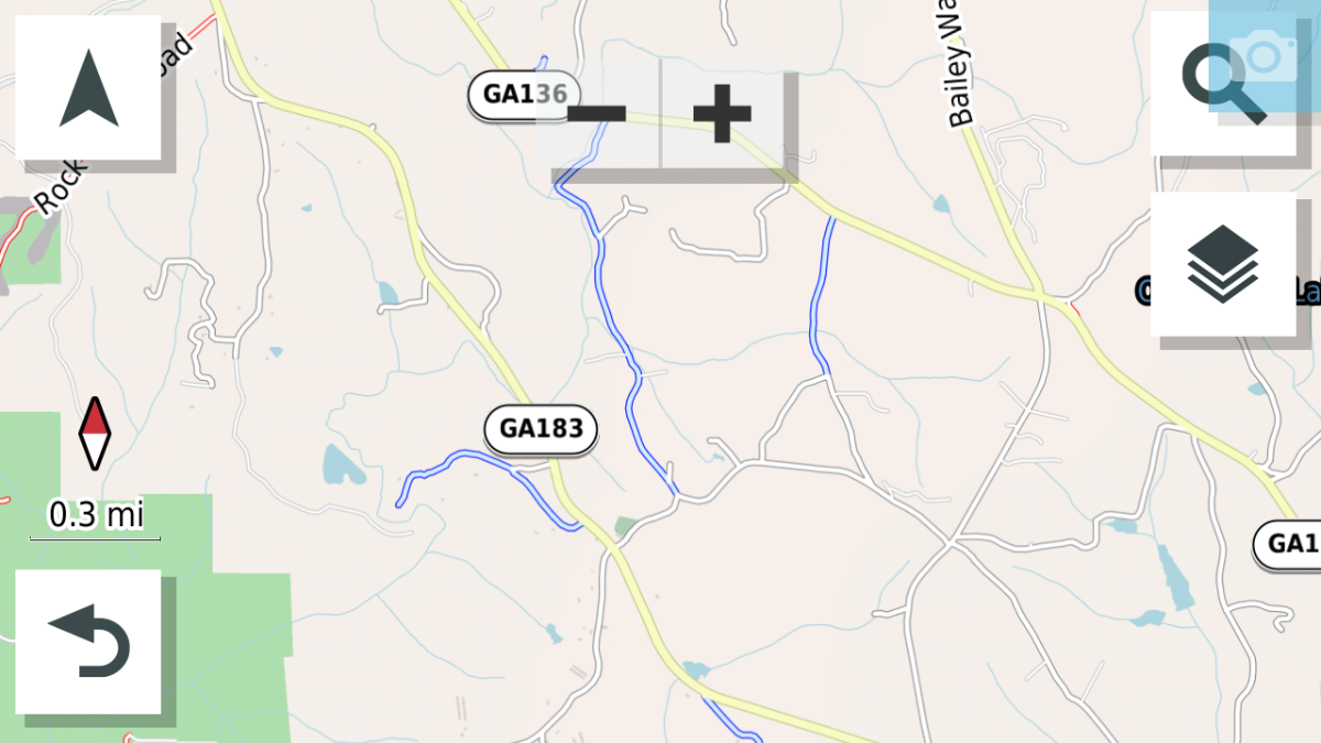

TheFifeBand wrote: Sat Oct 24, 2020 11:17 pm I am considering buying a Zumo XT so that I can stop using my phone for navigation. However, the one feature I really want, but can't tell if it exists, is the ability to determine the road surface on a map. Specifically I am interested in riding exclusively on gravel and dirt roads. I don't want to ride on pavement. I know there are features to prefer pavement when routing, but I want the opposite. I want to be able to look at the map and based on color or some other indicator, know that a road is gravel or dirt.
I have watched dozens of videos and searched hi and low, but I just cannot tell if this is a feature or not. Can you tell me if the Zumo makes this possible?
The XT is capable of distinguishing between road surfaces, but the maps that you get with the Zumo do not do that. I've had to resort to making my own maps using OSM data. I made my own maps for the Montana 600 I had before the Zumo and the Zumo is very different. It doesn't follow the same rules that most of the other Garmins do so it makes it very difficult to build good maps. It sounds like you'd be better off with a Montana, it is a much more configurable interface and it is easier to get maps looking good.
It seems like the Zumo is much better for road biking, and the Montana is better for backroads, dirt roads, and trails.

I was able to do this using Openstreetmap data and a custom made map, but not without a lot of effort. I'm posting the code on Github here https://github.com/markcushman/motomap if anyone wants to try to replicate this. I'm modifying the scripts to create bigger maps eventually but the code there right now would do approximately a US state area of roads depending on road density.
The good thing about doing it this way is that you can correct the road surface on openstreetmap.org by contributing to the open source map, then re-gen the map.
cushman
Posts: 4
Joined: Sun Dec 27, 2020 8:46 pm
Re: Gravel and Dirt Roads - How to Tell?
Post by cushman »
An update, I'm making precompiled US and Canada maps available on my website http://motomap.org/

I am not sure about in the UK but my maps that came on the unit here in the US show the dirt roads on the computer using base camp, as double dashed lines, but not on the XT unit itself, which is weird and a major bug I think. My old 60CS showed them as dirt.
I found no way to change them to dashed on the XT, but you can open the theme file, Garmin.kmtf or something like that, do a save-as, say dirt.ktmf and then go in and change the color or line width scale for the "unpaved" roads. I made mine a much thicker dark brown line so they show up more obvious. For more details google changing the garmin theme as there are things out there to explain and help choose the colors.
