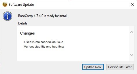

Posted: Fri May 21, 2021 1:16 pm
Todays screen shot from Basecamp for PC
21 May 2021
Basecamp 4740.jpg (13.41 KiB) Viewed 4133 times
