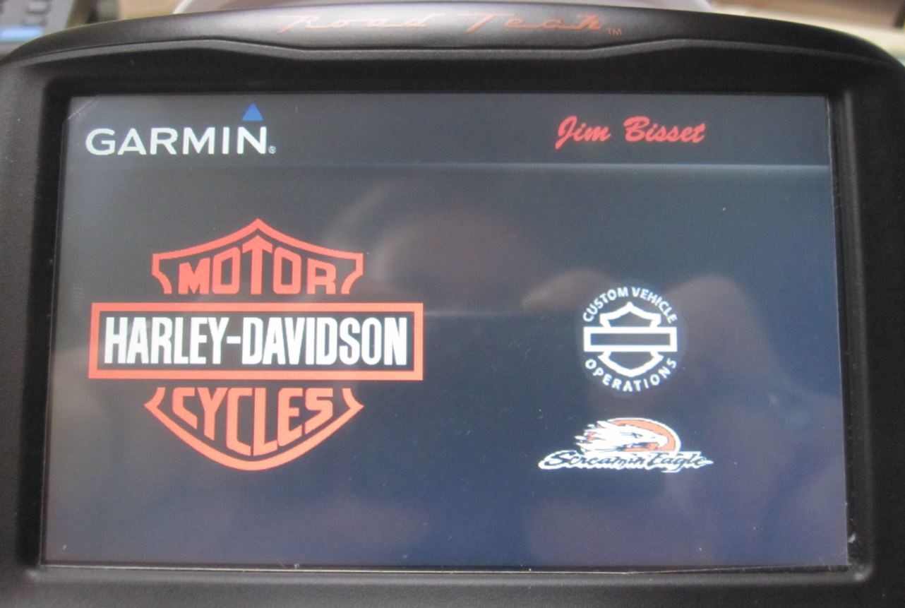

Only other thing I've done (you probably saw it in another thread) is to customise the splash screen.
No portrait mode disappears when you go to the 595 firmware - not something I miss, never used it. I don't think there are different geographic versions of the firmware either - I'll have what you have, if you see what I mean. I definitely prefer the 595 version though, and on the Harley Davidson version of the 590, the 595 upgrade does all I want and keeps the tone sent to interrupt the Harley audio system when it speaks instructions. My dream GPS

I've never bothered with the splash screen. Which file is it ?

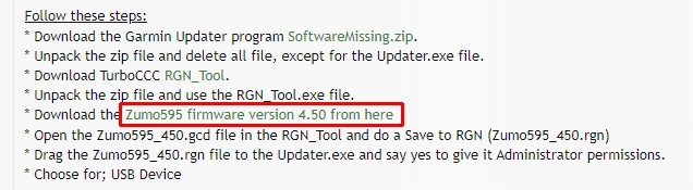

The linked document has a link to the 4.50 version of the software. The latest version was 4.60. Fiddle with the url and make the obvious change. The 4.60 file is there - I just checked.

Thanks JF. The XT is no use at all to me, not having a wired connection. My 595ed Harley 590 is for me, everything I want. Splash screen is in a memory region that you can't normally see. It was always said that it couldn't be done on the 590, but it can!jfheath wrote: Thu Dec 01, 2022 1:05 pm Ok - thanks for that info @biz.

Thanks for keeping me on my toes. It's always a good idea - but in this case, the link to which I was referring is the one in the document that the link on this site points to. Highlighted in the screen shot below. It points to the 4.50 software, rather than the later 4.60.
You just have to change the 5 to a 6 in the link to get the last version of software.

IT matters not - that link to the 4.50 software needed pointing out anyway - especially since 4.60 contained some software fixes.
