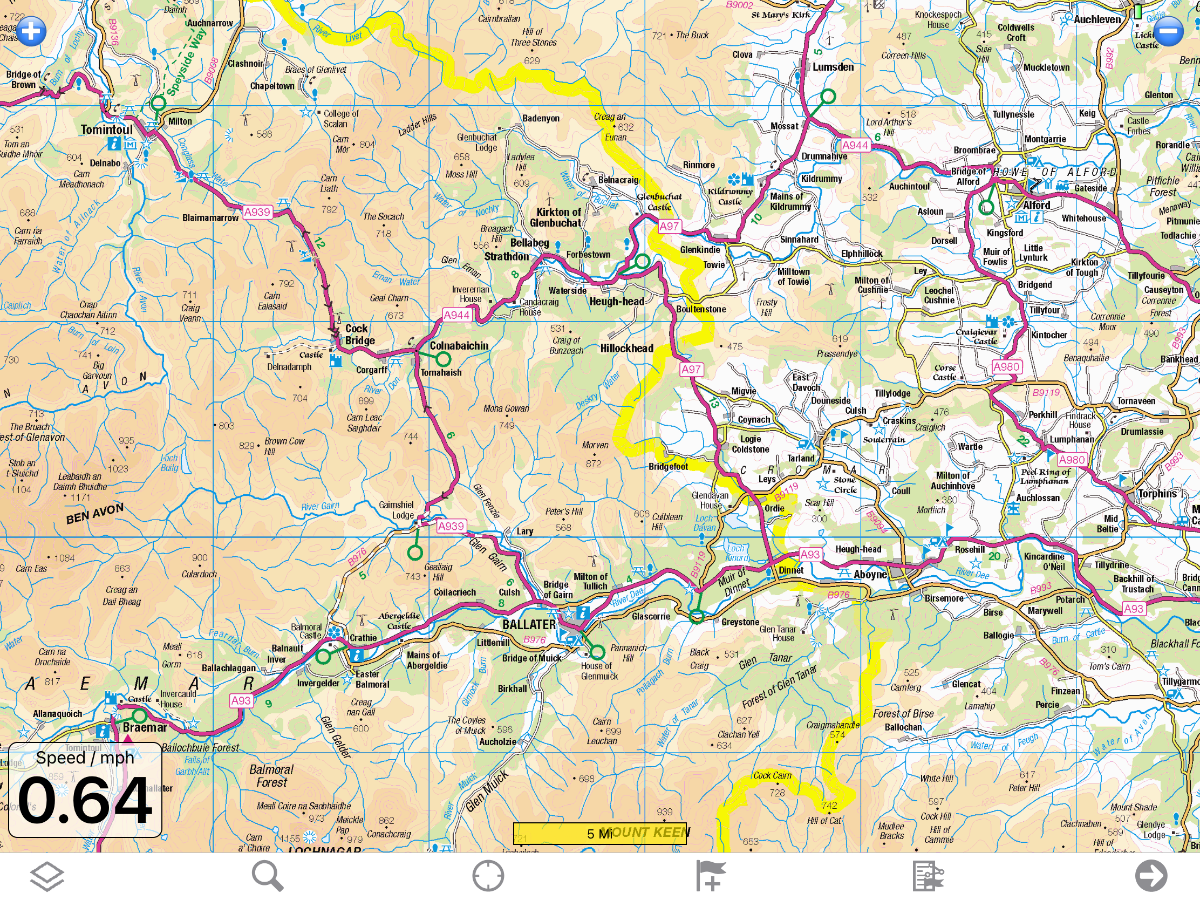

Hi. Re your Scotland trip.
If you are venturing anywhere near Ballater, (and it would be criminal to head up the A9 to Inverness when you could go through the Cairngorms) there is a major road closure at Gairnshiel Lodge - the steep sided triangular bridge that leaves coaches and trailers stranded like the road sign. They are building a new bridge and modifying the roads to allow the crane and vehicles with the girders to get to it.
These are the 3 roads that meet at Gairnshiel Lodge Bridge:
The B976 NE from Balmoral Castle / Craithie.
The A939 NW from Ballater
Both of these have junctions with the A93 between Braemar and Ballater - alongside the River Dee. Royal Deeside.
The third road is the section of the A939 N from Garnshiel Bridge to where it meets the A944 near Corgarff Castle.
The A944 is open, as is the A939 W past Corgarff Castle and climbing up over The Lecht ski summit.
The map shows the section concerned. The preferred route is form Craithie / Balmoral Castle along the dotted B976 and then the A939 heading north. This route is the left hand side of a 'square' of A roads. The detour takes the other three sides of that square.
The detour heads east along the A93 for 6 miles to Dinnet. North on the A97 to Boultenstone. Then west on the 944 to Colnabaichin where it joins the A939.
PNG image.png (1.59 MiB) Viewed 2046 times
It is still worth it to do that amazing Lecht road, on the A939 from Cock Bridge to Tomintoul, but if your day is already stretched to the limit, it could be a bit demoralising if you don't know about it. I thought that the sign said that the road is closed until 22 October 2022. This report says 10th October. I'll check the onboard video when I get home.
