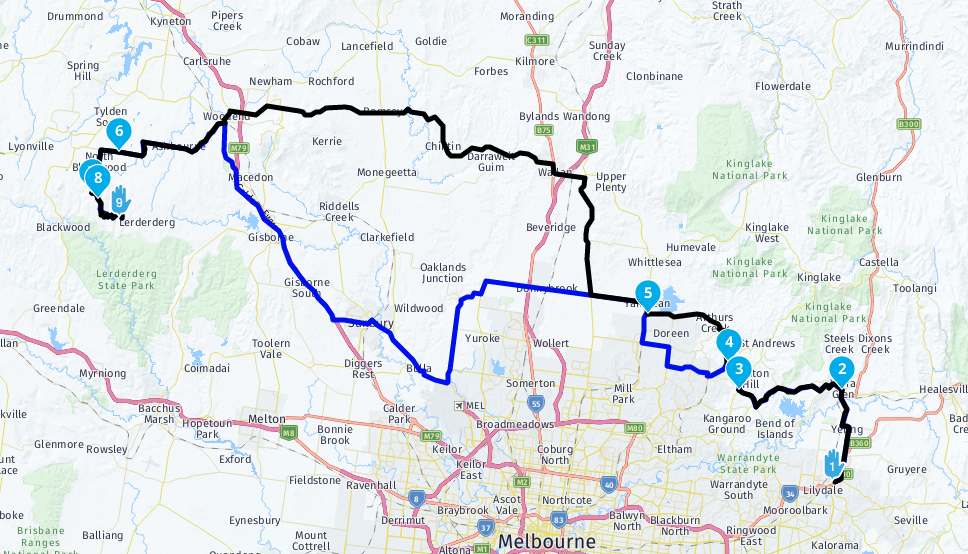

This is what happens when you compare the Here (Garmin map) route with what Open Street Maps would want. Once again if the route had been created in Open Street Maps when it was loaded into the XT the XT would have navigated along the black line and deviated from where the owner thought they were going to go.

Maybe I'm underthinking but it's obvious to me that you are not using enough shaping points to define your desired route regardless of what maps or route creation scheme you use.

In my opinion you need to set closer (more) shaping points because after you miss a via point Garmin will recalculate using its own "mind" to the next one.Fourbears wrote: Wed Feb 09, 2022 9:13 pm Over the last two days I have travelled 600 miles odd and had a couple of niggles with my XT. I created 3 routes in MRA and put some Via points in to tell me when I was coming up to fuel stops etc. However I miscalculated a fuel stop and had to look for one off route so used the category search and inputted a petrol station as my next stop in the active route. After refuelling I set off again and after about 3 or 4 miles realised that the XT was not taking me on MY route but a completely different on on motorways to my next Via point. I had to stop and reselect my rote on the XT and it took me on the route I planned. Today it has done the same thing as I added a Via point in MRA and exported it to the XT before starting off. It then tried to take me on motorways again and I had to reselect the route. On my 3rd route back I missed a Via point by skipping it on the XT (as I didn't want to stop) and it then took me a completely different way to what I had planned. Any ideas as to what went wrong or do I need to put more waypoints in my routes? They were reasonably simple so I think I only had about 10 points, if that, in each route. Each one was about 200-250 miles on a variety of roads but in my logic I thought the XT would just stick to the route and recalculate it where necessary.
