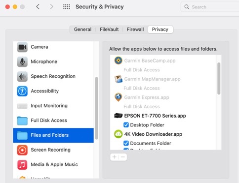

Bluenoser2 wrote: Mon Apr 11, 2022 3:03 pm No worries about the delay!
Does Garmin Express and BC have "Full Disk Access"? See screenshot. Was your Zumo on or off when you connected it?Image

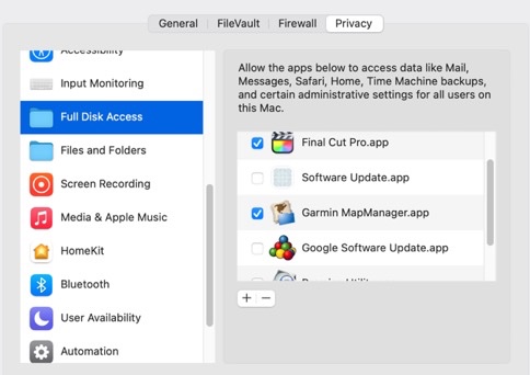

Thanks again for all your help! I went under Full Disc Access and the only thing showing was Garmin MapManager.app which was "Un-checked" I checked it as shown;

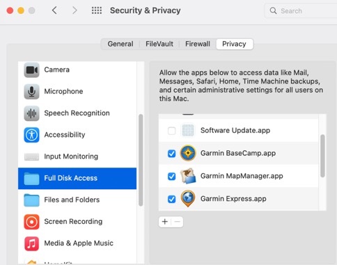

I then added Garmin BaseCamp.app and Garmin Express.app as shown;
I then tried to add the Zumo as a device in Garmin Express. It wasn't recognized in either situation.

I'd like to add, by checking all three boxes under "Full Disc Access", the three Garmin apps are grayed out under "Files and Folders" as shown;
Thank you again for all your help and time in trying to figure out this problem. I sincerely appreciate it.

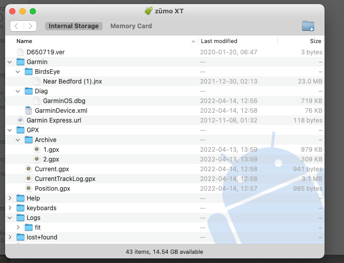

Just tried it and it connects. It takes a while though.
Open AFT and turn your Zumo on. AFT says no device found. Leave that window open for now.
Connect your cable - on your Zumo hit "Continue" to enter USB file transfer mode.
Click the "ok" button on AFT where is says no device found. It may take a click or two or you can wait. Eventually you should get this AFT window open - see attached.
Open Express and you should get "AFT must close" message. Click ok to close AFT.
Mine connects. It takes time and I know that it is going to connect to AFT when the Zumo screen dims.
Try that and be patient waiting for it to connect.
There is a software update I noticed - version 6.40. Since I installed that, it seems the wait time from AFT to Express is shorter. Or, maybe I have accepted it as being slow - LOL!
Screen Shot 2022-04-14 at 12.59.02.png (106.49 KiB) Viewed 11690 times
