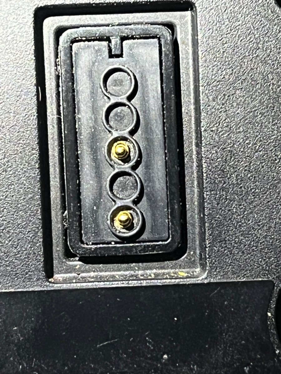

XT Mount.jpg (306.19 KiB) Viewed 2764 times
So am I right in assuming that I have the newer mount and the old cable?
Re: Zumo XT not recognizing it's on the cradle
Posted: Sat May 14, 2022 10:25 pm
by Thrasherg
You are correct.. that is the old power lead and a new cradle..
