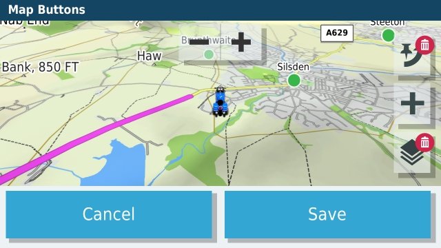

I wonder if you have spotted the additional features that came with the various upgrades ? I have been maintaining a log of these updates (as many as I captured) here: viewtopic.php?p=9993
V5.90 was a massive update and includes this enahncement (click the image to see a sligthly clearer version):
Skip Update.jpg (12.79 KiB) Viewed 539 times
You can display 3 buttons at the side of the map. If you already have some, simply long press one of them and you can delete / add a new button in the position of the large 'plus' icon. One of these buttons is 'Skip'. The necessary instructions are in the image above.
Other options are Map Orientation, Map Layers, Garmin Powerswitch, Stop, Edit Route, Mute
