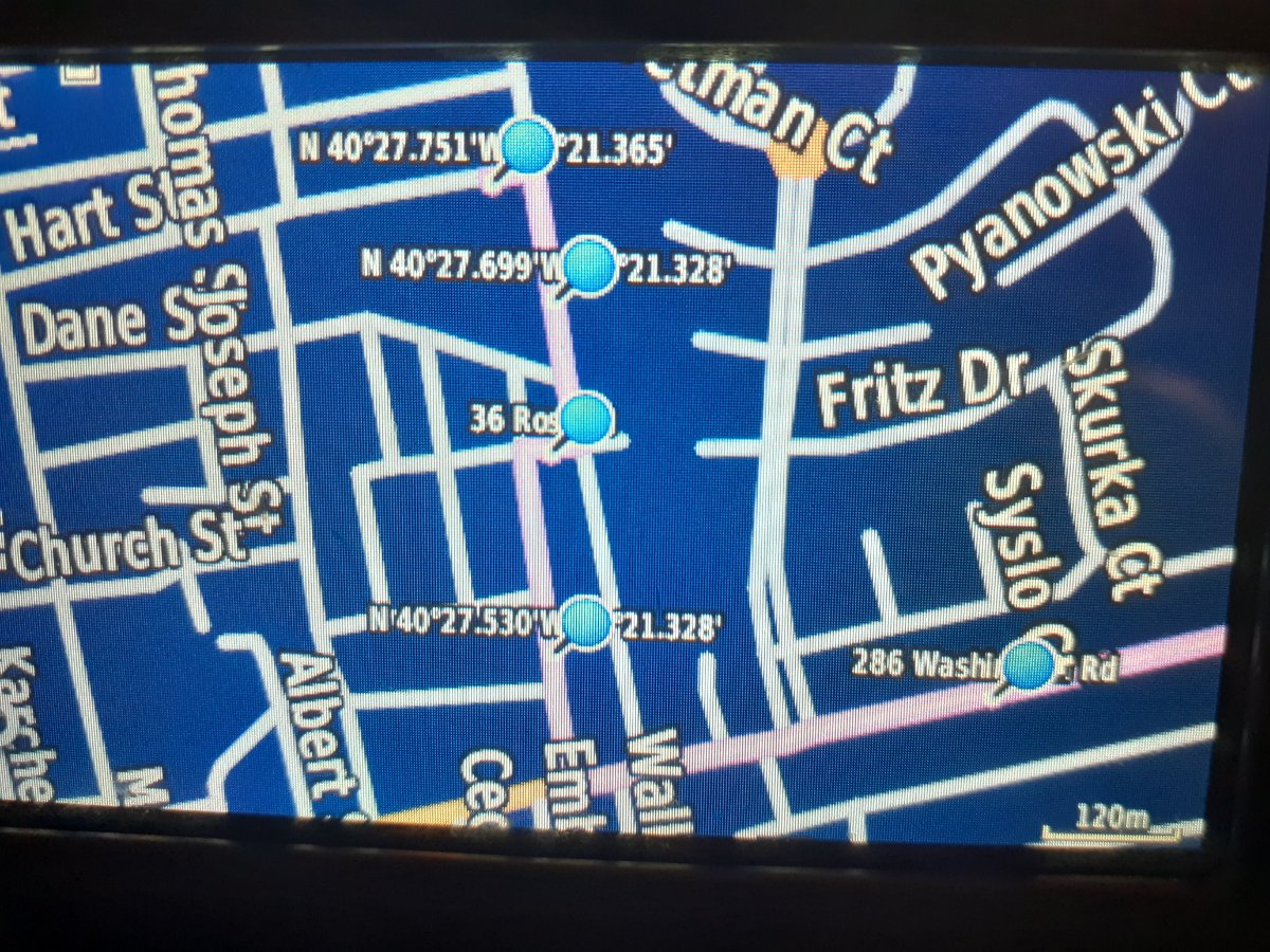

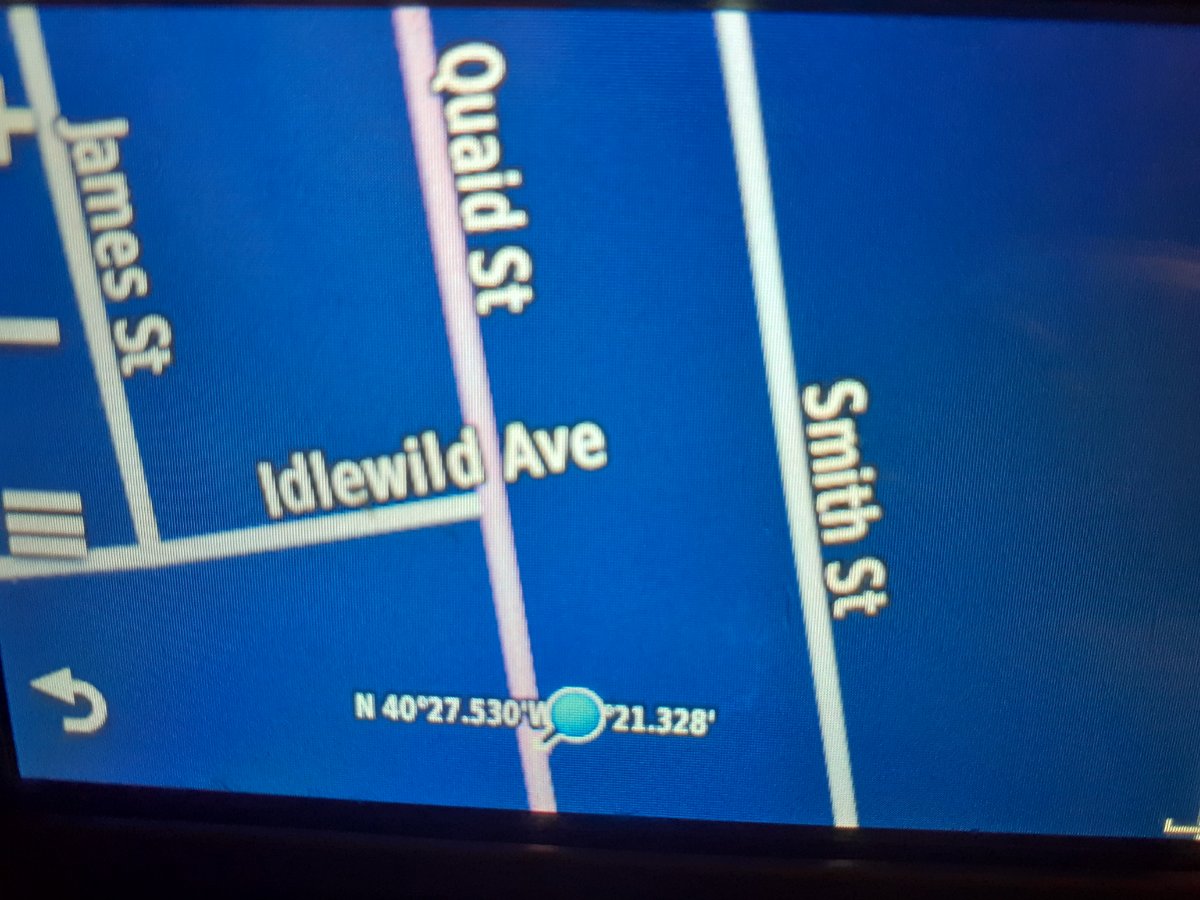

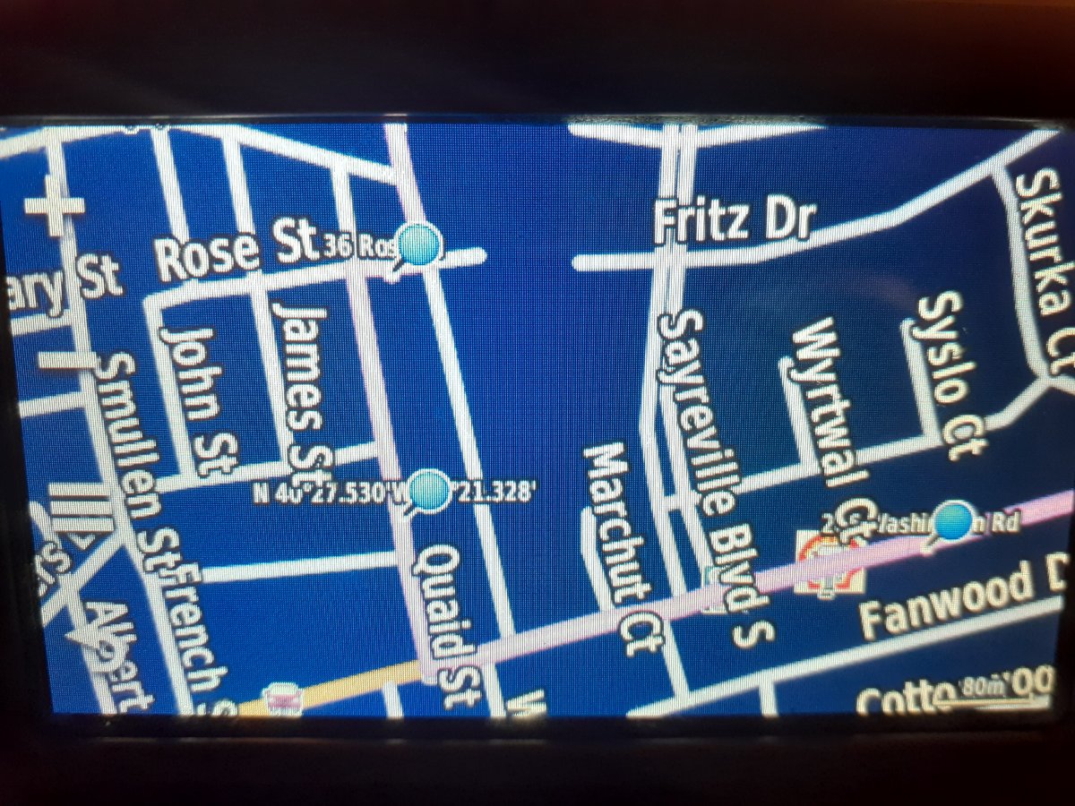

Before the reversal. As you can see it goes down the Quaid street which is a one way street

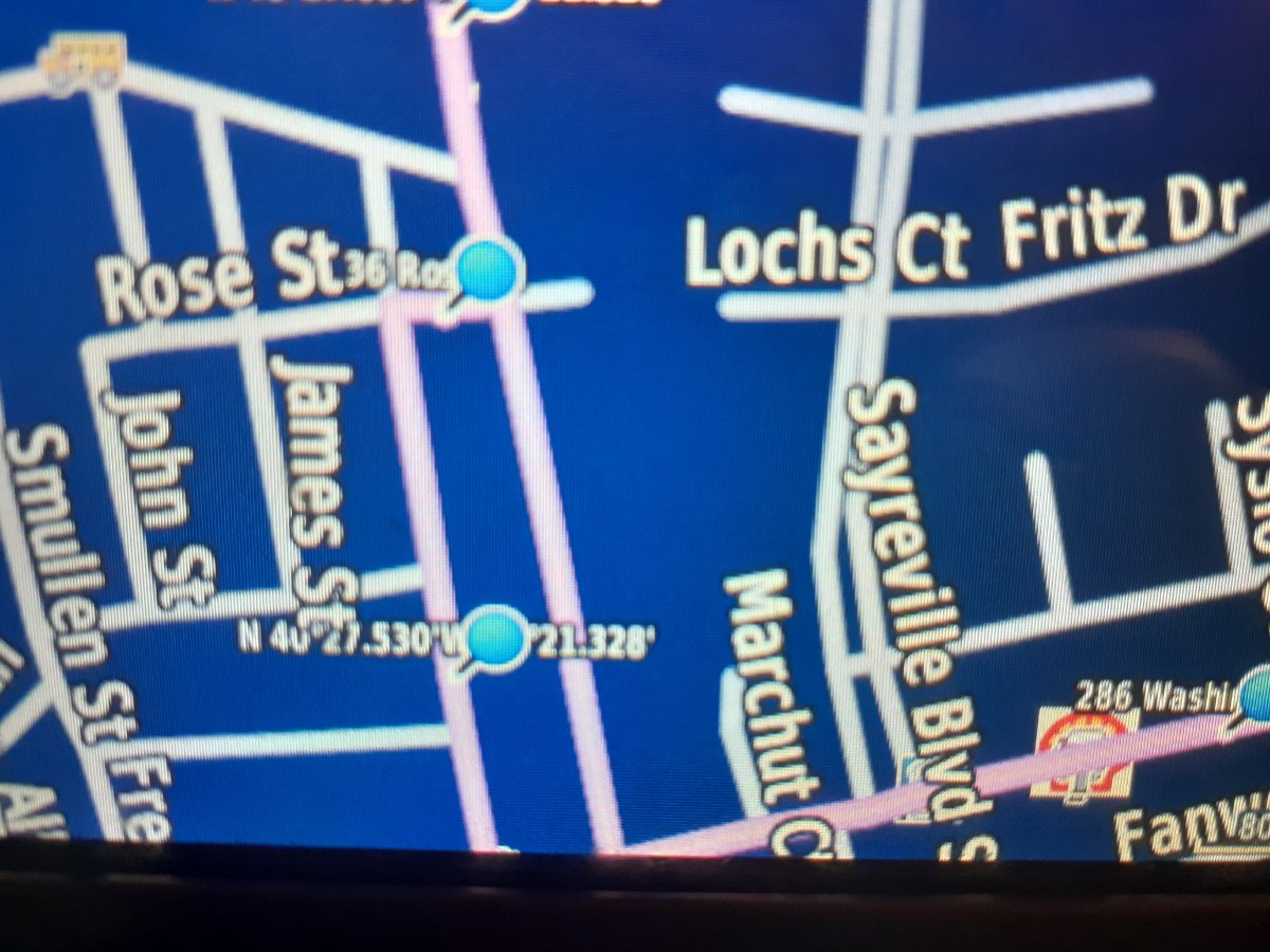

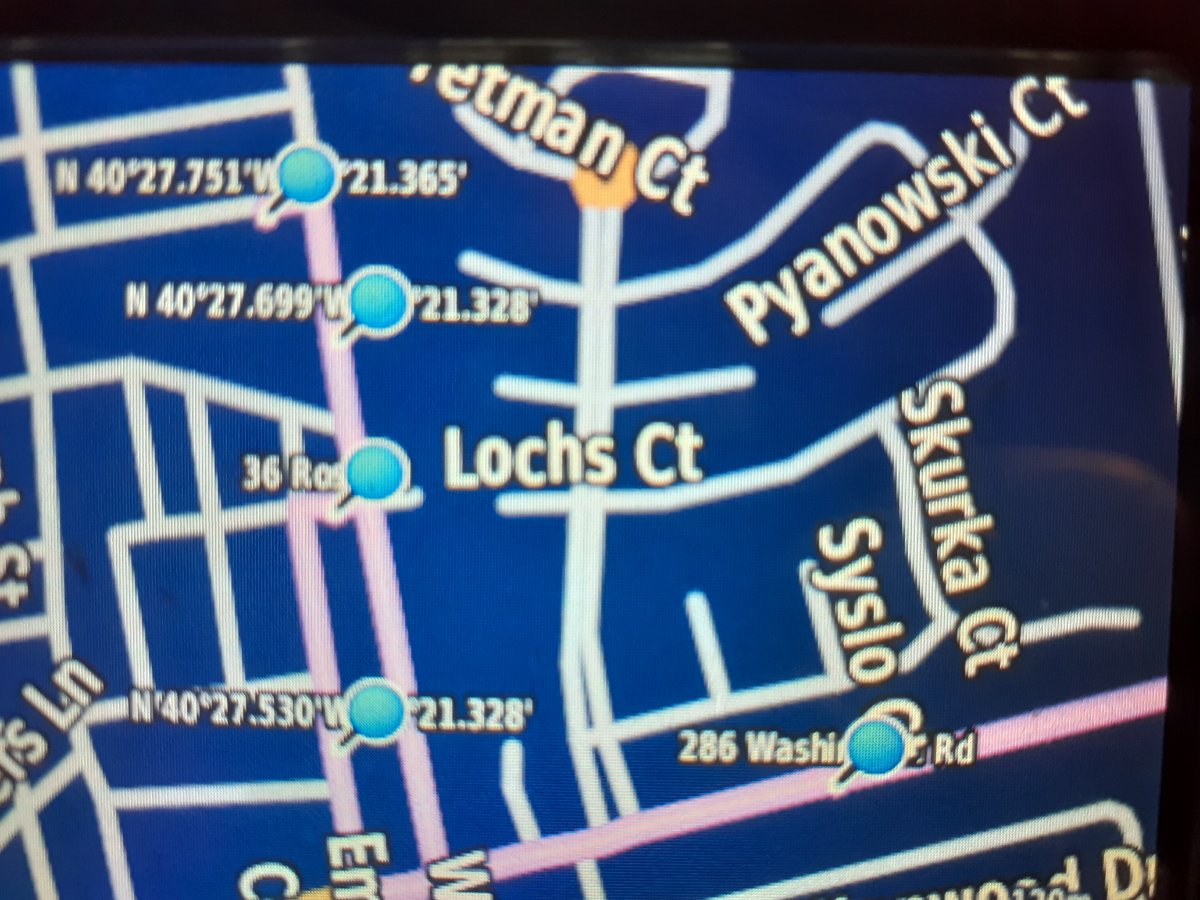

After I reversed the route, it led me down the next to the parallel to Quaid (Smith) street which goes the other way.
I'll ride there maybe tomorrow and see how it'll do on the ground

Looks like it made a loop to ensure it still visited the point in Quaid street, which is what I'd expect and shows the sort of issues you get.

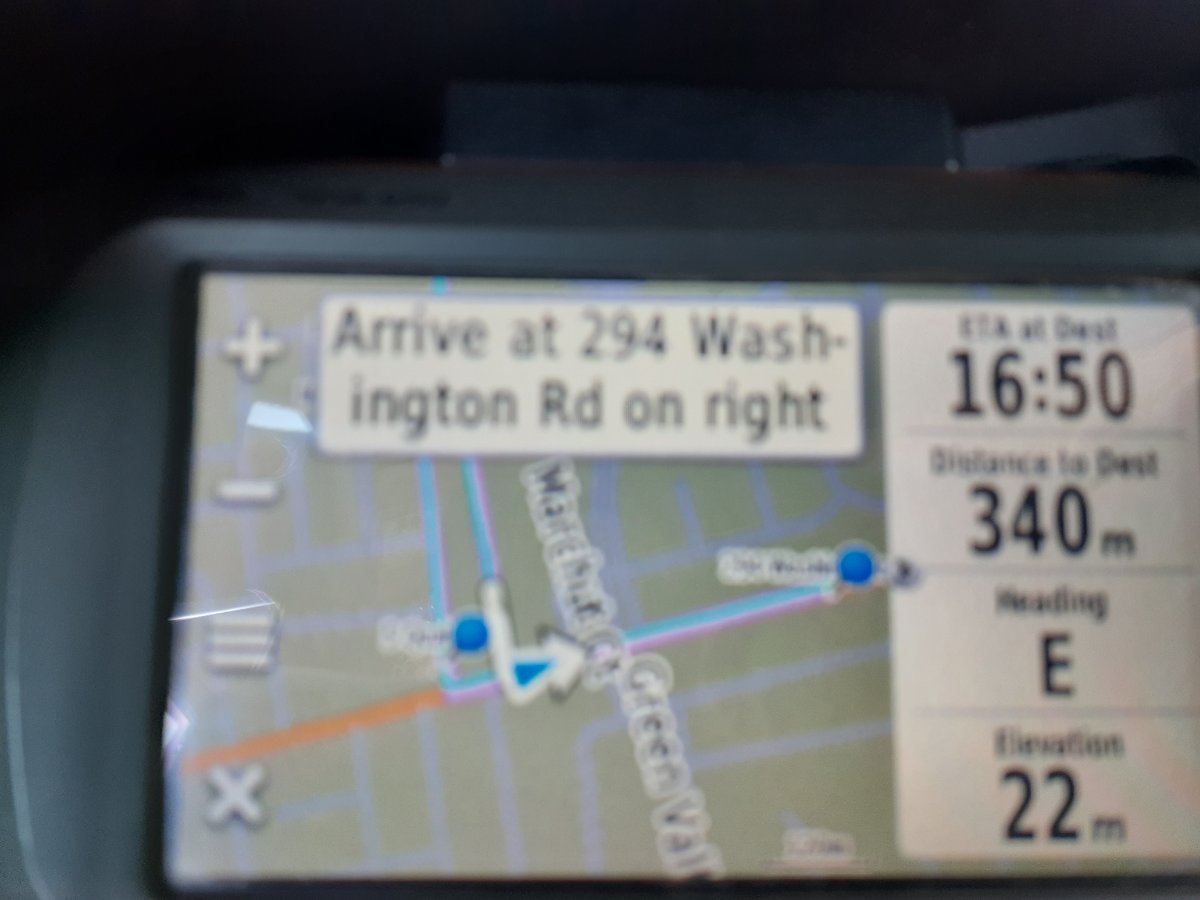

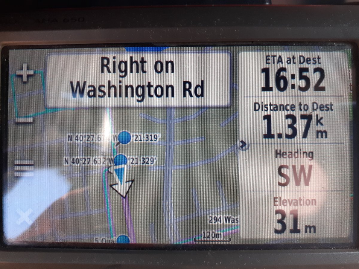

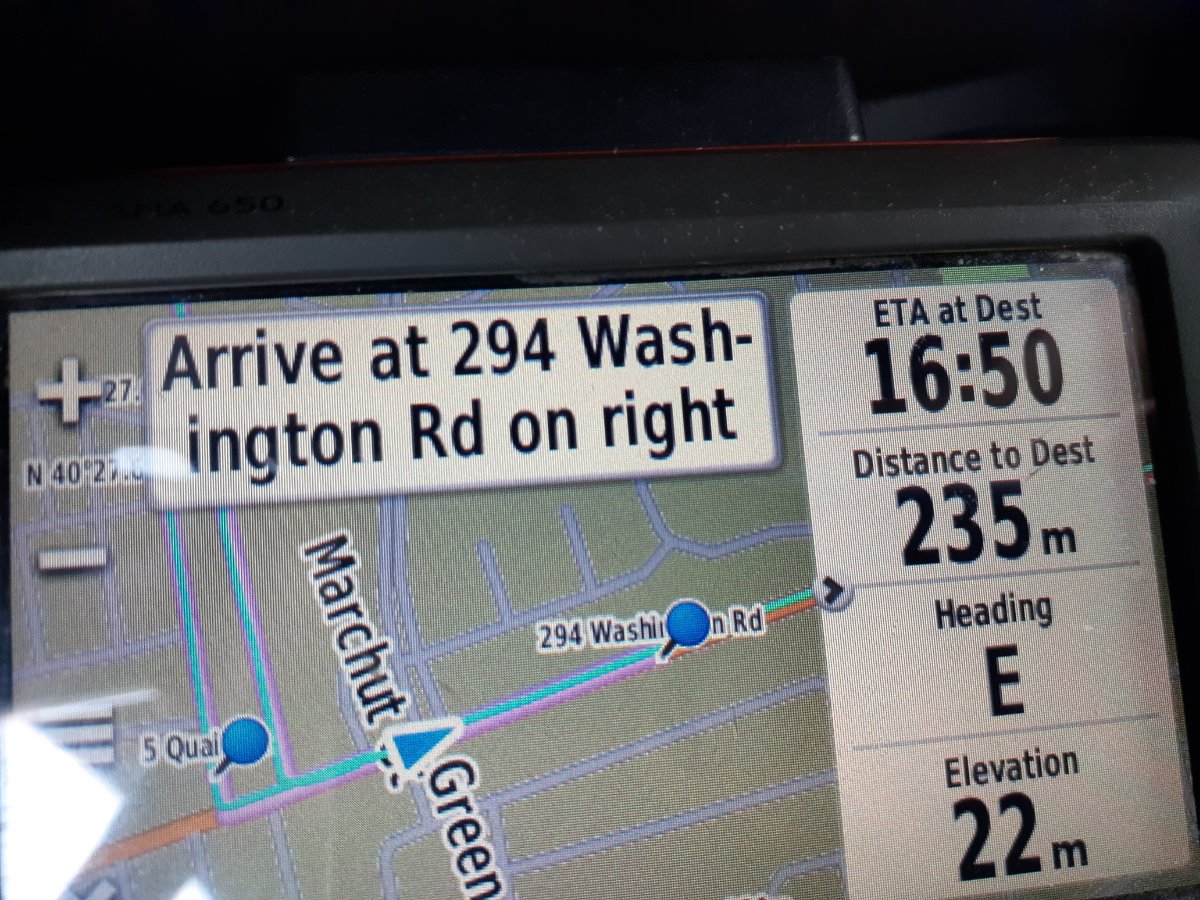

So I navigated this small route to the destination and then reversed it. It took me just the right way on Smith street.
Last pic to first. To be fair, it wanted me to make a right turn on Washington and back to 5 Quaid st, but knowing that it's the "old" route I made right and it continued to navigate. So, if the shaping point, say, on the opposite side of the road, you still can knowingly ignore it and it will continue navigating. Not perfect,yet something we don't have in Zumo.
What I also like about Montana 660 is that if you wanted to save a place to go back to, you just take a picture of something up there, and later just click on it and the nav will take you back there. Yeah, you can save a location in Zumo too, but the pic can remind you of how it looks like too. Not a big deal, just nice feature.
