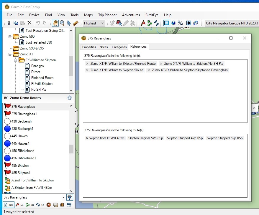

In the mean time - regarding finding routes / waypoints in lists within Basecamp.
If you double click a waypoint or route or right click and selecte properties - to open up the properties dialogue box, and then click the 'References' tab - you get an image like the one attached, listing all of the location that point is used.
You can then click on the item to display the list or the item or click the cross to remove the item (effectively delete the entry at that location). It doesn't delete the point or route completely. This is a 'fully normalised database' to use the jargon - it doesn't store more than one copy. But you can have as many pointers to it as you wish. So in effect, if you change the name of one of them, it changes all of them.
Until you delete the very last occurrence. Then the item is removed from the database.
See the pic - click it to get the full size version.

Re: Is there a way to search a Basecamp Library?
That's useful. Thanks!jfheath wrote: Fri Dec 30, 2022 1:46 pm
