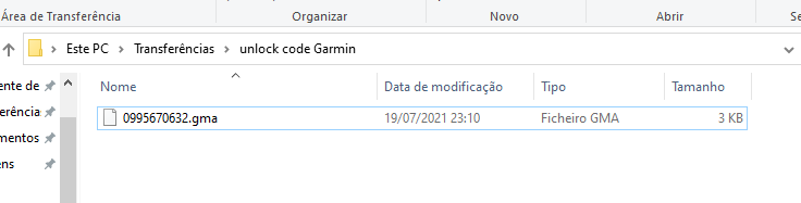

This is the .gma file I copyed from XT and then imported to PC with JaVaWa GMTK:
folder with gma file from XT
code XT.PNG (13.48 KiB) Viewed 5199 times
I notice the date says 19/07/2021 and the file doesn't starts with a letter D ????
Is it possible that the problem is within the Zumo XT that somehow the code is wrong?
Maybe some problem on the instalation and that's why it cannot transfer the map and unlock codes properly to the PC and Basecamp?

Not sure if the filename needs to start with D. But the file date is suspicious. If the map on your Xt is not correct, it would explain.
3 remarks/questions I have
- Did you try to install that gma with JavaWa GMTK?
- What does the Xt say when you look in Navigation/MyMaps?
- You can try to reinstall the map to your Xt and see if it make a difference

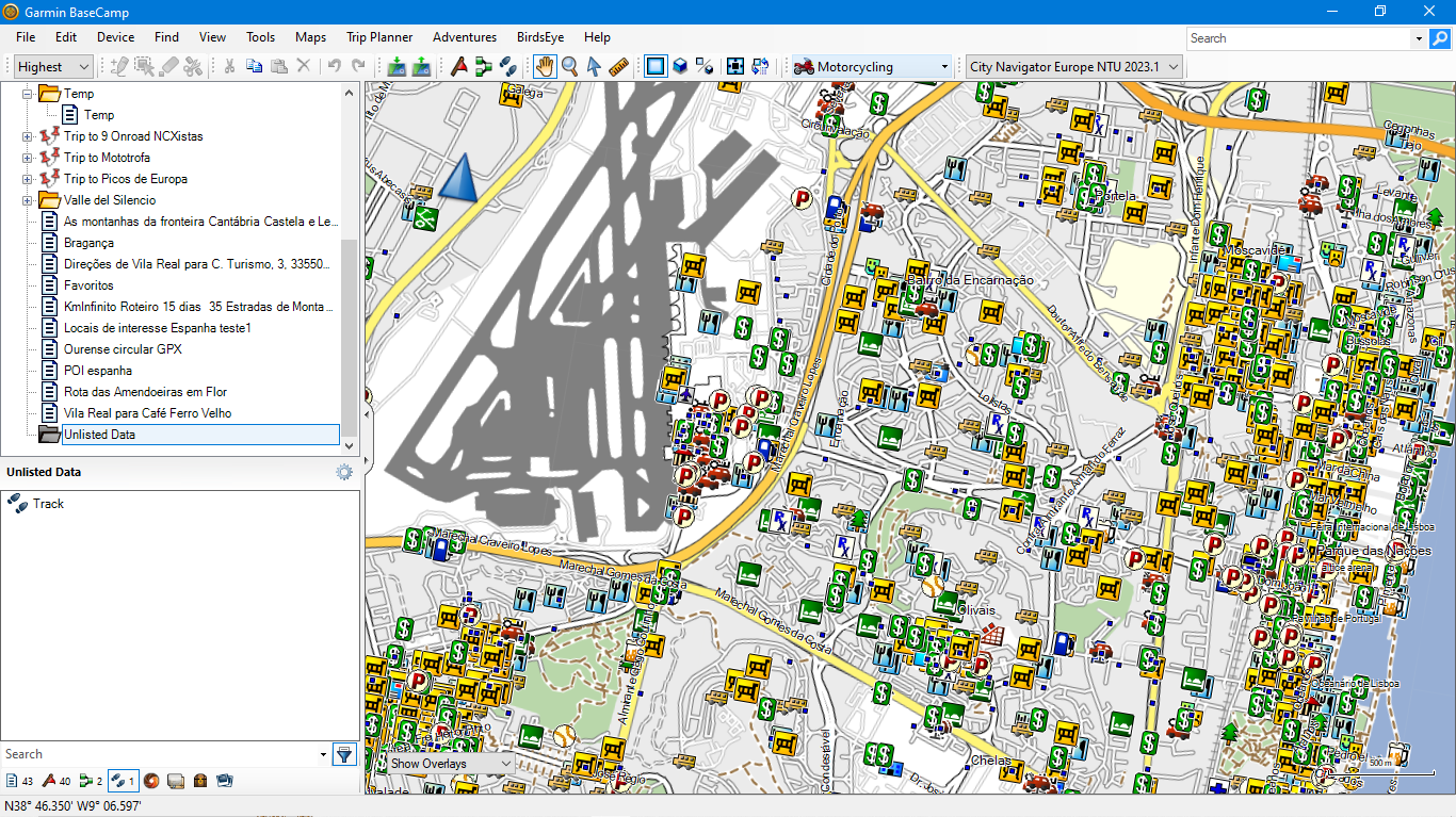

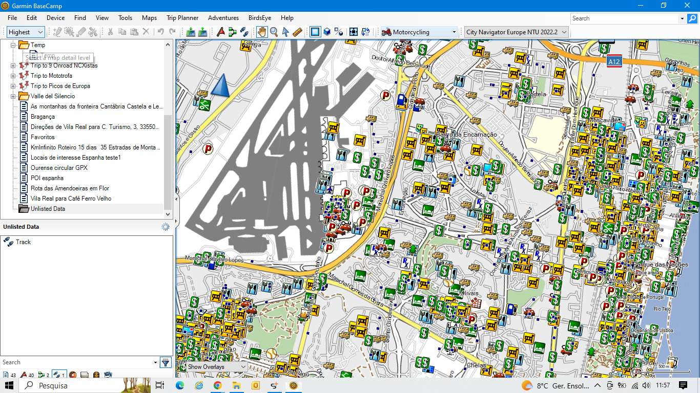

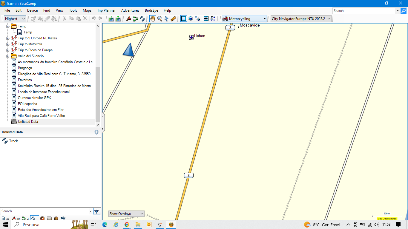

@sussamb the 2023.2 map shows Unlocked or Unauthenticated on Basecamp and has no detail. Only shows main roads like highways and a dot on cities, no streets or POI.
The maps that have full detail are 2022.2 and 2023.1 that I previous installed on PC Basecamp without any problems.
Bellow are screenshots of the same area (Lisbon airport) with the same zoom level on each map:
Europe 2022.2 at 500m zoom
Europe 2022.2
Europe 2022.2
Europe 2022.2.PNG (1.16 MiB) Viewed 5196 times
Europe 2023.1 at 500m zoom
Europe 2023.1
Europe 2023.1
Europe 2023.1.PNG (1.14 MiB) Viewed 5196 times
Europe 2023.2 at 500m zoom ("map detail locked" yellow message on bottom right corner)
Europe 2023.2
Europe 2023.2
Europe 2023.2.PNG (203.98 KiB) Viewed 5196 times
Re: Europe NTU 2023.20 map locked on Basecamp
Ah ok. Your screenshot earlier seemed to have all the detail I'd expect but it was zoomed out further. Such an issue is normally fixed by uninstalling the map then reinstalling it, as you appear to have tried that then hopefully Garmin can help by providing the correct gma file

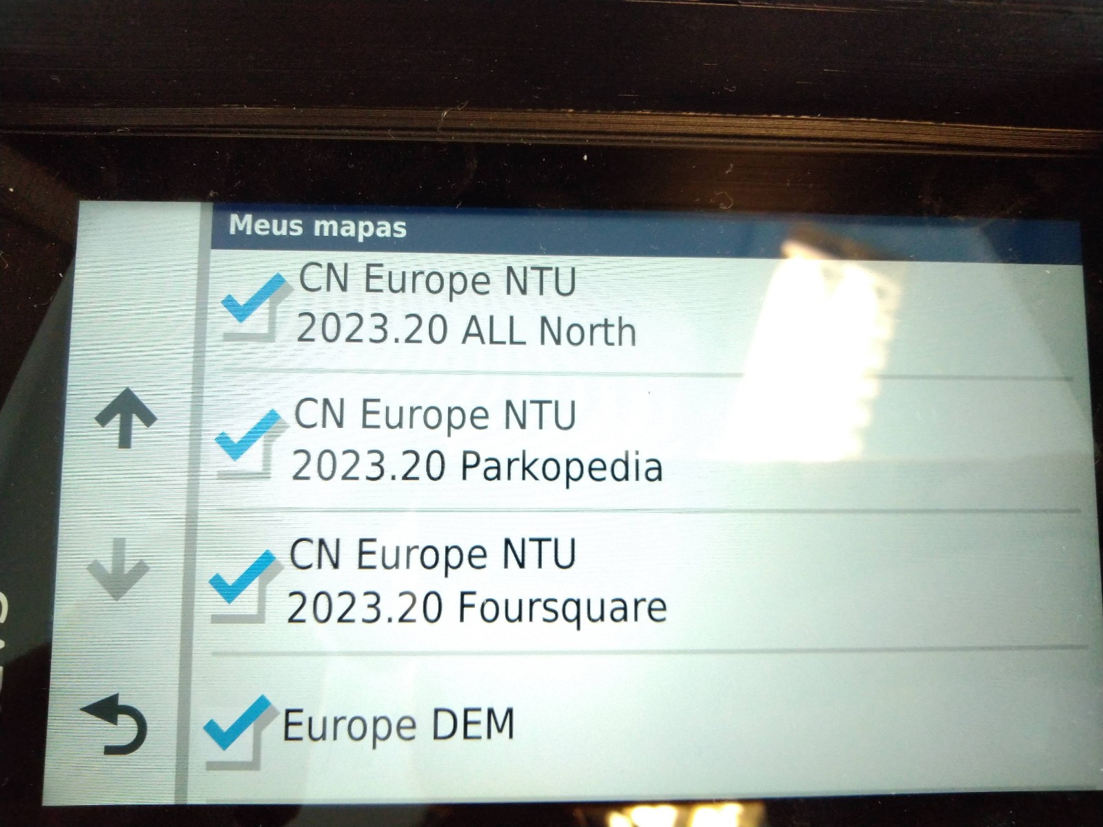

Hi @FrankB
- I installed the .gma file following your instructions on JaVaWa GMTK. I got a message "The unlock codes were imported"

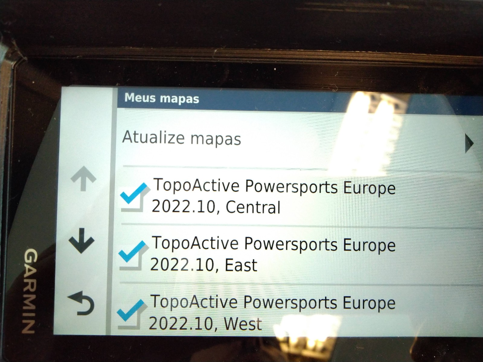

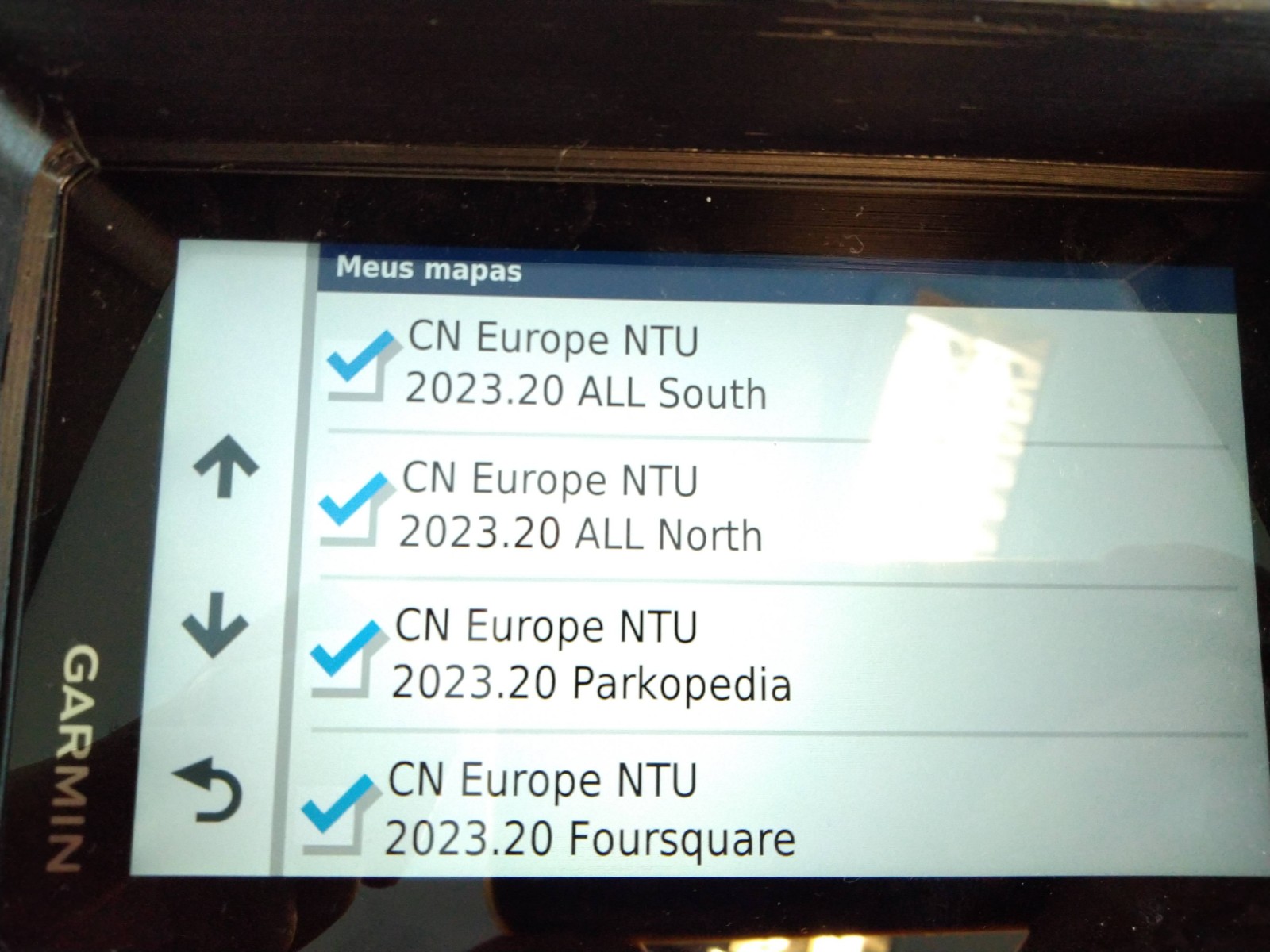

- See bellow these photos from XT My Maps:
Zumo XT My Maps 1.jpg (344.96 KiB) Viewed 5194 times
Zumo XT My Maps 2.jpg (260.16 KiB) Viewed 5194 times
Zumo XT My Maps 3.jpg (342.98 KiB) Viewed 5194 times

The maps on the Xt look good. But what I dont understand. I think you should have 2 GMA files. At least I have 2 GMA files and have the same maps as you.

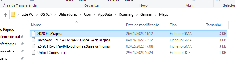

The .gma file highlighted in blue is the one sent by Garmin Support. It's still on the folder but the map remains locked.
But there are another two .gma files in this folder. The ones with a long name...
And an .ucx file too.

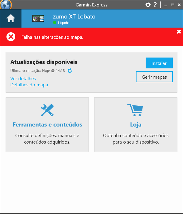

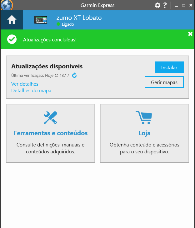

I reinstalled the map on Zumo XT. Everything went ok:
Zumo XT map reinstall.PNG (48.97 KiB) Viewed 5183 times

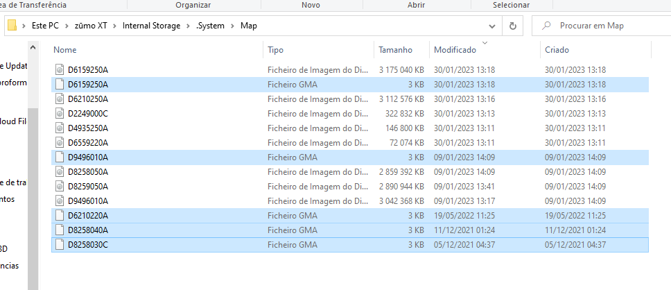

I then went to Zumo XT folder to check his .gma files and found all these 5 including a new one dated today:
codes XT.PNG (54.56 KiB) Viewed 5183 times
I might try to import these again to PC usisng JaVaWa GMTK. What do you think?
In that case should I copy all these 5 .gma files or only the most recent one?
