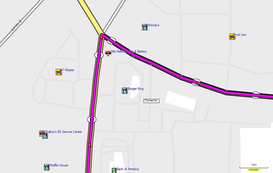

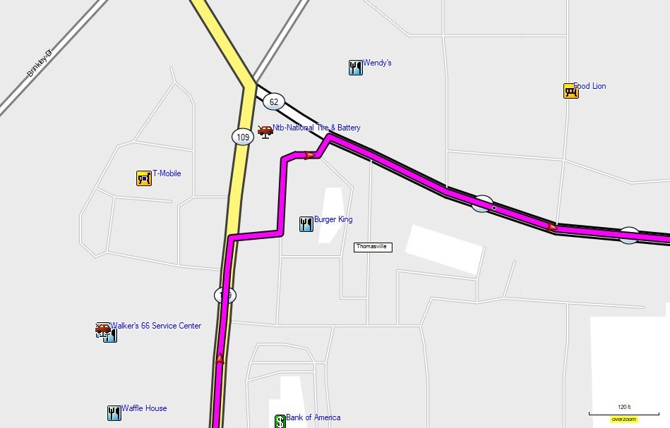

Getting back to Alleys. Here's a comparison of the same route segment. Shorter and Faster routing preference.
My big complaint here is that routing NEVER used alleys, or paking lot pathways before I installed CNNA 2024.10 - up from 2022.3

Just want to point out that the images I posted above are from my PC, not from the gps. This is how the routing software is planning the route and then the gps is following the path. The routing software didn’t do this with my previous maps.
