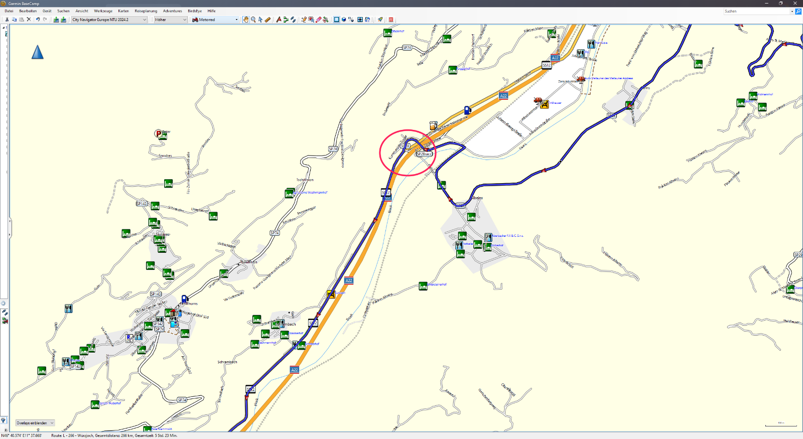

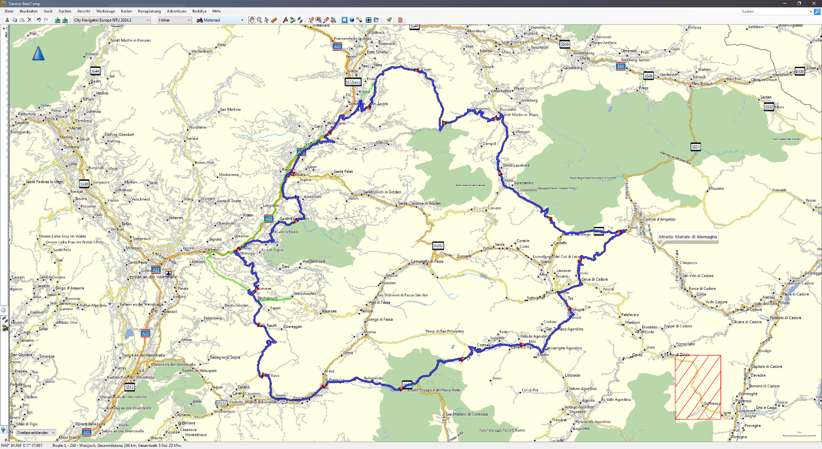

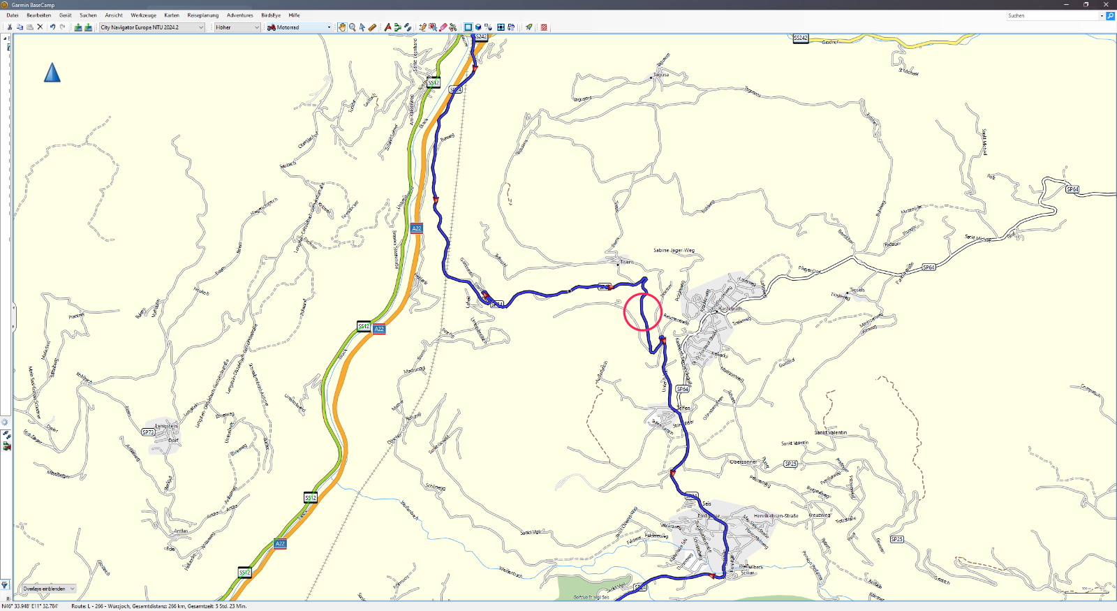

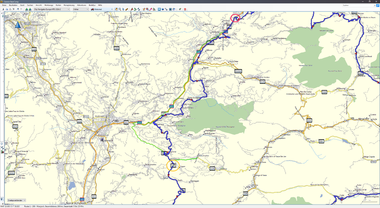

In my example from 2021, that i've posted above, there wasn't any via- or waypoint in the pre-planned route, only shaping-points and i got the same stupid zig-zag course with an extra of around 100km(!) after such a road-closed-rerouting....
This was the pre-planned route (blue) and my driven track (green)
Red marker shows the place, where the re-routing occurs

Red marker shows the (not really) closed road

And again - red marker where the re-routing starts, orange marker our hotel...
