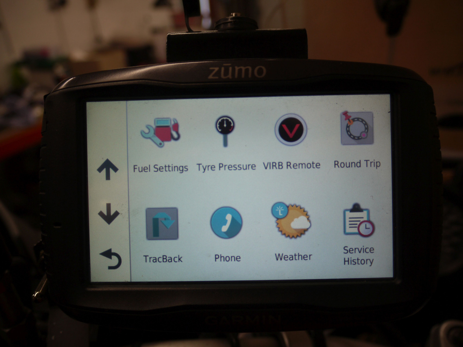

I'll attach what are, hopefully, informative pictures. The 595 is paired with the Cardo as a second phone.
1 - 4 show the 595 settings
Hopefully the lables in the subsequent photos are self explanatory.
Thank you Richard
Re: Loss of 595 active phone call panel
Posted: Tue Oct 29, 2024 3:34 pm
Hi
I have been trying and cannot get the 595 to behave like yours does.
The phone call should come through whether or not SmartPhone Link is set up.
It might be worth disabling that on your phone I appreciate that it takes a while to get all of the permissions set up again. Maybe you can force Smartphone Link to Stop - on the phone. On an Android this can be done by using Settings->Apps->Smartphone Link - Force Stop. I don't know about an Apple phone.
I wondered if it was perhaps one of the notifications that SmartphoneLink allows/disallows to the phone. Maybe somehow that was intercepting the incoming call and then not allowing it to be passed to the 595 ? This is sheer guesswork, but since I have not seen the problem when smarphone linke is enabled, doing this makes no difference on my 595. Or - you could turn off Smartphone Link on the 595 itself:
Settings->Bluetooth->Your Phone Name->Untick Smartphone Link.
If the phone is dialling out, you don't get the green / red box. Just a box which has 4 boxes and a red button like the bottom photo.
I've never seen the play message box. It says that caller Id is not recognised - and that comes from Smartphone Link.
I wonder if it is to do with permissions for the 595 to access your phone book and call history. My Android phone has Smartphone LInk permissions to access Contacts, Files and Media, Location, NErby devices. Everything, in fact. IT is also has 'Remove permissions and Free up Space' under 'Unused Apps' set to No. Otherwise you don't use it for a while and it deletes the permissions that you need to make it work.
Also of course, Notifications are allowed.
