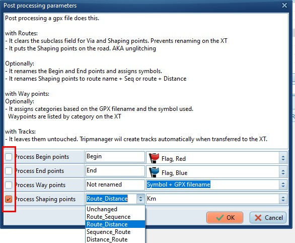

I am intrigued by the Post Processing feature, especially the ability to "unglitch" and put shaping points back on the road. I currently check every shaping point on every route before transferring routes to the XT. I can be time consuming.
Re: Introducing TripManager
Posted: Thu Jan 16, 2025 4:35 pm
by FrankB
Just give it a try, with a route/area you are familiar with. You only have to check 'Shaping points'. Optionally you can rename them to route + distance or sequence number.
Beware: Create a backup first, the program will overwrite the GPX file without any confirmation.

I gave it a quick try with a couple of shaping points off the main route, one announcing and one not. It seems to have thrown an error upon attempting import back into BaseCamp. The only thing I changed in the tool was the field showing km to miles for Processing Shaping Points. Not sure how that impacts things.
Posted: Thu Jan 16, 2025 5:56 pm
by FrankB
If you post the gpx, or send me a pm, I will look into it.

Uploaded version V1.1.0.114 that fixes the bug(s) reported by Tom: https://github.com/FrankBijnen/TripManager/releases
