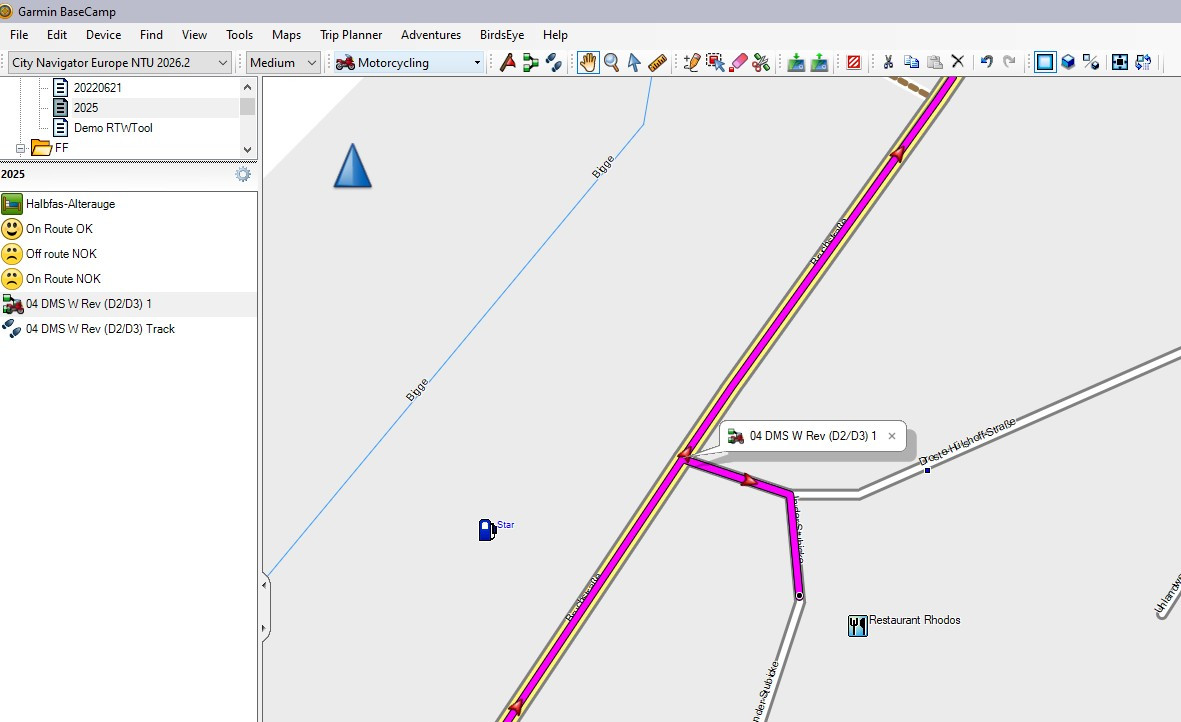

Before you spend a lot of time, please check all your via/shaping points for something like this.
This misplaced Shaping point was the cause for a CEP going terribly wrong.
This was the post back then. viewtopic.php?p=5794&hilit=glitch#p5794

proofresistant wrote: Fri Jul 25, 2025 12:07 am What exactly is wrong with this shaping point?
Well. In the 1st place I did not meant it to be there, it should have been place at the main road. Bruchstrasse. My fault I did not pay attention.
2nd When driving you need to turn right, make u-turn, turn right again, just to be on the same road.
3rd When starting the route from my current position with CEP it skipped nearly all shaping points and wanted me to take the Autobahn.
4th If the Shaping point is moved to the Bruchstrasse all is well.
Besides I dont like Pizza!
6 Route different from the original.png (639.86 KiB) Viewed 623 times
proofresistant wrote: Fri Jul 25, 2025 12:07 am Sorry, but this kind of software behavior is not acceptable, and it's certainly not a route planning error on the part of the user.
Agree 100%. But that's how it works. Just wanted to warn you about this behaviour.
In the original post there is a zip file with a GPX, and a few Waypoint from where the CEP was started (in simulator mode) I recently was able to reproduce the same problem, but now on the latest Firmware of the XT and the latest maps.
