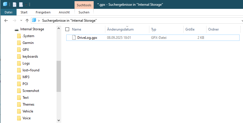

Dir *.gpx /s Unfortunately, that's no longer possible; it's now an MTP connection
And tracks are no longer imported automatically on the XT2 either.
And yes, after all GPX files have been deleted from the device, all tracks are back after restarting, even without Wi-Fi or Bluetooth pairing.
PNG-Bild (neu) (3).png (36.36 KiB) Viewed 340 times

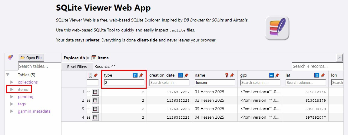

I did an experiment, admitted on an XT1, that shows that WayPoints and Tracks are stored in explore.db, when connected and syncing is allowed with Garmin Explore. For the XT2 things might be different. But if you want to look at the explore.db to answer the question "Where are tracks and waypoints stored in XT2 internally?" you can try this.
1. Copy Internal Storage\.System\SQLite\Explore.db to your hard-drive.
2. Open https://sqliteviewer.app in a browser
3. Click Open File and select Explore.db on your hard-drive
4. Select items
5. Filter on type (Type=1 are Waypoints, Type=2 are Tracks)
Updating explore.db, to remove things for an example, is another matter. sqliteviewer.app is only a viewer.

FrankB wrote: Wed Sep 10, 2025 6:07 am I did an experiment ...
@FrankB ,
Your reply came just before I wrote about my experience yesterday.
You're right, it's easy to read in the internal SQL Lite DBs.
The Device DBs are not as protected as I knew from others.
I first used the web version you mentioned.
That was a good start, thanks for the tip :!:
But then switched to a PortableApps version https://sqlitebrowser.org/.
I don't know yet whether you can also write with it; I haven't dared to try it yet.
First, I now have to download a backup of all databases to my PC, from the zumo XT2 and Tread 2 also and will compare them.
And what can I say, my urge to research grew enormously. It's really interesting what you can find in databases :ugeek:
In addition to Explore, the vehicle profiles are also particularly interesting.
Now I “just” have to understand the Explore DB first.
At first glance, I think there's even a copy of the trips included, but I haven't examined the data content enough yet.
Wow, it's all so time-consuming.

FrankB wrote: Wed Sep 10, 2025 6:07 am ...
... WayPoints and Tracks are stored in explore.db ...
I can now confirm @FrankB :ugeek:
The tracks and waypoints are stored in Explore.db :!:
In zumo XT2 and Tread 2 also, they are in the [items] table same as zumo XT (1).
(However, I have only tested this with Explore storage originally enabled, so I dont know yet what happens without the Explore storage option.)
