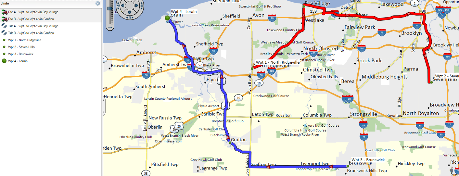

OK - here is a file and a visual explanation.
Its 10:00 UK time, so I've plenty of time to keep adding to this before Ohio wakes up ! I'll keep adding over the next half hour or so.
Jimio - Test Data - jfheath.gpx contains 2 routes.
Each route has two waypoints - saved locations which I have used to mark the start and the end of each route.
I've added a single Via point (not a waypoint) to some point in between the start and finish of each route.
The image below shos the screen capture from Basecamp. Click on the image to see it full size.
Route A (red) uses Wpt 1 and Wpt 2. Route B (blue) uses Wpt 3 and Wpt 4.
I have also created a track of each route. The left hand pane shows the two routes, two tracks and the four waypoints.
Not so obvious are the Via points which appear on the map as green discs. - one at Grafton (blue route B) , one at Bay Village (red route A).

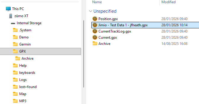

Transfer the gpx file to the XT1
All I have done here is exported all of the data - 4 waypoints, 2 routes, 2 tracks to a single gpx file - which is attached below.
I have then dragged the gpx file using Windows File Explorer to my XT1 Internal Storage/GPX folder.
The result is shown in the screenshot below - again click the image to see the dertail if you need to.
nb Position.gpx is a file that contains your last known location. It helps the Zumo start up more quickly as it knows wherebaout you are, so it knows where to look for the satellites. I note that you don't have this file, so in its current state, your XT1 has not been able to get a good satellite fix since you last deleted the files.
Archive contains previous recorded track logs. These are captured automatically, and are a useful record of where you have been. They can be turned off, but I find them a useful record of where I have been.
CurrentTrackLog.gpx contains the most recent record of your rides. Data from CurrentTrackLog is occasionally shifted into the files in the Archive folder. If you delete this or the Archive folder, you have lost your track logs. Older logs get deleted automatically so if you want to keep them, then every month or so, copy the archive folder and CurrentTrackLog.gpx to your computer.
Current.gpx contains data that is in internal storage - old routes, tracks, waypoints. You can clear out old data that you don't need by deleting this - but you have to do things in a certain order, otherwise, they come back. More details on all of this I have described in this chapter of pages starting here. app.php/ZXT-P23
