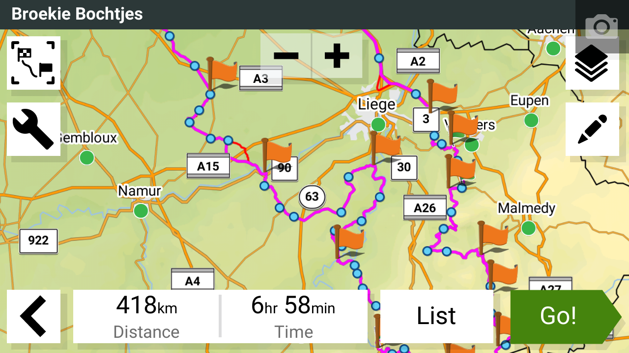

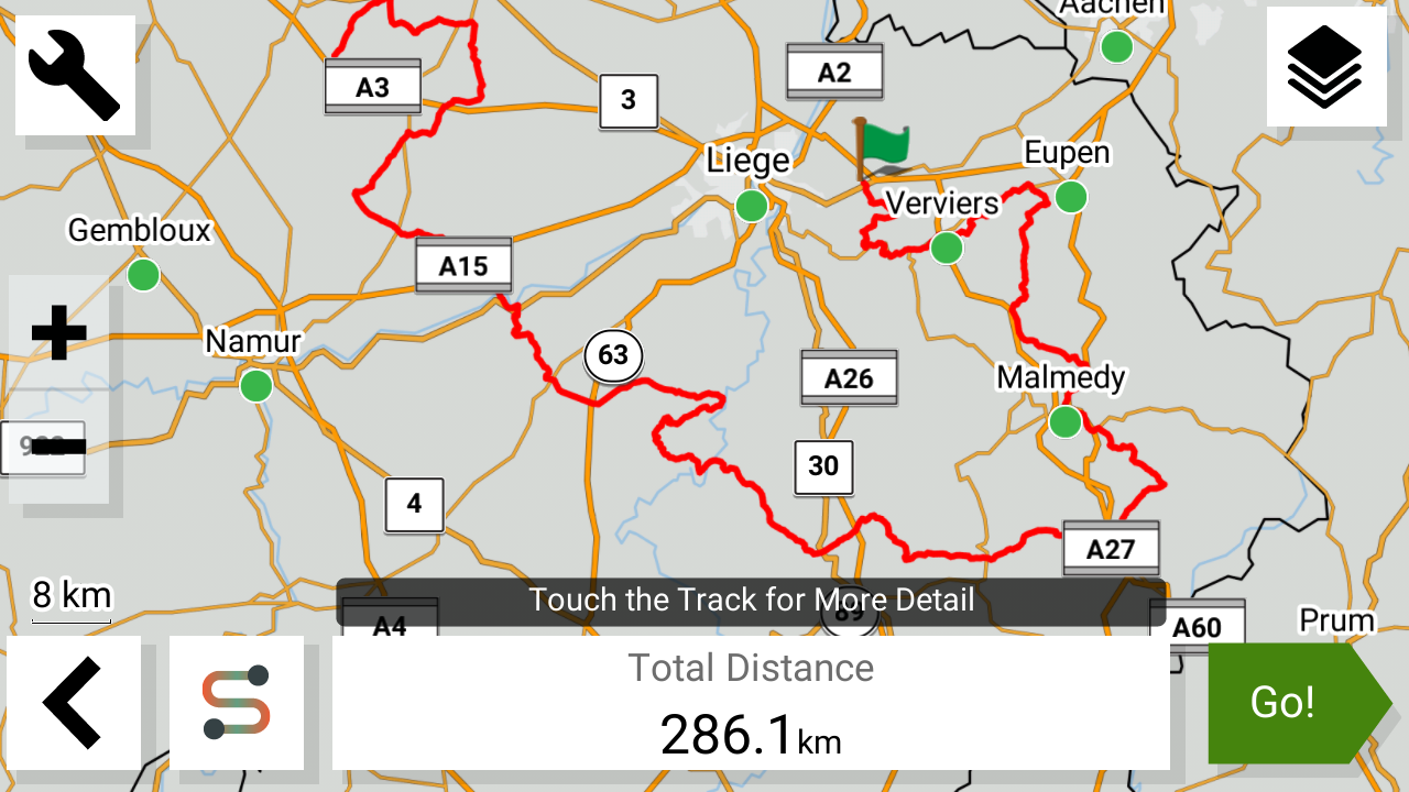

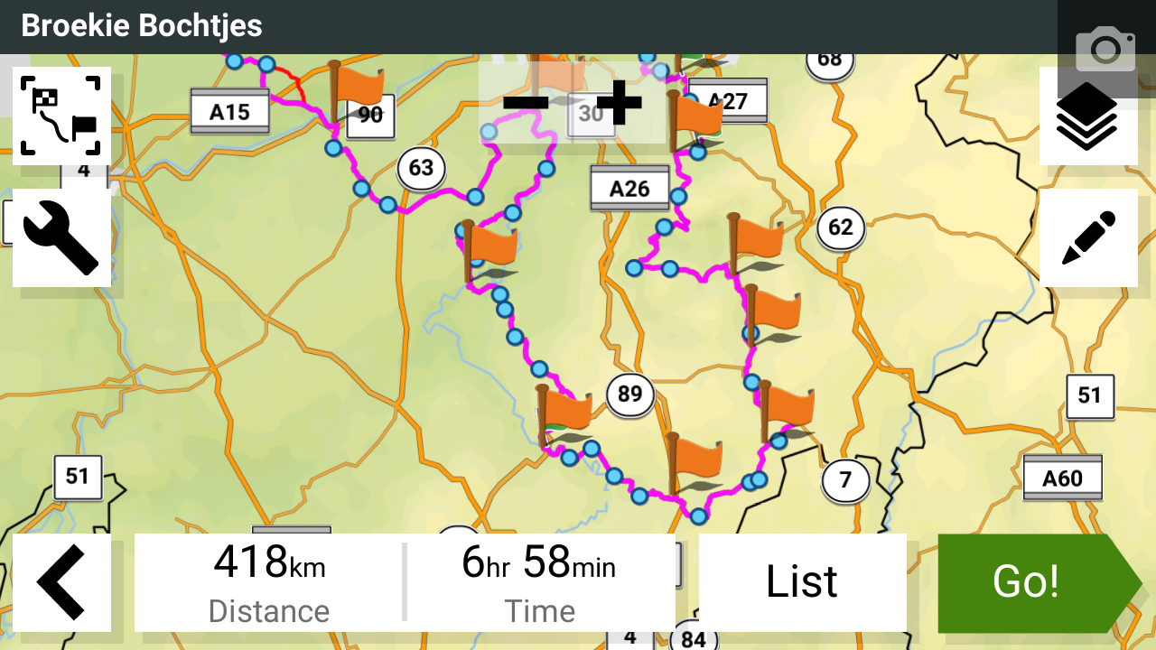

Example 1
GPX v1.1 (route, track POI) "broekie Bochtjes.gpx
note: built on HERE map using MyRouteApp, checked with basecamp
Collection: Test Garmin 1
Route on MyRoutePlanner:
Screenshot 2025-12-31 152600.png (1.79 MiB) Viewed 432 times
Track imported trough USB/SD, tread sync disabled:
Route imported trough USB/SD, tread sync disabled:
Route imports with 99% match to the original GPX.
Minor differences such as road closures and XT2's algorithm.
Shaping and Via points succesfully imported, acceptable result

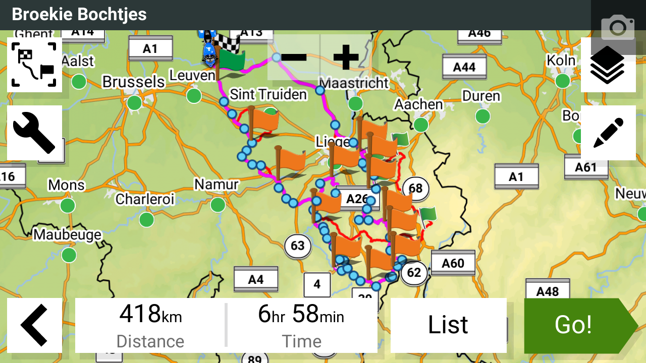

Route imported trough Garmin Tread synced:
Route corrupted.
Route will either corrupt or severely change post sync.

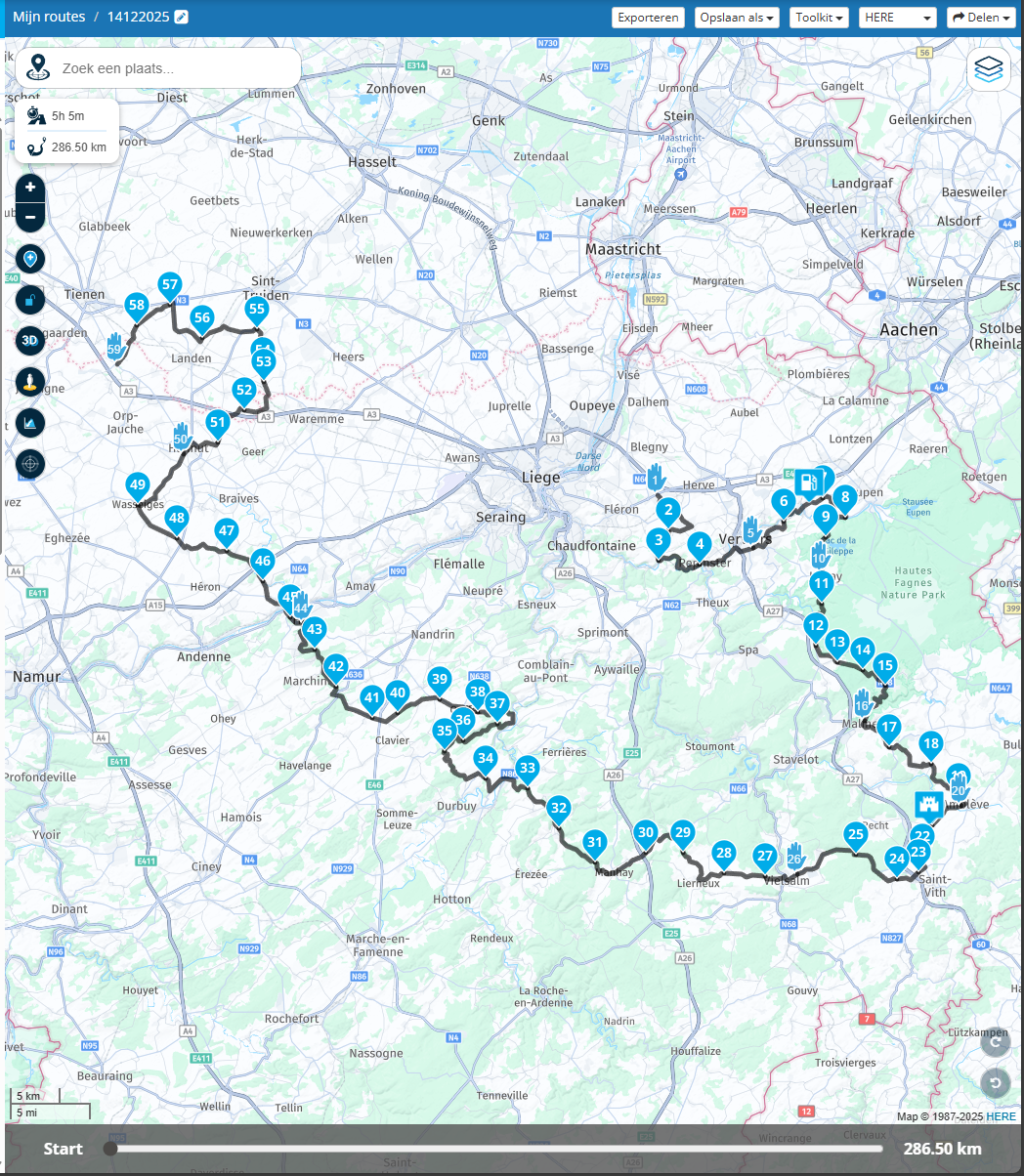

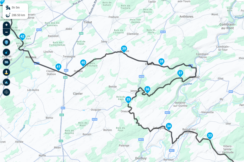

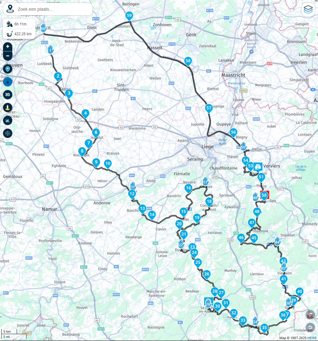

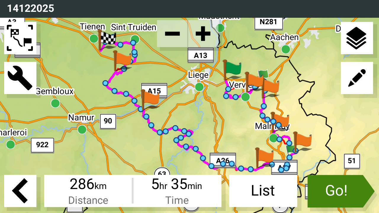

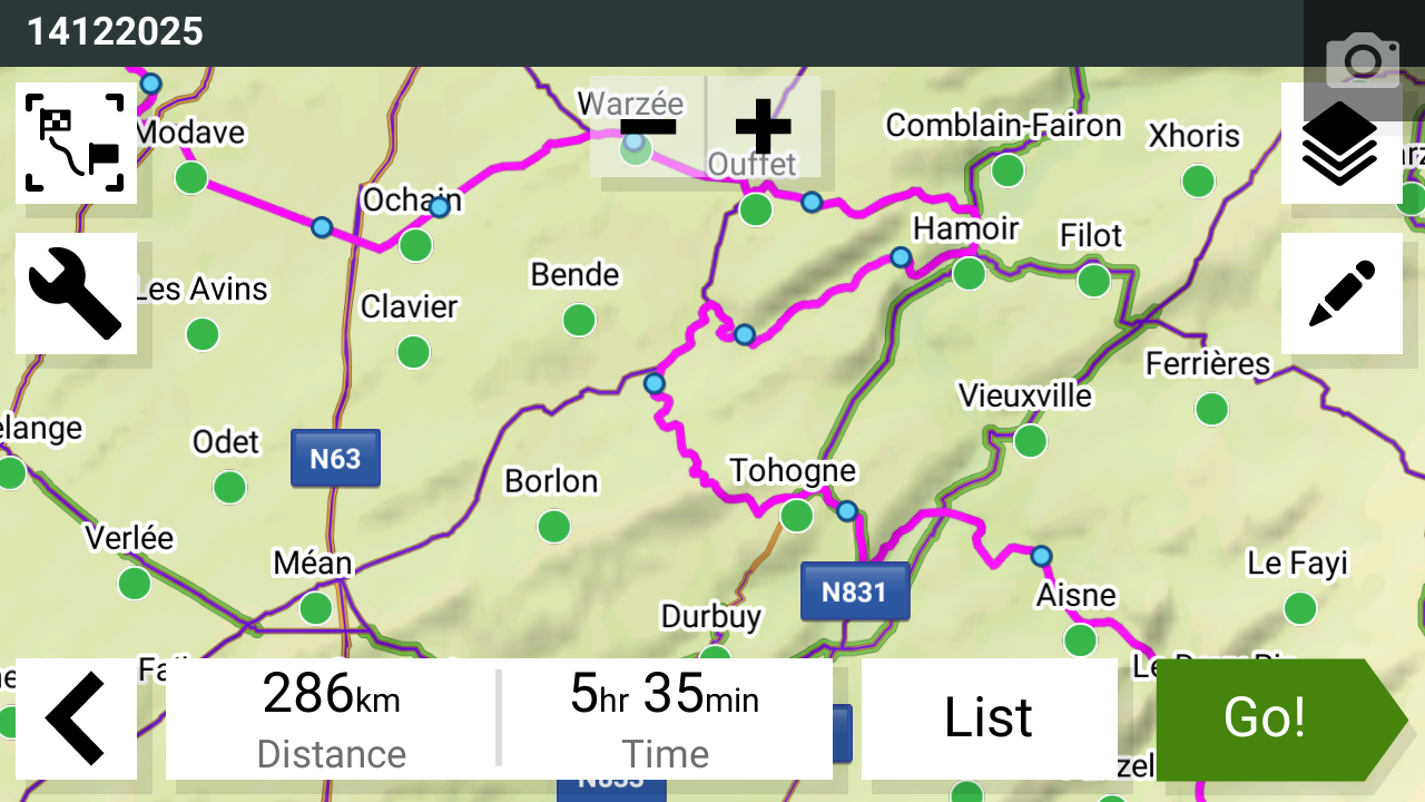

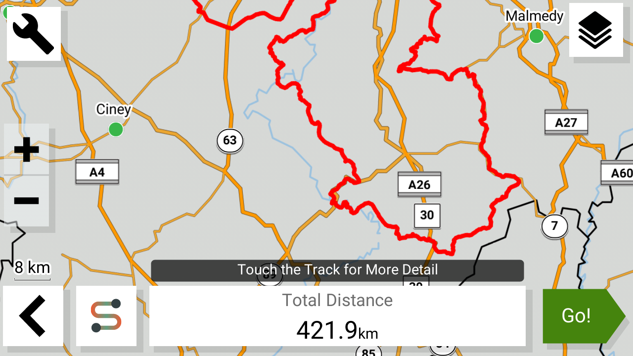

Example 2
GPX v1.1 (route, track POI) "14122025.gpx
Collection: Test Garmin 2
Screenshot 2025-12-31 141826.png (1.88 MiB) Viewed 432 times
Screenshot 2025-12-31 141915.png (846.96 KiB) Viewed 432 times

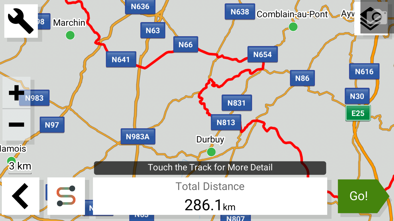

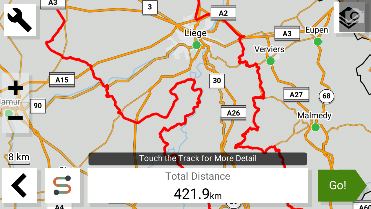

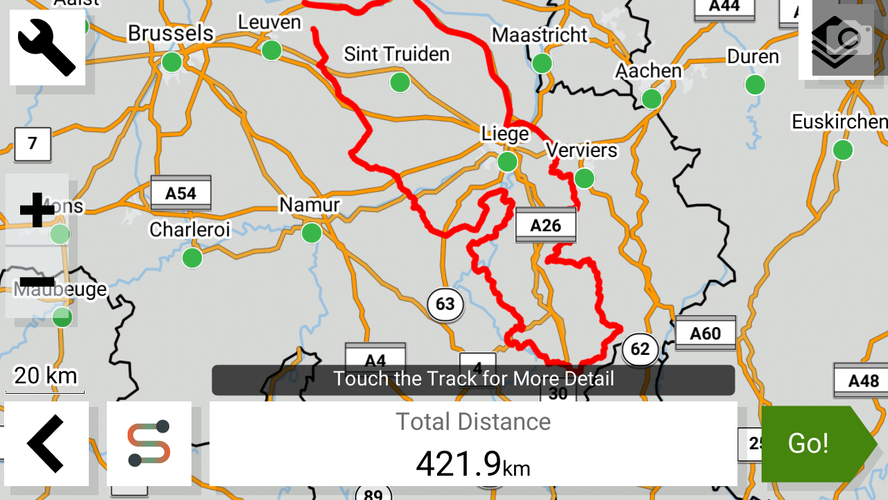

Picture of behavior when route is not corrupted, but severely changed by Tread sync's algorithm:
As you can see, the issue lays within Garmin's Cloud sync, destroying users GPX files.
This issue is easily reproduced by importing premade GPX files trough the Garmin Tread app (Bluetooth).
Imported GPX files loaded trough SD or USB work perfectly, until Tread Sync is enabled.
Then those same GPX files get uploaded to the cloud, and destroyed in the process.

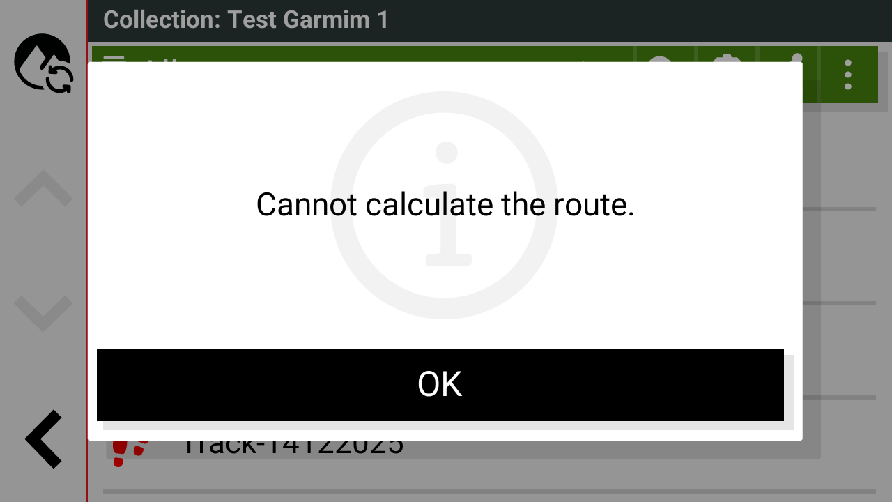

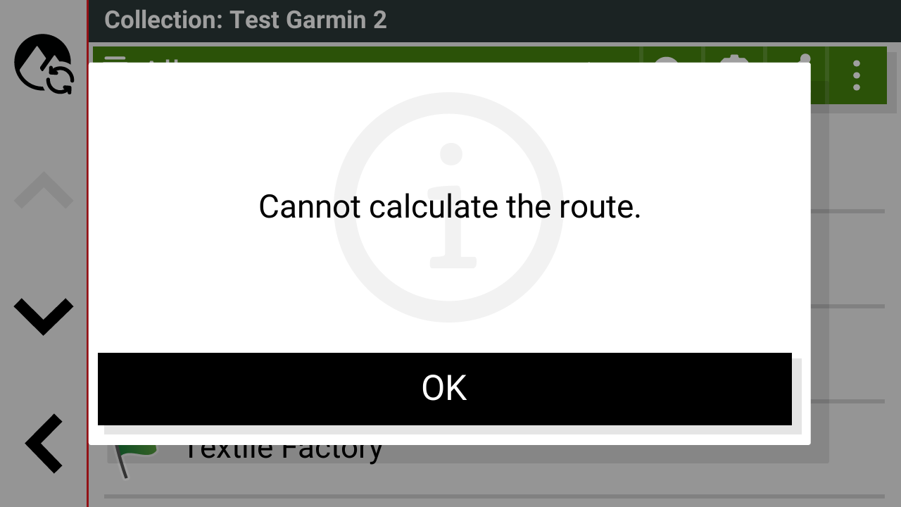

i've just received the following reply from Garmin.
Hello Lansa,
I managed to duplicate your report using City Navigator EU NTU 2026.20. After updating to the latest, 2026.30 the route matched the original with exception to a few turns. These turns were corrected by adding a shaping point (https://support.garmin.com/en-US/?faq=1 ... tab=topics).
Our devices need the latest mapping to sync correctly with Tread app as well. Please try the following and respond with the results. Again, what you're experiencing is possible since the routes were created from another software.
Delete the imported data stored from Broekie_Bochtjes.GPX on the Tread app and zumo XT2
Update the maps on your zumo XT2 to CN EU 2026.30 (You can use Wi-Fi or Garmin Express to update)
Upload the data from Broekie_Bochtjes.GPX again to a new collection
Allow the Tread app to calculate the route
Find the route imported to the Tread app
Select "Edit route" via Tread app
Wait for the Tread app to finish calculating the route
Confirm the route matches the original before saving
Allow the zumo XT2 and Tread app to sync
Confirm the route is correct on the zumo XT2
The "cannot calculate route" error was resolve doing the same as well.
