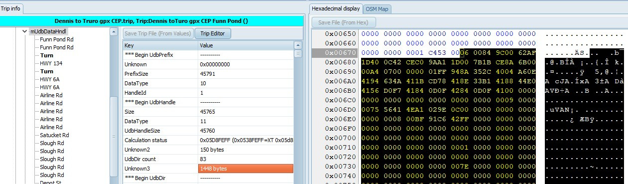

Maybe I'm not saying anything new to you, maybe it helps. Would love to check it myself, but you know I'm too gready to spend 500 Euro's on an XT2.
If I remember well we looked at the item 'mAvoidancesChangedTimeAtSave'. That item contains a Unix like date-time in 4 bytes. We started with putting in all zeroes, that had no effect. Next it was changed to put in the current date/time, same result.
What you could try, if not already tested, is to take the value from an already (re)calculated trip by the XT2 and put that in a trip file generated by TM. You could use the function 'Copy value from trip file'. The one you used when you found the 'mExploreUuid'.
If that works we can see how to change TM.
Another test you could do:
1. Remember the value 'mAvoidancesChangedTimeAtSave' of a calculated trip file. (Make a screenshot or similar)
2. On the XT2 change the avoidances. (Really have no idea how that looks on the XT2)
3. Recalculate the trip, and check if that value has changed. If it did not change, you/we are probably looking at the wrong item.
Dont hesitate to contact me if I can help. At your service!

Re: Introducing TripManager
Thanks Frank
I'll revisit that - I remember trying all sorts of things with them without success and gave up as I reckoned that the route has got to be calculated anyway - and how different is it going to be when it recalculates it again ?
But I'm pretty sure that I didn't carry out the last test - which was to get a snapshot, change the avoidance get another and see what has changed - and then put that into a TM created trip. I did something similar, but I don't think it was that. I'll check my notes though - But I'm well aware that I gave up with it around that point and realised that it didn't matter a great deal. We were just happy that we'd found a couple of UUIDs that made it work for the XT2. I probably quit while I was ahead !
