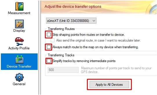

Skipping a Via Point definitely does not remove the shaping points - but I think I know what it is that you are seeing.
There is an option in Basecamp which you need to set :
Edit -> Options -> Device Transfer
Untick all of the checkboxes. Then select 'Apply to All Devices'.
If you don't do this (some are set by default when Basecamp is installed), then when you transfer the route to the Zumo, it only transfers the Via Points. It doesn't transfer the shaping points. The route is held in place by the ghost points. But if you ever allow the Zumo to recalculate the route, it only has the Via Points to work with. And it calculates a route just using the Via Points. So probably htis is the first time that you notice that the shaping points are not there. I'm pretty sure if this is what is happening, the shaping points will not have been there in the first place. You just never noticed, because the route was going through the locations where you had shaping points.
Check your route in the Trip Planner App. The shaping points are shown as blue discs on the map and in the Trip Planner list of points. I think you may find that they were never there in the first place.

What I found on a 340-ish mile ride yesterday:
- regarding skipping a point,
1) all the points except the start & destination in my route are shaping points. This works beautifully with the 595 for which my routes were originally made. When I went off route and manually skipped a point, the XT routed me directly to my destination instead of using the remaining shaping points. I had to stop then restart the route but without any via points to go to the XT was a bit confused the first time. Stopped and restarted again when I got back onto the route and it did ok.
2) I have always had the boxes in the Transfer Mode Options unticked. For some reason the maps one is now. I unticked it.
3) I use Prompt to recalculate. Most of the time I say no b/c I'm just a little way off my route for fuel and eats. The option to NOT recalculate the entire route when skipping a point does not seem available.
