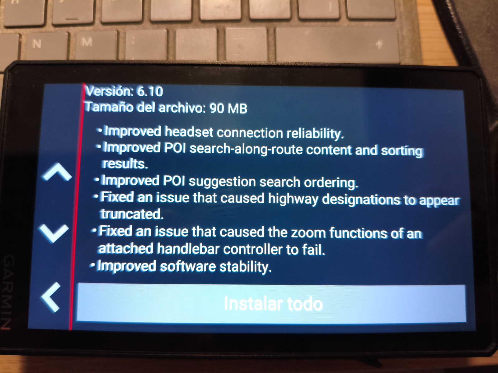

I hope they fixed the controller and headphone connection issues. They were very annoying.

They've finally fixed the remote zoom issue. Now it works perfectly with all features.
Could someone confirm if the personal POIs (speed cameras, lighthouses, castles, etc.) that I've added are now only audible? I go into the lists and the image isn't visible. Speed cameras pop up (I can hear them) but they're not visible on the map.
2 steps forward and 1 step back... :lol:
I have a test tour guide set up each with its own sound file and each with its own picture and icon.
I've just update the system software to v6.10 and loaded up the POI.
The pictures are showing up at the right of the screen, the correct sound file is playing at the right distance, but at present, none of the points are showing up on the screen. They used to, (3 days ago on the XT2) and up ahead places is selected.
Regarding the sound - Settings->Driver Assistance->Proximity Alerts->Audio / Alerts / Tour Guide (my collection of POIs)
In alerts, you can turn on or off the alert sound for your Custom POIs.
Just got to find where my points have disappeared to. Not for tonight.

They've changed some of these Garmin POIs in the latest 6.10 update, and the custom POI images aren't showing. We'll have to wait for the next version of the XT2.
