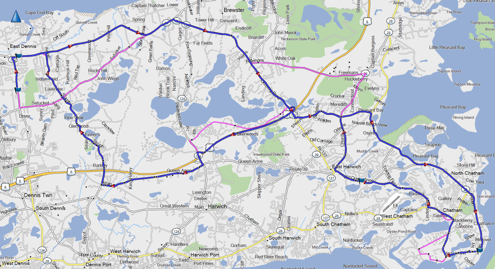

Given all the recent posts on this subject, I decided to retest the issue originally reported here with current updates.
Bottom line, over the last 18 months, Garmin has made zero progress in addressing the issue.
I updated my XT2 to current firmware (6.40), updated to the most current maps and reset the XT2 (Settings->Device->Reset->Delete Data and Reset Settings).
I also removed the XT2 Bluetooth connection from my phone, then installed the latest version of the Tread App (3.00.06).
When reconnecting everything, the option to "Enable [cloud] Storage" was presented. I initially did not chose that.
On my PC, I deleted everything from my sd card, then copied the route from my original post here to the sd card and imported it to the XT2. All was well as expected.
I was unable to perform any kind of sync until I "Enabled Storage".
Once I enabled storage, a sync occurred automatically and the route changed significantly. Below, the original route is magenta, the route after sync is blue.
ChathamLoopBeforeAfterSyncMarch 2026.png (1.48 MiB) Viewed 623 times
This is the exact same result as the one in August of 2024 - see the original post in this thread for details if interested.
I wonder if anyone with an XT3 can reproduce this. Maybe the XT3 includes different algorithms.

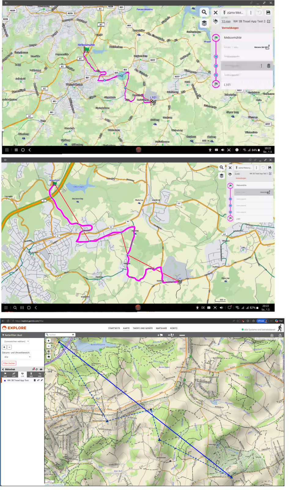

I did some experimenting, first without any zumo XT 2 Bluetooth connection.
Note:
I'm currently playing around with my zumo and tread 2 for these experiments, and the Tread 2 can also sync with the cloud via Wi-Fi, without the Tread app at all.
My test environment:
- Smartphone 1
- Smartphone 2
- Garmin Explore website in PC browser
- zumo XT2
- Tread 2
1st test:
Creating a route with shaping points in the Tread app on smartphones 1
1st results:
Route is 1:1 with shaping points, without any noticeable differences, then also
a) in the Explore cloud
b) in the Tread app smartphones 2
c) When I then create a track from the route in the Explore website, the desired shaping points can also be seen 1:1
2nd test:
Connection of the Tread 2, only via Wi-Fi, without the Tread app or without Bluetooth activated on the smartphones
2nd result:
The shaping points are also in the Tread 2 device,
but all shaping points are slightly shifted!
3rd test:
Everything deleted again.
Tread 2 device switched off.
Prerequisite from test 1 rebuilt 1:1.
Checked that all shaping points (approximately) are the same as in test 1, in smartphone 1 = smartphone 2 = Explore website.
OK Shaping points are correct again.
Bluetooth activated on a smartphone.
zumo XT2 switched on, synchronization started.
3rd result:
The shaping points are now also in the zumo XT2 device, just as before in the Tread 2 device,
but again, all shaping points are slightly shifted!
What does all this tell me?
I'm confused.
It's all too complex—why, who, when, and on what basis the shaping is shifting.
It's not just one thing.
And I suspect it only gets bad when all three work together, mainly the navigation device and the Tread app.

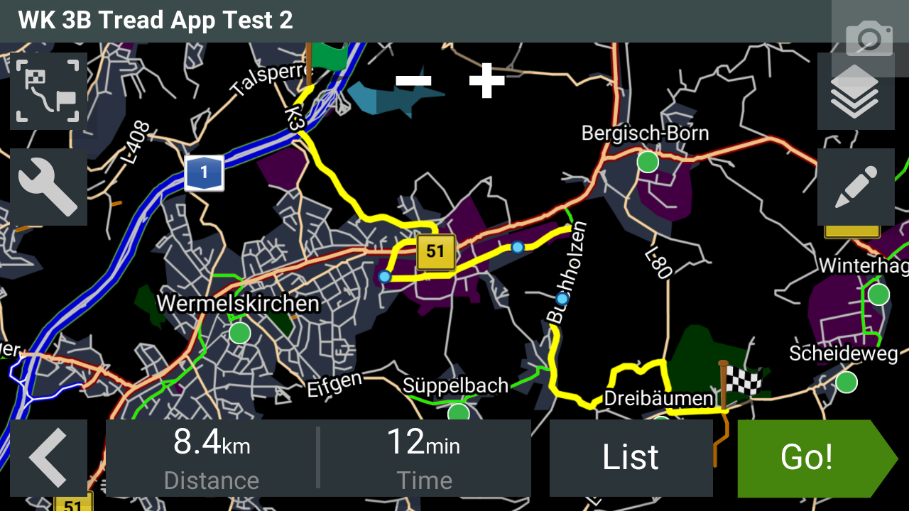

Here are also the screenshots ;-)
WK 3B Tread App Test TA-Explore.png (2.4 MiB) Viewed 599 times
WK 3B Tread App Test zumo XT2 device.png (651.58 KiB) Viewed 599 times
And here in zumo XT2 image with red dots where the shapings of the Tread app were set.
WK 3B Tread App Test zumo XT2 device cpmpare.png (650.19 KiB) Viewed 598 times
