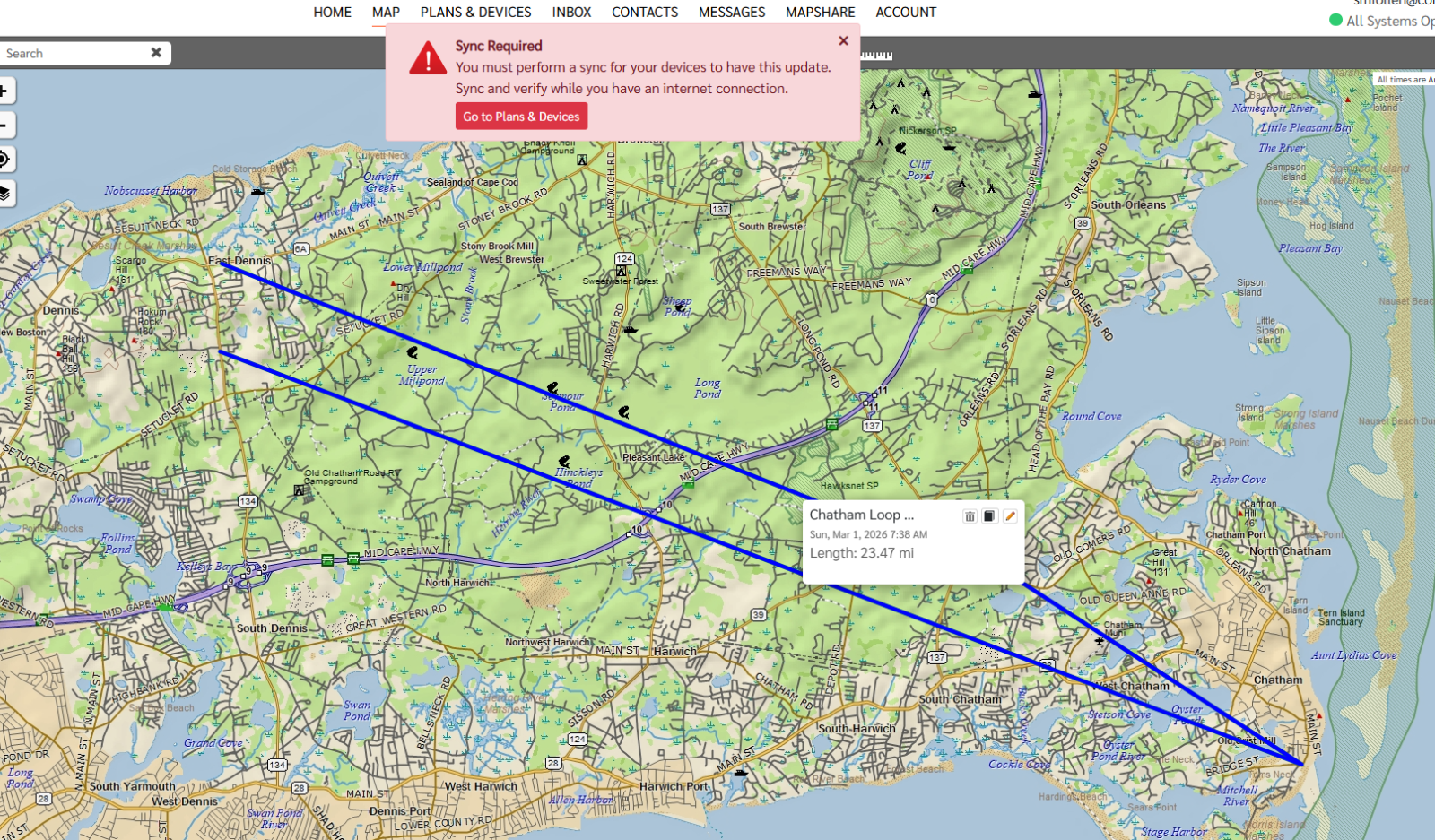

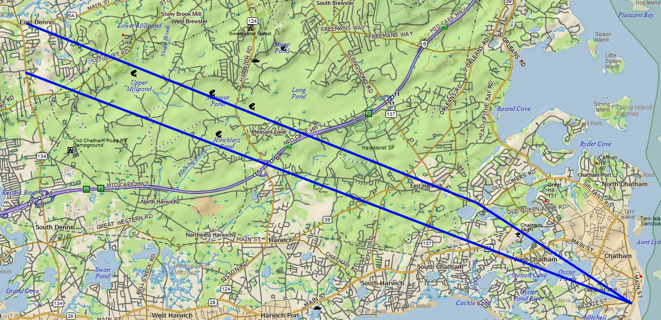

@proofresistant It seems that when the automatic sync happens, explore has only the route.
Your third image (ChathamLoopOriginal3Explore Cloude.png) has both route and track ... and you say.
That involves an additional sync which would not normally happen automatically.
Without that additional sync, Explore appears to have only a route made up off only waypoints.
My guess, and its only a guess, is that when the Tread App syncs back from Explore to XT2, it takes only the waypoints from Explore, since that is all that is there, builds a route from those, and then adds some random shaping points to that new route.
Tread does seem to "know" how many shaping points belong between each waypoint pair, so it creates the original number of them, but in random locations of its own choice.
Of course, it could be the XT2 adding the random shaping points back in rather than the Tread App, or even Explore?
So you apparently converted the route to a track on the Explore web page?3 Explore Cloude arrived an track created

I tested with my Tread 2 Nav Device.smfollen wrote: Tue Mar 03, 2026 12:44 am How did you get from the XT2 to Explore without going through the Tread App?
Unlike the zumo XT2, the Tread 2 device can also synchronize with the Explore Cloud via Wi-Fi (without the Tread app).
Yes, exactly.smfollen wrote: Tue Mar 03, 2026 1:19 am @proofresistant It seems that when the automatic sync happens, explore has only the route.
Yes, I did it manually; it doesn't happen automatically.smfollen wrote: Tue Mar 03, 2026 1:19 am Your third image has both route and track ... and you say.
That's exactly what I thought, but the shaping points are also available in Explore Cloud.smfollen wrote: Tue Mar 03, 2026 1:19 am Without that additional sync, Explore appears to have only a route made up off only waypoints.
That's why I created a track from the route on the website. That way, you can see more of what the cloud has to offer.
I have now also attached a gpx file with the track as it was found in Tread 2 Device. It was a 2nd test without the Tread app, which I had “locked away in the basement.”
To me, it looks as if all the original chaps were actually taken into account.
I (almost) agree with your thoughts, but to be honest, I still don't really understand what's happening there and why.smfollen wrote: Tue Mar 03, 2026 1:19 am My guess, and its only a guess, is that when the Tread App syncs back from Explore to XT2, it takes only the waypoints from Explore, since that is all that is there, builds a route from those, and then adds some random shaping points to that new route.
I'll try your example again, but only with the Tread app and only the device, without internet access, but I need time for that too.

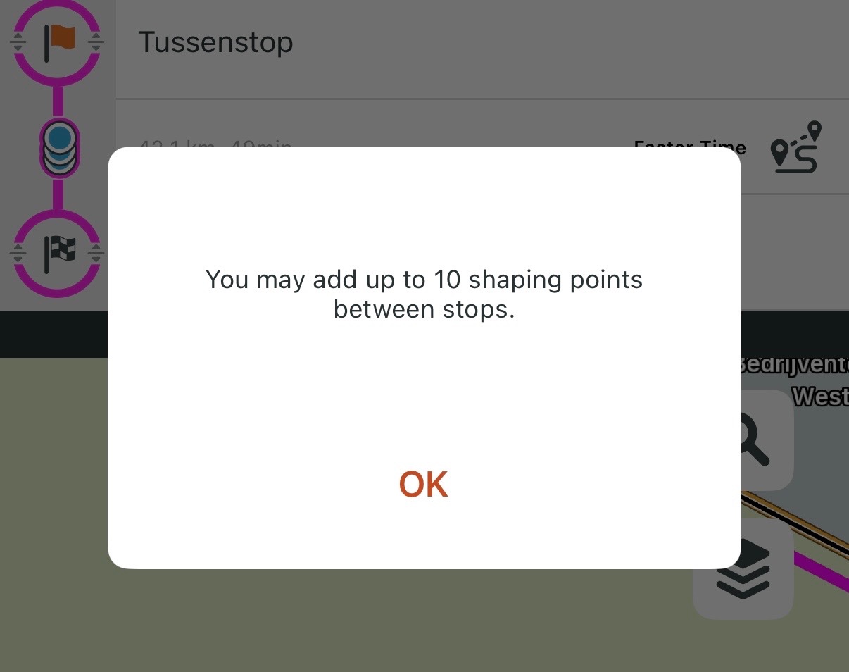

In newest Tread App i also saw this message today with the maximum of 10 "Route points" between destinations.
I don't know if it really is may a “new” restriction, as I often have more than 30 shaping points between the VIA points myself.
So their comment doesn’t make sense. I believe that they mean ‘shaping points’.

@jfheath I’m really not sure if the 10 shaping points between stops thing is bogus or not. I’ve just made a route on Tread from near my house up into North Yorkshire. Once I got to 10 shaping points, I got the message, pressed ok but it let me carry on adding more shaping points. Whichever is your latest placed point becomes a temporary ‘stop’ until you place another shaping point.
I do not get any message if I import a MRA built route into Tread that has many shaping points. Bizarre.
Editing the route is where it gets difficult. It seems to be easier to delete shaping points working back along the route and replan. It’s not the easiest platform to work on and would be so much better if there was a web based version to use on a PC.

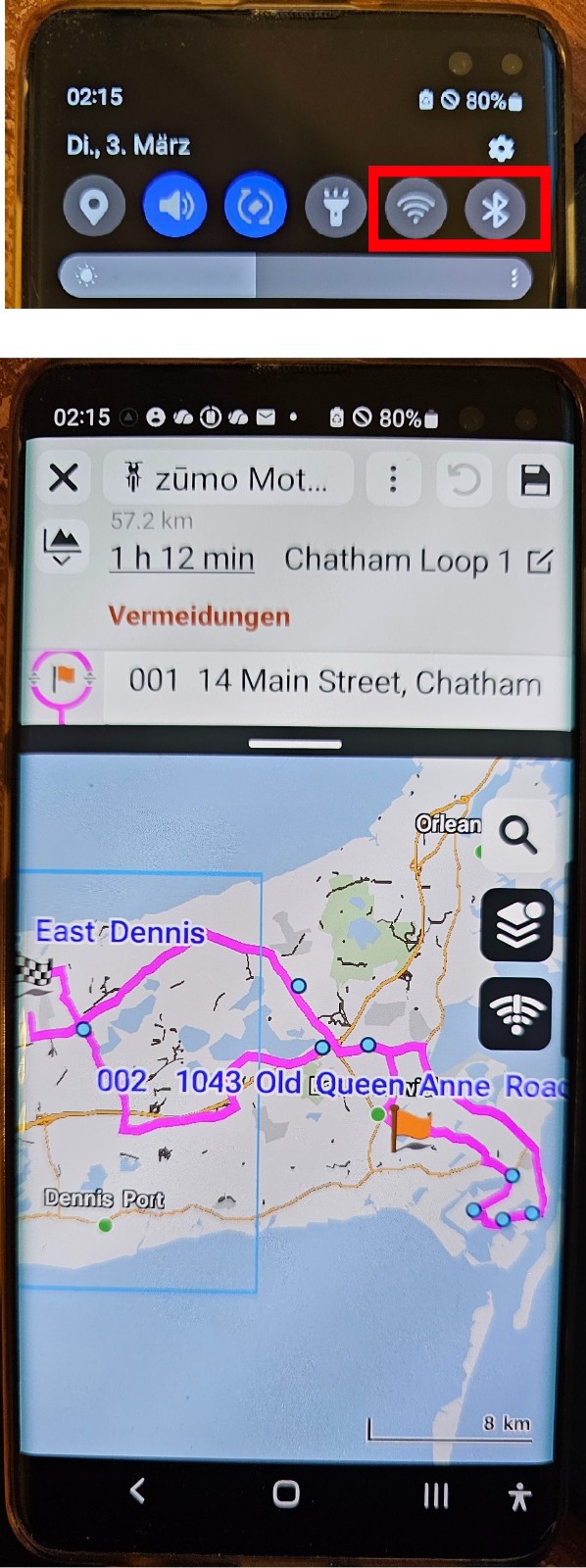

Sorryproofresistant wrote: Tue Mar 03, 2026 12:32 am Just i tested also. With map City Navigator North America NT 2027.1, Tread App version 3.00.06 and Tread 2 (edit: i tested Tread 2 not zumo XT2 firmware 6.40. )
Anyway, here are my results step by step.
- 1 BC source
- 2 Tread 2 Imported (edit: i tested Tread 2 not zumo XT2)
- 3 Explore Cloude arrived an track created
- 4 Tread App arrived (and soon changed?)
I may have swapped the order of steps 5 and 6, but that's not very relevant, i belive.
- 5 Explore Cloude Resynchronized
- 6 Tread 2 Resynchronized (edit: i tested Tread 2 not zumo XT2)
it was probably too late for comments last night
I tested everything from this post with the Tread 2, not with the zumo XT2
I just noticed it and corrected it

For me it did give this 10 shaping point message after a MRA import. However it still imports the route with all shaping points but off course they are shifted. Strangely enough it shifts the points again if different adventurous routing levels are selected. More strange to me is that adventurous level 1 is the least “straight” in this case. (Something also already mentioned somewhere here I believe)
