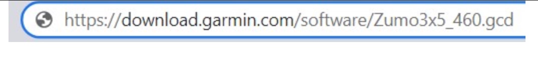

Did you get the firmware? I downloaded mine from this address :
Zumo firmware
Zumo firmware
The spelling and capital letters needs to be exactly the same.
Hope this helps!
Re: 395LM Stuck in boot loop
Posted: Tue Jul 25, 2023 4:30 pm
by lkraus
Just click the link, save some typing:
https://download.garmin.com/software/Zumo3x5_460.gcd
