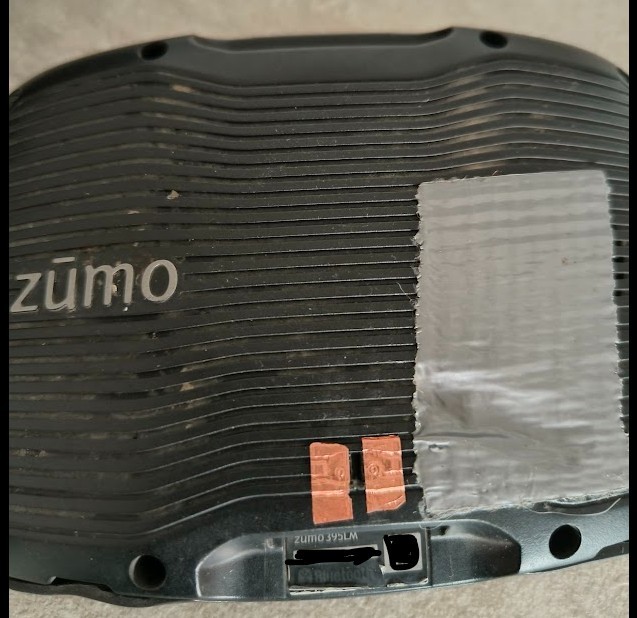

Re: 396 goes off and on by itself while navigating.
I wasn't comfortable with my soldering skills.
So I bought some electrically conductive tape and added two layers of it to the pins in the device.
After a day's test ride, this seems to working.
The duct tape is there because I lost the rubber cap sealing the usb port
That's a better solution.
With hindsight, the adhesive on the reverse side of the tape may not make a good electrical contact with the pads on the Zumo.
Edit - UPDATE
Well I tried it with aluminium tape, cutting a small circle out with a belt punch and then covered it with a approx 8mm square of the tape.
When I went to try it on the Zumo cradle the Zumo 396 went dead.
At first I thought it was a really flat battery, nothing seemed to work and then the penny dropped. I had put the 396 into the cradle kind of awkwardly and I must have shorted across the 396 and done some serious damage to the 396.
So be aware, the foil tape repair comes at a price if you get it wrong. I'd recommend small circles on top of the 396 contacts and not squares like I done.
I'll probably draw a line under this whole sorry saga and replace it with an XT. ( The Tom Tom Rider that I am using in the mean while is driving me nuts.)
Edit - UPDATE

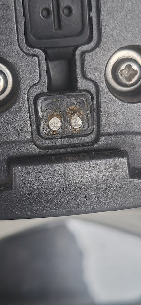

Yes, I have. It's a 390 but looks identical on the photos. The pins on the cradle were visibly recessed too far, and indeed were bending over. I kept having to re-align them with a small screwdriver, but this was only a temporary cure. So I carefully blobbed a bit of solder on the cradle contacts. It takes a bit of care and persistence, as the gold contacts don't like solder. And I took off a bit of surrounding rubber with a scalpel. But I succeeded in the end, and have had no problems since then. (Well, until my Zumo died last week, after downloading an update!Totti wrote: Mon Jul 28, 2025 6:27 pm , I was wondering that has anyone tried to solder these pins so that they would be higher and the connection would be better and firm?
- 20250903_115708.jpg (54.67 KiB) Viewed 810 times
