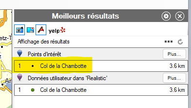

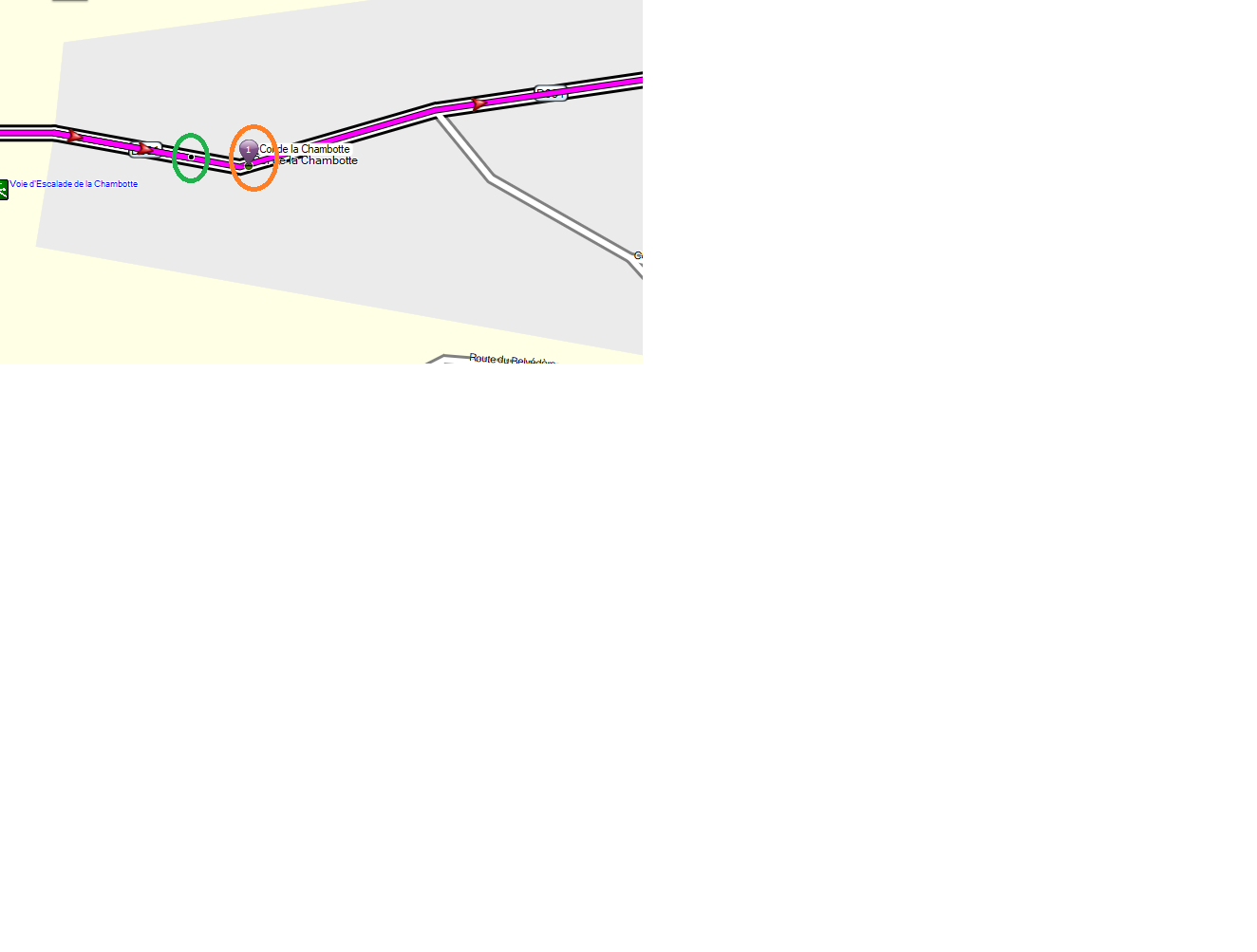

I found at least one reason why the GPS calculates a route when importing it in the trip planner. This happens when the route contains points coming from the search tool (first picture, search for "col de la chambotte")
A "searched point" inserted in the route will cause the Trip Planner to calculate the route even if you think this point is properly positioned on the route (2nd picture), the point within the orange circle was inserted in the route using the search tool, the point inside the green circle was inserted manually)

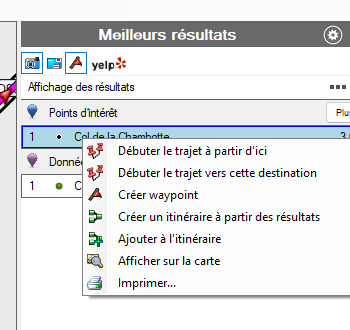

I did the following experiment (You can use the attached GPX to double check)
1- take a route that "works" (meaning the GPS does not calculate when the route is imported using the Trip Planner)
2- Add a waypoint in this route using the search tool, export to the GPS
=> The GPS will calculate the new route (even if the waypoint is positioned correctly on the "old" "working" route 3- remove the waypoint you inserted before, export
= > Trip planner does not calculate the route when importing it
My conclusion is that one should not use the result of the search tool to add a point in a route (unless you don't mind the trip planner to calculate). Use it to locate what you are looking for on the map then zoom and insert a waypoint/shaping point manually
ps: Sorry for the screenshots in french but switching to english puts the mess in my Activity profiles
ps: I believe that when adding a point using the search tool, you are actually adding a reference to a POI and the GPS searches for the POI in its own database, hence the calculation (a POI comes with the information that comes with the database and you may want to find this information also on the GPS, hence the search)) That is a just a guess. True or not, that does not change the net result, the GPS calculates as soon as there is such a "point"in a route.

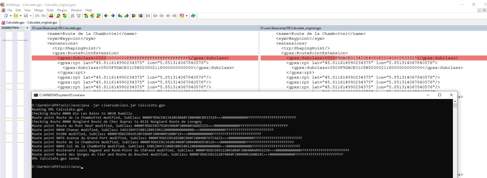

@jfheath Hi John. This is yet another issue that can be explained (and maybe solved) from the subclass field. If I set the subclass fields from the <rtept> to the special value '00ff' calculating on the XT is instantaneous.
This is a filecompare. Left is the modified value, right is the original. @chris7444
What you see here is the output of a small Java program I have written. If you feel confident executing commandline programs and are interested send me a PM.
