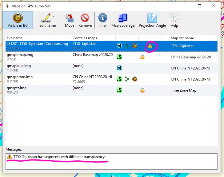

I bought a Tajikistan map from Talkytoaster.me.uk and using Javawa, installed the map onto my Zumo. I thought Javawa would install the map into my sd card but it has placed the map into the Zumo itself. It is also flaging a transparency error.

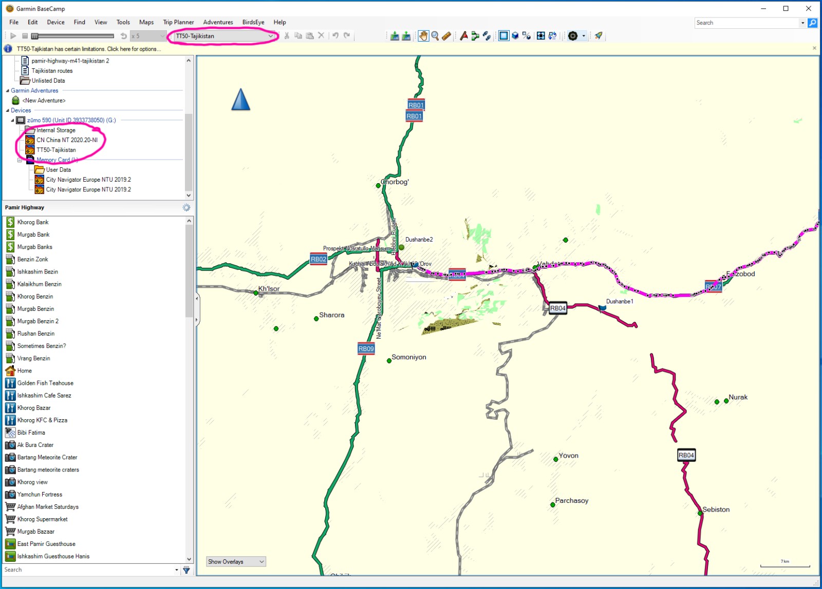

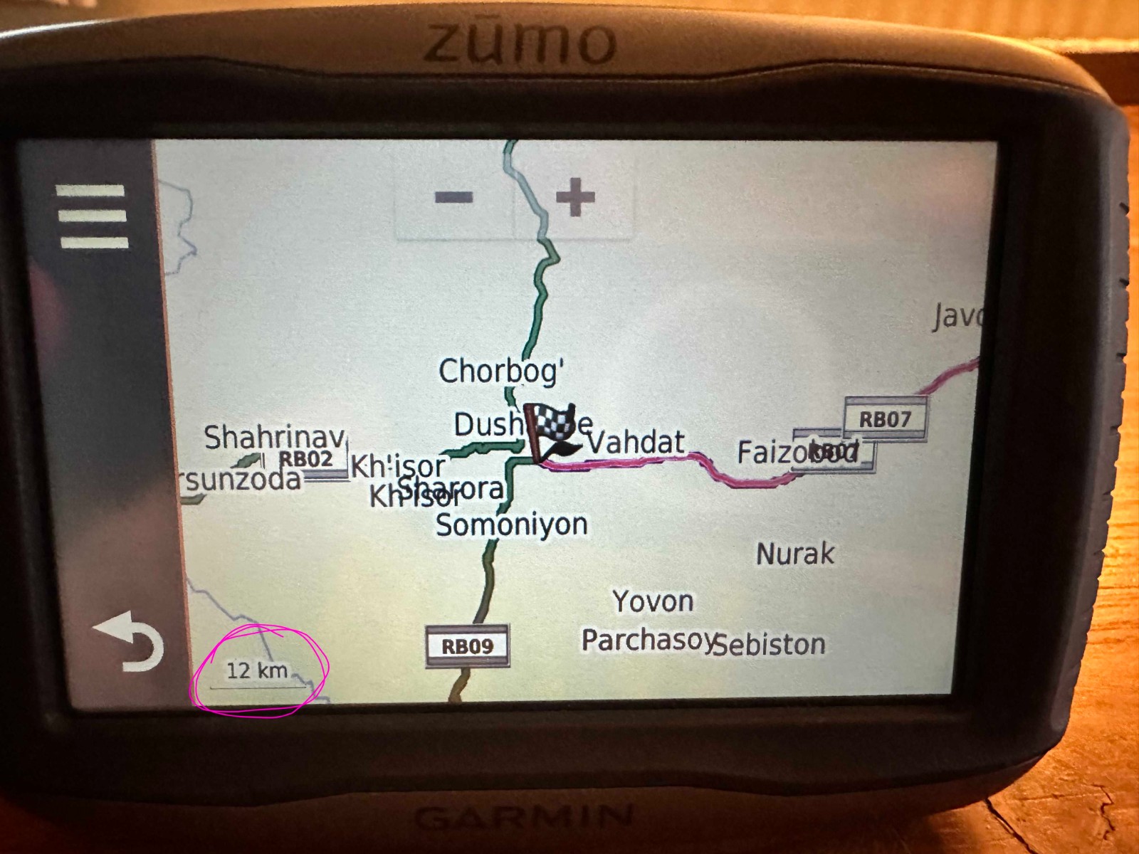

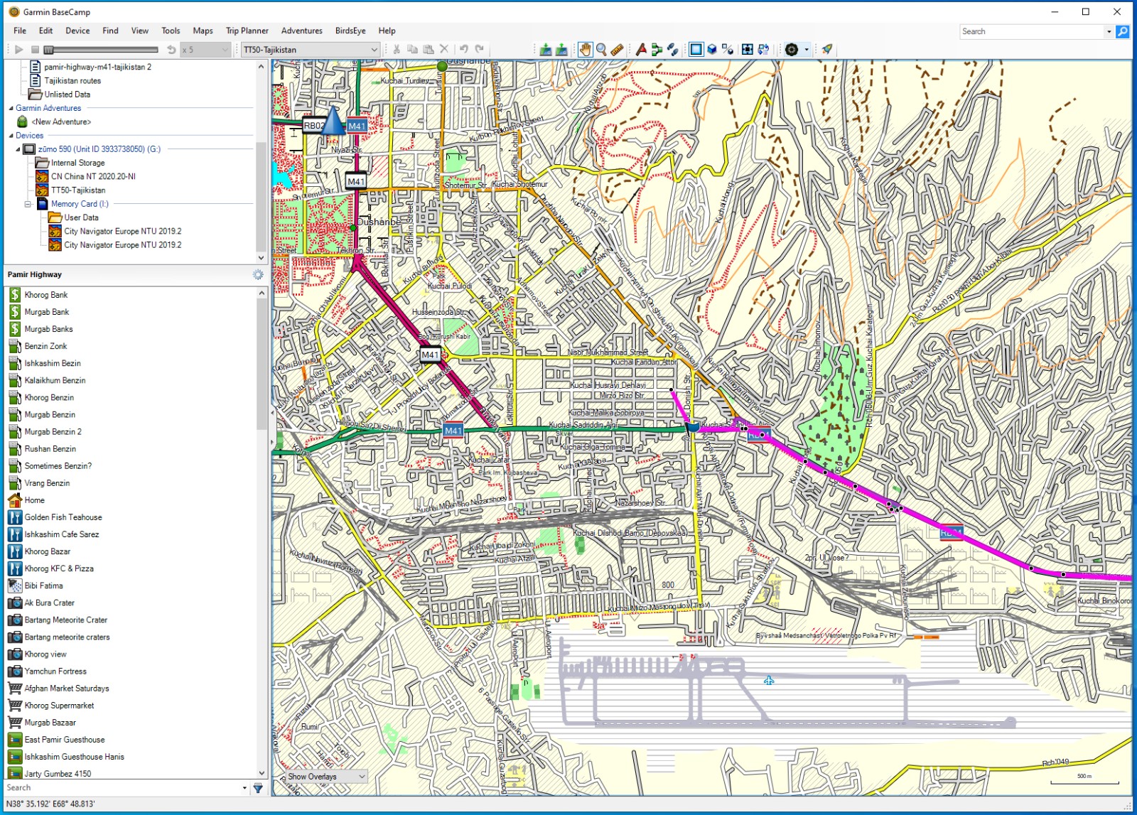

Basecamp can see and display the map off of my Zumo and it is quite detailed. BUT!!! My Zumo says there are 2 copies of the map installed.

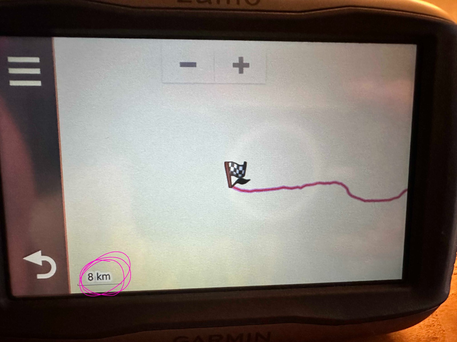

And as I zoom in on the map there is less and less (no) detail.
What am I doing wrong, any suggestions?

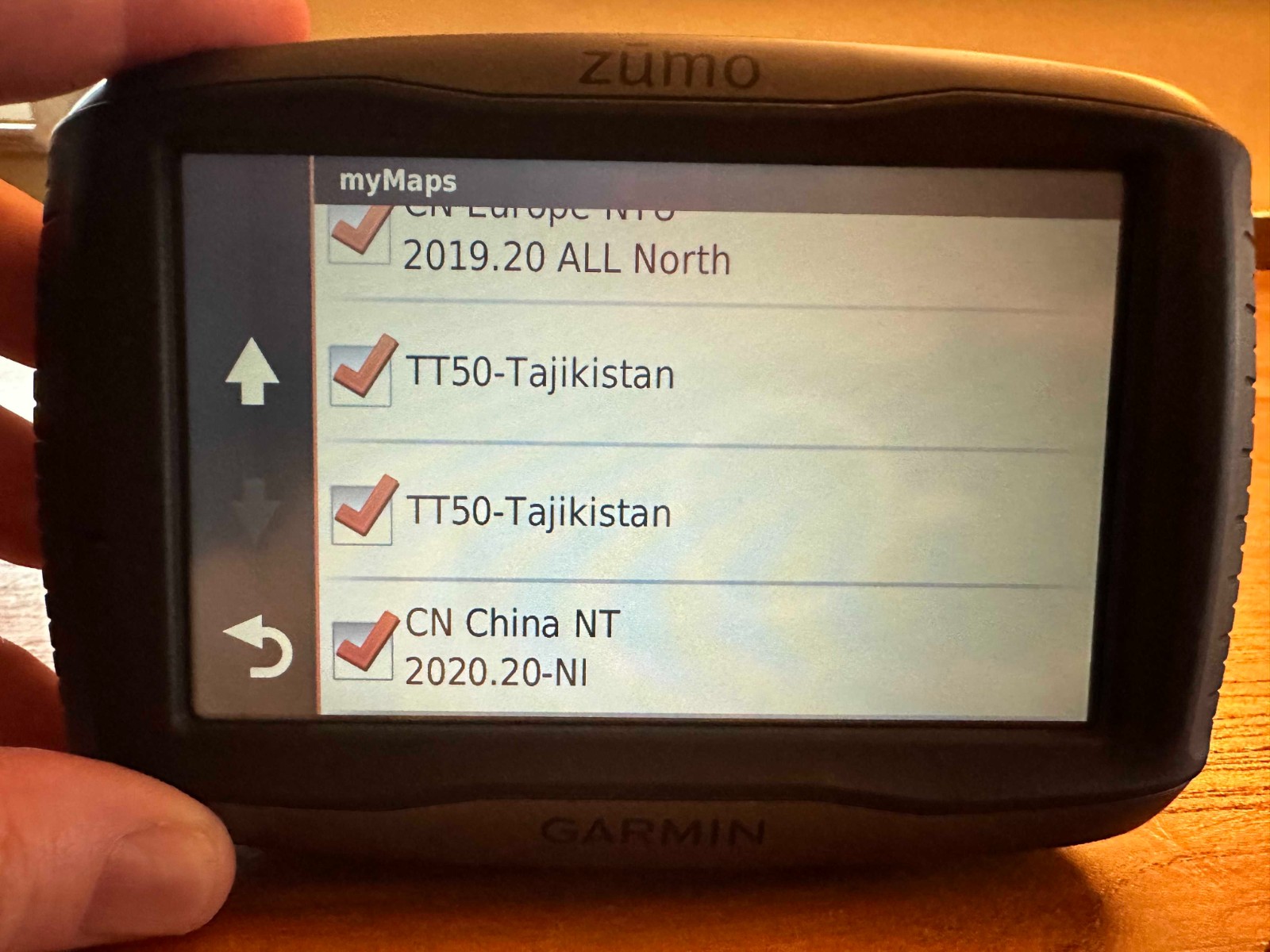

I don't know - but I would turn off all other maps to start off with. There is always an issue if two different maps cover the same area. Your OSM maps are probably a different area, but It is still worth trying.
The two OSM maps 'may' cover different areas, but I would try turning off one, then the other to check.
Check the map detail option for your 590. It has 3 levels. Settings -> Map & Vehicle.
[Edit] - With the Zumo attached, Basecamp should be able to select the OSM map on your 590 as well as the OSM map on your computer. Select the one that is on the 590. How do you know which is which ? You don't. Choose one. If you have chosen the one on the Zumo, it will tell you that there is one on the computer, do you want to use that instead? No you don't. You want to use the one on the Zumo.
It will be slow accessing it, but zoom in to the same place. if the amount of detail on the Zumo is different from the amount of detail on the PC map, then you have a map problem. If it is the same, then the map on the Zumo is not at fault, so it must be something on the 590 itself. A setting maybe or maybe it needs a little more time to refresh the screen. I don't know. I'm clutching at straws !!
