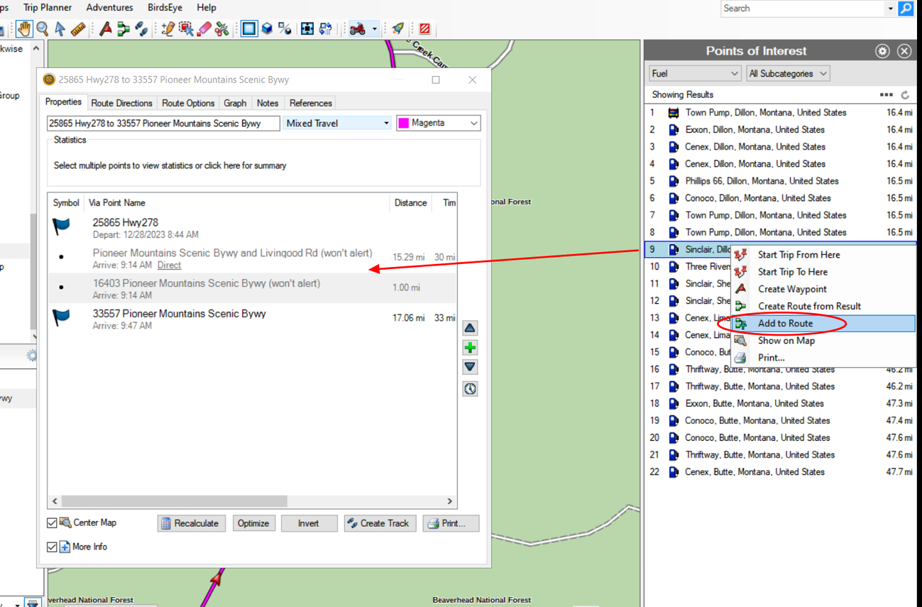

jfheath wrote: Wed Dec 27, 2023 4:51 pm the Waypoint has to exist before it can be added to a route. You cannot create and insert in one operation.
I think it can using the right-click context menu on a search results item. You can control where in the route that waypoint is added as well.
BC Add to route snip.png (492.87 KiB) Viewed 3356 times

Goodness - I didn't know about that trick. Thank you. I knew the add to Route feature popped up when you right clicked one of the symbols on the map after a search - but I rarely use if for some reason. Perhaps because so many of the places I searched for in Spain (years ago), were inaccurately placed. But they are handy for the phone numbers - if they are correct !
Those waypoints already exist though, so my statement still stands - sort of - I think I'll go back and correct it! I think I mention elsewhere that either you have to create them or select the ones that have already been stored in the database.
But thank you for that - it certainly completes that picture.
