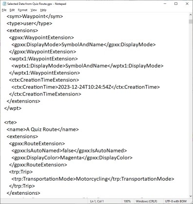

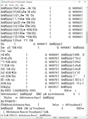

I couldn't resist - so dug out my packed XT.
I exported a track, route and associated waypoints to a gdb file. I did this from both Basecamp and from Mapsource.
There was no way that I could get the XT to locate any of the data that was in the GDB file either when I placed it in internal storage or on the memory card - which is what I expected.
Look at the screen shots of parts of the same file - one exported as a GPX - legible text, the other exported as a GDB - largely unreadble and containing what appear to be database data structure information - eg field names, which were never used in the data that I created.
GDB is the format that was used in Mapource. But the same format is also used by Basecamp - and it seems not to have changed. Export data as a GDB file, and Mapsource will read it. Ditto the other way around.
