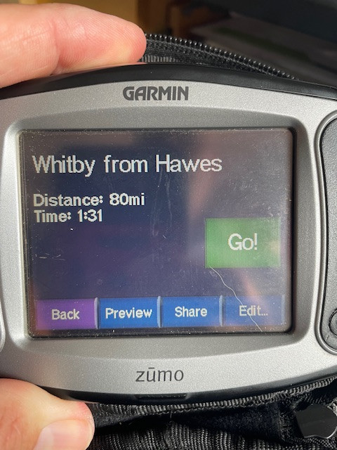

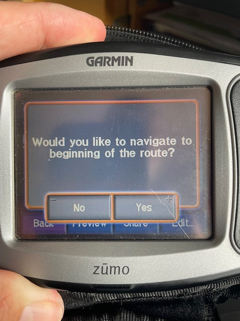

Pics of the approach offered by the 550 attached. The Hawes-Whitby route has only a start and finish and no waypoints. If I choose not to navigate to the start point the 550 will begin providing instructions if I cross the route. 559 will not do that unless, as you say, you add a waypoint etc

If you encounter the route between the start and finish points, routing instruction to the finish point commences without any futher questions. Such a useful and, to my mind, obvious feature. I did discuss its loss with Garmin as did members of the original Zumo forum. Garmin was never able to provide a convincing explanation and I think that the furore caused by the, frankly not fit for purpose, display on the 590 allowed it to be forgotten.
