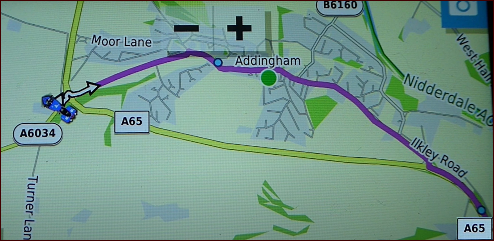

Take a look at this screen shot.
This screen shot of part of a route applies to both of the following videos. I am on a side road just before the roundabout. I have loaded a route and I am following it, having previously skipped a route point that I had placed close to the start (so that I could skip it !). I ulled over to get some the above screen shot.
It shows me stopped on a side road immediately ahed of the roundabout. Note that when I am not moving, the satnav doesn't know which way I am facing !! I am actually facing South - but I was facing that way a few seconds before I stopped moving.
The planned route is shown by the magenta line. There is a Shaping Point on the magenta line after the roundabout and before the village of Addingham. I need to take the second exit to go through that Shaping Point. The third exit at the roundabout is the A65 (we go around rouandabouts clockwise in the UK) - a fast 60mph road which by-passes Addingham. It joins up with the magenta route in the bottom right hand corner of the screen shot - and there is a shaping point just after that - so I pass through that shaping point whichever route I take.
Both videos show what happens when I take the 3rd exit (A65) road at the roundabout instead of following the route to the 2nd exit.
The only difference in the videos is the the first one shows what I regard as 'correct' behaviour. What the Zumo 590 would have done. It has been created using the Zumo Trip Planner using stored Waypoints (from Zumos Favourites). The Zumo regards this as a 'Saved' route.
The second video shows a route that uses the same waypoints. Not copies. The same ones. The route has been create din Basecamp, transferred to the Zumo XT and then Imported. The Zumo XT regards this as an "Imported Route". I drive the same route doing the same things in both videos.

There is one strange (to me, at least) thing, though. I am attaching a screencap. The arrow is pointing to where I selected the route and told the Zuno to go and start from the nearest point. You can see the start of the route to the left and down from that point. However, the first instruction the Zumo issued was to turn right at the first corner. This would have taken me in the opposite direction from the start point. I ignored the instruction and after a couple of bad instructions, it told me to turn left onto Terry Fox Drive, which is where the start point is.
I supposed that I should have followed the instruction to see where it would have taken me. If doing that will help with any advice you can give me, I can do that tomorrow.
In the meantime, can anyone tell me why the Zumo is taking me in the wrong direction?
Thank you

Videos and explanation are now included. It is a suggested explanation for why you might be seeing this behaviour.
Ignore if it is getting too involved. I find this stuff interesting - I like to know the causes so I can find an answer.
Russ's (@rbentnail's answer is the obvious and easiest one - don't use Closest Entry Point for the start of a route - which is what I suggested was the reason earlier on. But if you want to know why - then that earlier post is my best shot at an answer - based on the XT. But since the XT2 is behaving in a similar manner .... it may well apply. I would be interested in anything that you find out as a result.

@rbentnail I wanted to address your advice directly. I just got back from the same route. The short one that simply starts on Terry Fox and runs south. Previously, I had chosen "closest point" as my start point. This time, as you instructed, I chose "terry fox", which was the start point. I had the choice of closest, terry fox or the end point.
Now, keep in mind that the shortest and fastest route to the start point from where I was parked is west on Campeau for 2km, then south on Terry Fox. The start point is about 200 metres from that turn. This time, as on previous tries, the xt2 took me east on campeau for 1.5 km to eagleson. From there, it took me onto the 417 west for 2 km to the Terry Fox off ramp. Now, using "closest point" from here it took me south on Terry Fox, ignored the start point completely and kept going south on Terry Fox until the end point. This time, using Terry Fox as the start, it turned me north on Terry Fox. Now I was going toward the start point, but going the wrong way. Right away, it said that I had arrived at Terry Fox. Then it said to make a U turn in 200 metres. I did so, and it finally got me to the start point and the onward.
So, I suppose in the minds of Garmin, this was an improvement over the route that ignored the start point. I'm not sure that I would call driving twice the distance necessary and having to make a u-turn on a 4 lane, 70kph road an improvement.

I'm just trying to rebuild your route. I can't see where you have mentioned where the end point is (Approx would do). I quess somewhere further West of Palladium Drive. I'll put in the most westerly roundabout on Palladium Drive
