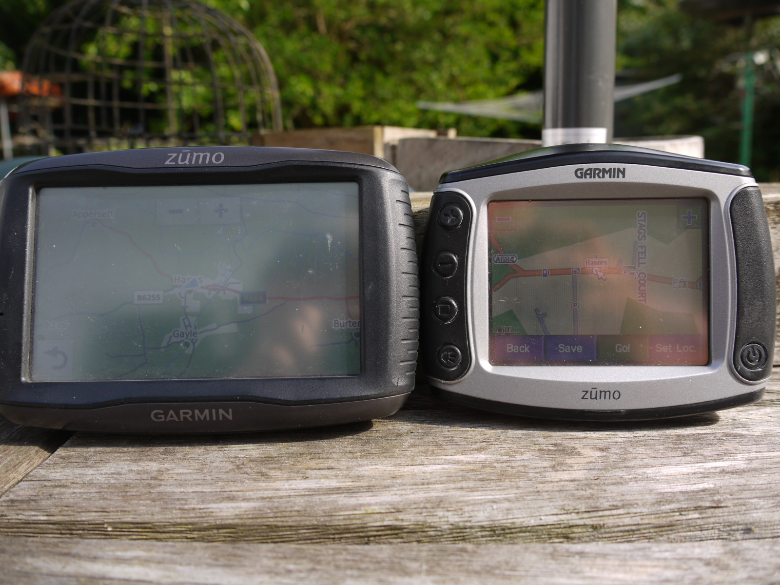

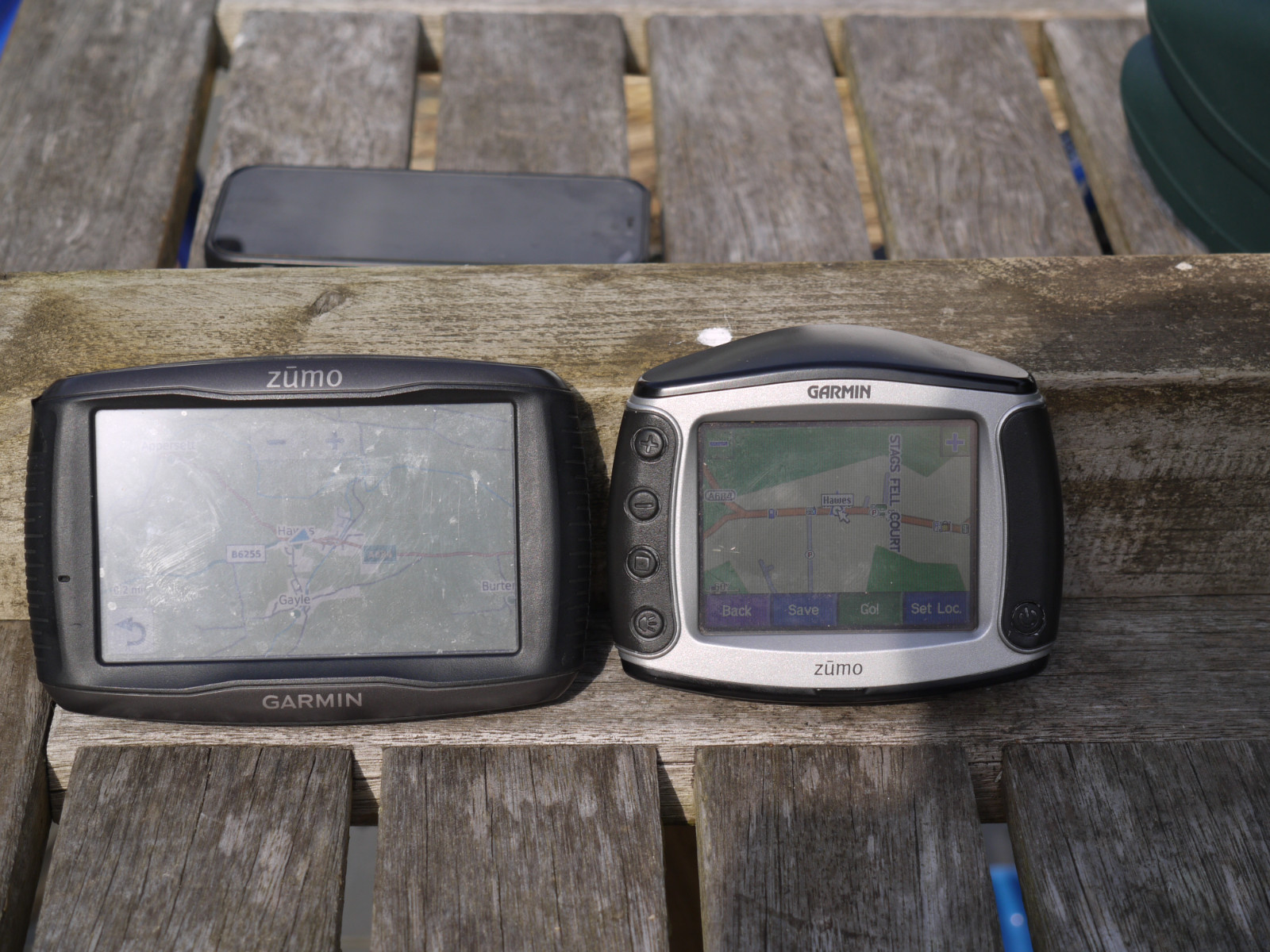

550 and 595 centred on one of my favourite locations. Interesting to see that 550 has a very noticable refesh rate unlike the 595
sun on right.JPG (483.39 KiB) Viewed 3875 times
sun behind.JPG (532.58 KiB) Viewed 3875 times
