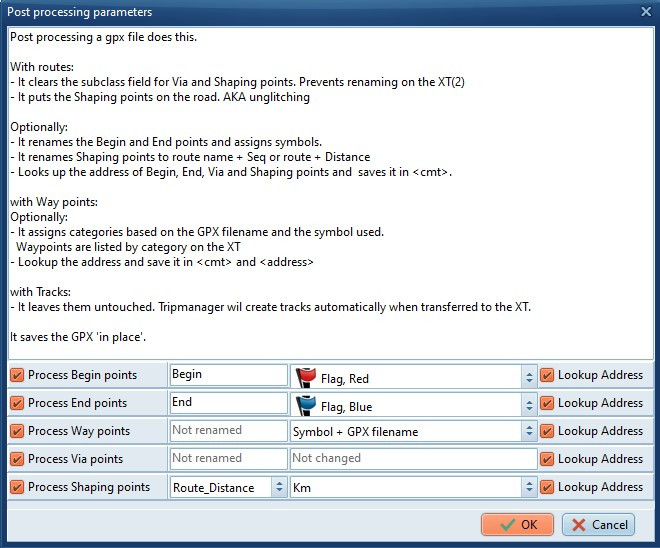

jfheath wrote: Sun Jul 27, 2025 10:38 am I'm curious. You said the route was created in Basecamp. Yet the route points have flags and you cannot set the icon for ad hoc route points.
Maybe, just maybe this is the result of the Postprocess function of TrIpManager?jfheath wrote: Sun Jul 27, 2025 10:38 am My recalculated routes, like yours, have the subclass 00000FFFFF string, which surprised me.

Re: Looking for the best start option to begin a planned route.
Once a subclass is reset to '00ff' it remains that way. Only when creating a new Shaping/Via you can be sure the subclass is initialised.jfheath wrote: Sun Jul 27, 2025 2:22 pm But if so, it is odd that even after changing maps and recalculating twice the 'null' subclass field remains intact.

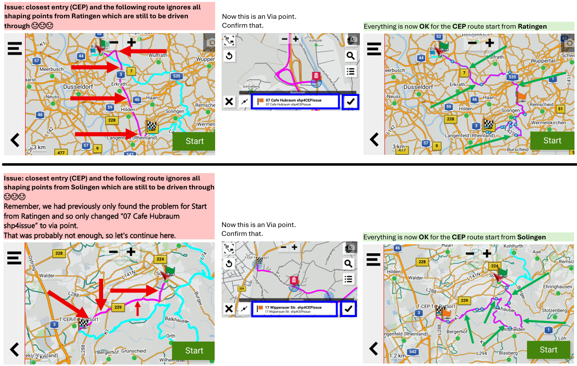

So, it's done for now.
I have now also worked out the appropriate demo for the compilation of CEP findings I posted a few days ago. Don't worry, it's only a “small” route with 2 issues included.
Additionally the CEP issue also is documented step by step. You can see how two CEP Issues issues appears and how I was able to fix them myself during the trip with the zumo XT2 as an example. Please take a little time here
Attached is the matching PDF and the matching GPX template.
Content al little bit more like this
Hopefully my experiences will also help you.
May also for the old zumo XT (1) but I can't test that myself.
I would be pleased to receive constructive feedback
