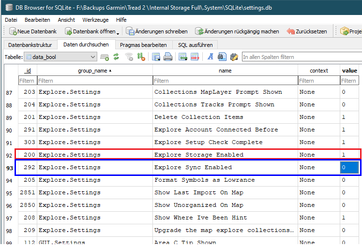

An idea for those who want to experiment a bit and aren’t afraid of manually updating database content :ugeek:
As many of you already know, the new devices store a lot of data in an internal SQLite database.
The [settings.db] file is also one.
Here, you can "set" (modify) whether Explore Sync should be enabled or disabled.
[settings.db].[data_bool] Explore Sync Enabled = 0 (original Value = 1)
PNG-Bild (neu) (11).png (79.61 KiB) Viewed 883 times
Changing the value of Explore Storage Enabled is not recommended, as this will make it impossible to access routes, etc.
So it’s best to leave this as is!
[settings.db].[data_bool] Explore Storage Enabled = 1
I’ve been experimenting with this for quite a while now :roll:
I can keep the Tread app installed, avoid any exchange of routes, tracks, and waypoints, and use the Tread app for traffic, weather, and music, etc.
When there’s a new Tread app or device update, I can test the synchronization again and reset it without having to completely reset the entire device.

Thanks for that @proofresistant .
I keep meaning to get my SQL database tools out and look at what is in there. As I get more mobile and can do more walking and exercise I find that my capacity for 'thinking' and 'concentrating' is improving - not back to where it used to be, but definitely improving.
So by resetting that value - you don't have to delete Tread from your phone, or reset your zumo to factory condition ? You can just turn it off and back on again ?
I assume that you have to edit a copy of the database file and save it back - or can it be edited in place ?
