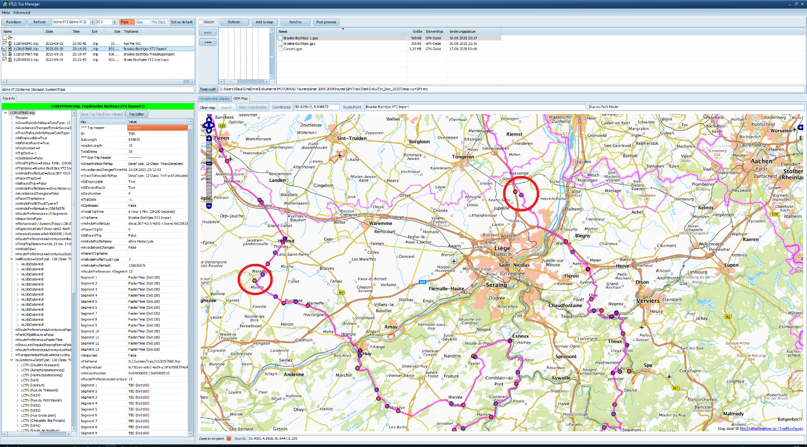

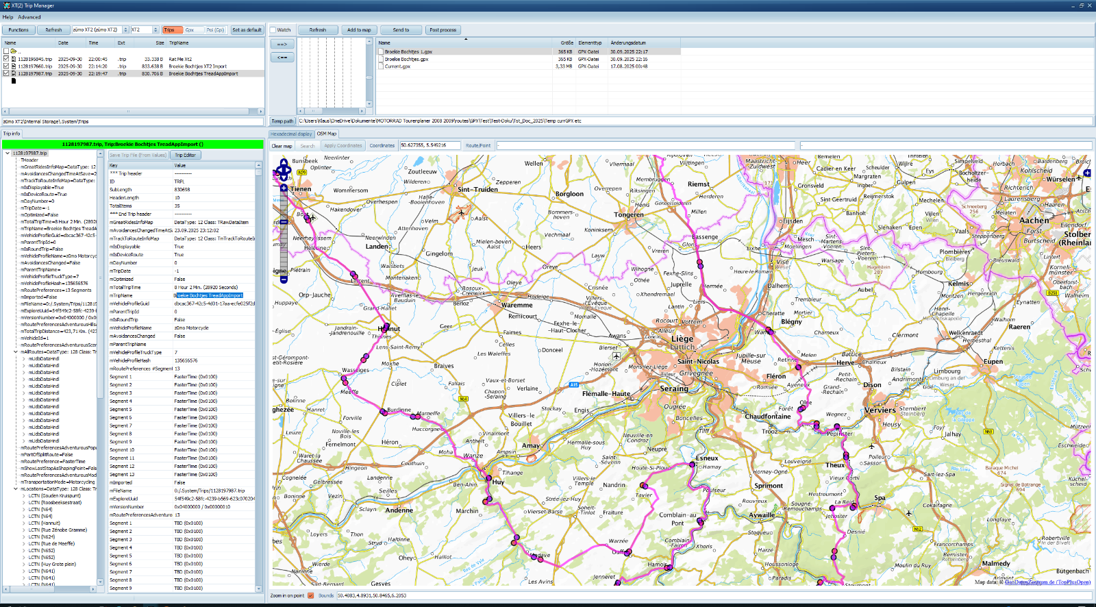

Lanso wrote: Tue Sep 30, 2025 7:19 pm Would you mind trying out my route for any changes?
Broekie Bochtjes.gpx
So I tested it.
See both attachments.
Broekie Bochtjes TreadApp Import.png (1.51 MiB) Viewed 428 times
Broekie Bochtjes XT2 SD Import.png (1.52 MiB) Viewed 428 times
I don't understand what the Treasd app does in conjunction with the zumo XT2.
At first, it looked good. I imported via the Tread app and didn't see any major differences.
Then I imported via the zumo XT2 and the differences were visible.
Two differences also led to deviations in the route guidance.
Then there were synchronization problems.
At times, I couldn't open the route at all, with errors such as “Route calculation not possible,” but at some point it worked again.
So, more time invested and more frustration.
To everyone, try it out and share your experiences.
I don't have much hope.

Thank you kindly for properly testing!
That indeed looks like it's still messing up routes. That's a downright shame :(
Did anyone ever made a report to Garmin about this?
