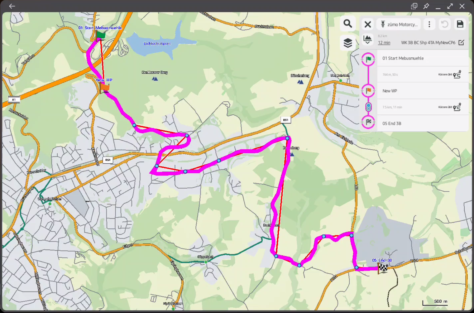

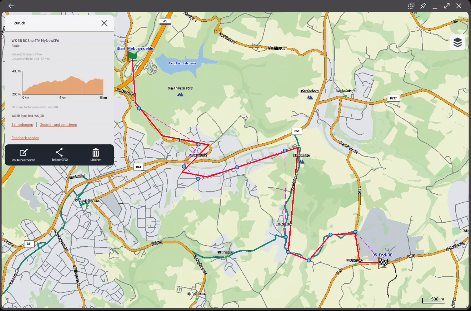

Take a look at my result for the route from @Lanso :
proofresistant wrote: Tue Sep 30, 2025 9:48 pm So I tested it.
See both attachments.
The route imported via the Tread app was very similar to the original, with no significant different shaping points.
The route imported via zumo XT2 was very different from the original, with visible different shaping points.
The fact remains that I (or rather we, have no (certain) explanation) as to what happens there, when, why or how.
What is still unclear to me is whether the Tread app also has or recognizes the ghost points between the waypoints or not.
Explore doesn't seem to have them.

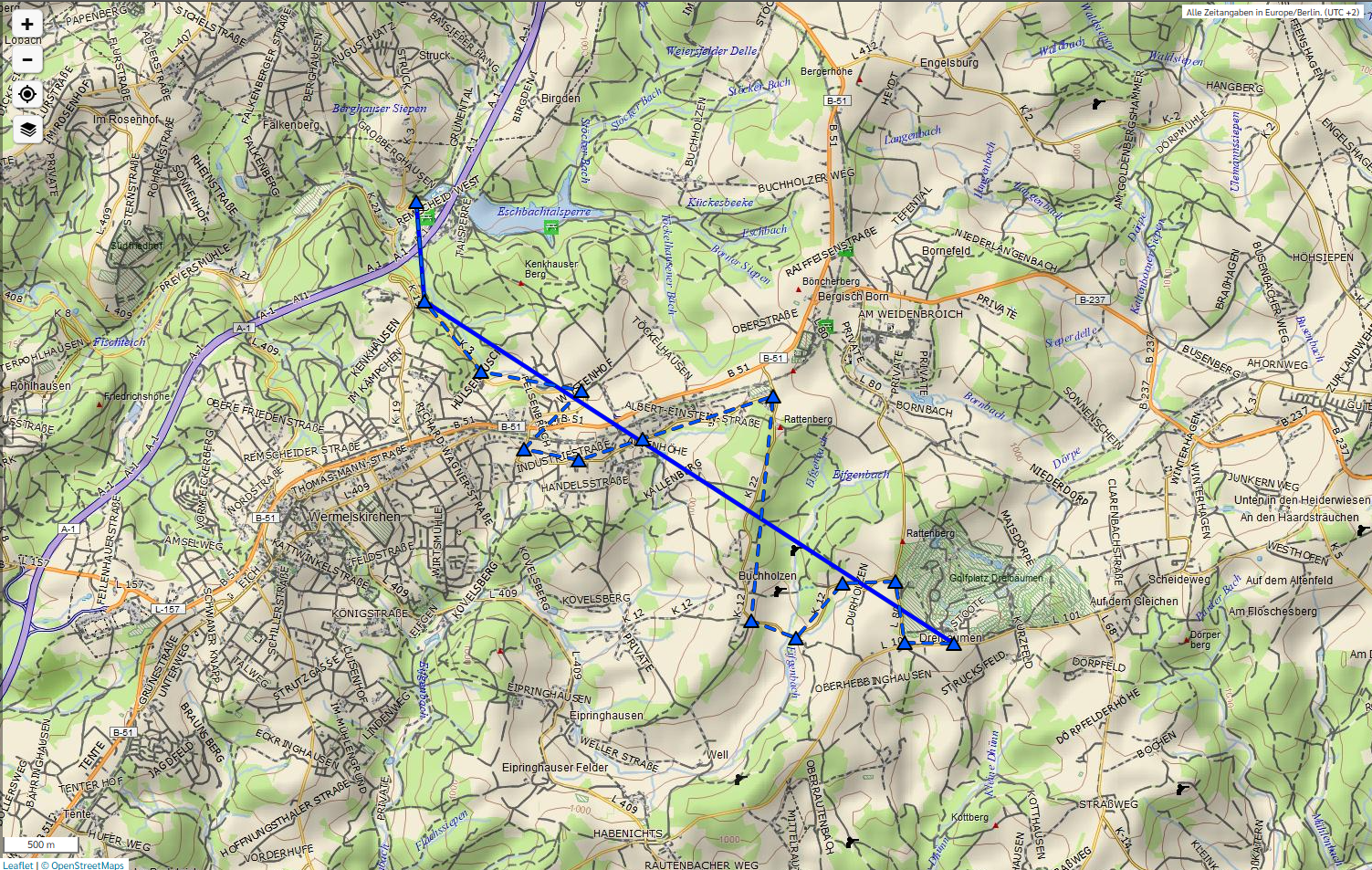

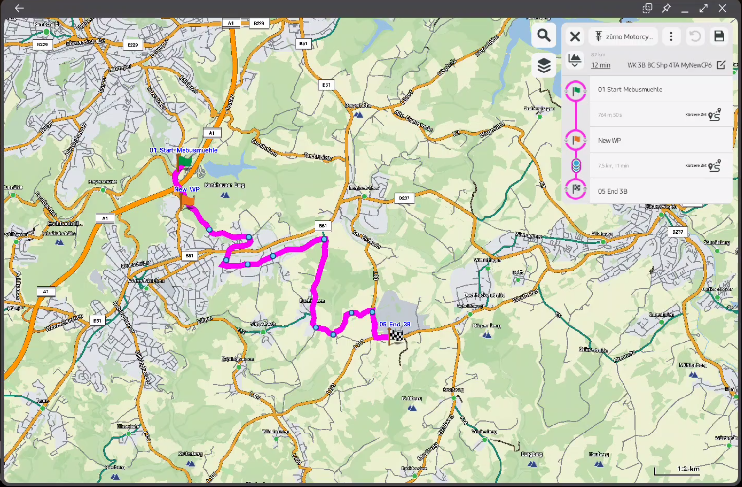

  • 0 initial i powered off my zumo XT2
  • 1st i created a Route in Tread App
    1 WK 3B Tread App 1 Route.png (2.47 MiB) Viewed 346 times
  • 2nd i observed the Route on Explore Web site
    2 WK 3B Explore Web 1 Route.png (3.71 MiB) Viewed 346 times
  • 3rd i converted the Route to a track, on Explore Web site also.
    ups ther are additinal Points, looking like the shaping points
    3 WK 3B Explore Web 2 Track from Route.png (3.7 MiB) Viewed 346 times

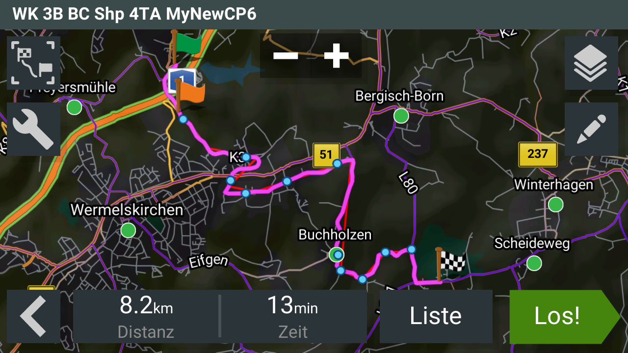

  • 4th i checked both in Tread App, Route and Track are looking like (nearly) same
    4 WK 3B Tread App 2 Track and Route.png (1.75 MiB) Viewed 346 times
  • 5th i powered on my zumo XT2
    i checked both in zumo XT2, Route and Track are looking like (nearly) same, at this moment
    5 WK 3B zumo XT2 (viaTreadApp) Track and Route.png (924.74 KiB) Viewed 346 times

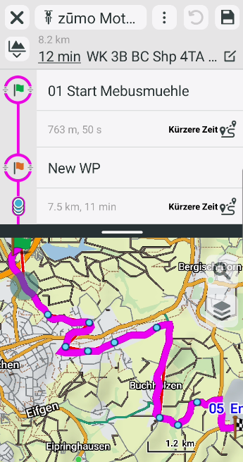

  • 6th i checked again in Tread App, Route looks like a little bit different
    6 WK 3B Tread App 3 After zumoXT2 Sync.png (1.81 MiB) Viewed 346 times
  • Intermediate step, i powered off my zumo XT2
  • 7th i started my second Mobilephone and checked Results Tread App.
    the data comes over the air from Web, include Shaping points
    7 WK 3B Tread App (2nd Phone) Sync via WLAN only.png (270.27 KiB) Viewed 346 times
I can clearly see my set shaping points, even on the Explore website, even if I don't recognize them as such first.
After i converted the TreadApp Route with Shaping Points to Track, the points apperas.
Only when the Tread app “cooperated” with the zumo XT2 were shaping points still there, slightly shifted, but the route was still usable as planned.
And my Last Demo Step shows, my second Phone got the Shaping Point from Web also (where Garmin is storeing which Detail, who knows).
However, @smfollen youe are right, it is very probably true that the Explore website does not seem to calculate Routes.

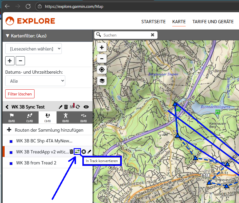

Did you convert the route to a track on the XT2 or with the Tread App?
I ask because, I'm not aware of any functionality on the Explore web pages to convert a route to a track. It is entirely possible that I'm missing something of course.
Posts: 512
Has liked: 39 times
Been liked: 97 times
smfollen wrote: Thu Oct 02, 2025 1:59 pm Did you convert the route to a track on the XT2 or with the Tread App?
Hi @smfollen,
I converted Route 2 Track on the Explore page.
Explore convert Route 2 Track.png (855.84 KiB) Viewed 305 times
The Tread app, the zumo XT2, and the Tread 2 are apparently unable to convert a route to a track.
I discovered the function on the website rather by accident while “playing around.”
I don't know if anyone needs it, but I personally don't.
