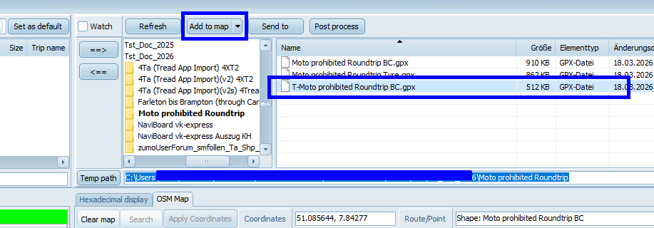

Oop North John wrote: Thu Mar 19, 2026 8:38 pm While I'm at it, can routes and tracks be shown at the same time on the map?
I've already sent a tip like that before ;-)
"... When use the map to see what the actual route data on the device is, may also compare it to the original by adding the origin track to the map: ... "

I saw that, but the "add to map" is also not active,and try as I can, I can't get the far right block to show anything to select, looking at the XT internal storage as I know I have tracks generated from a route there.

Oop North John wrote: Thu Mar 19, 2026 9:03 pm I saw that, but the "add to map" is also not active,and try as I can, I can't get the far right block to show anything to select, looking at the XT internal storage as I know I have tracks generated from a route there.
Dont navigate into the XT2 storage on the right upper block. Keep that for your Windows files.
The Left-upper block is for the Device Storage.
When you select one GPX on the right upper block you should be able to add it to the map

Oop North John wrote: Thu Mar 19, 2026 9:03 pm I can't get the far right block to show anything to select, looking at the XT internal storage as I know I have tracks generated from a route there.
The right block shows the contents of your computer—that's where you transferred the GPX file to the GPS, right?

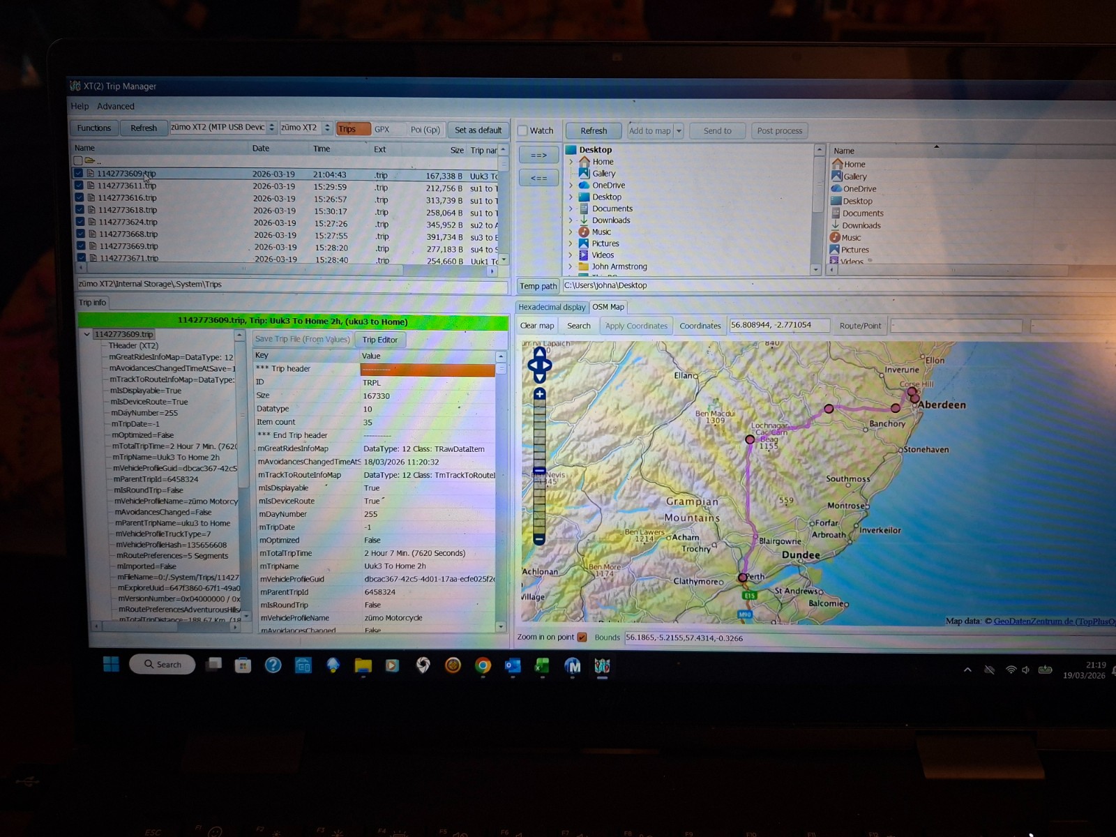

I shut down the XT2, closed Tripmanager and then reconnected the XT2 to my laptop, and opened up Tripmanager, and the check mark is still there. So either the programme remembers what the status that was last selected, or it does update the XT2.

As far as I'm aware I haven't transferred anything to my XT2, the right click has no link to do that. I wondered if the arrows next to the upper right block were for transferring data, but that's only because I've seen that logic used on other programs.
What I'm seeing on startup of Tripmanager is below.
