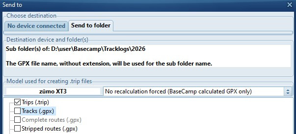

This could be key, and could simplify things for me. Consider this scenario.
- I create a route in Basecamp named "Damascus Day 3".
- I get that route and track onto the XT by using TripManager and doing a "Send to device" selecting the Trips and Tracks options.
- I then decide to modify that route. The route name will not change.
Normally I would delete both the route and the track using the delete functions on the XT, connect it to the PC, and then send the modified route using TM. This morning, I had the XT connected and TM running so decided to see if I could do the deletes and the resend without disconnecting the XT. Deleting the route (.trip) is obvious but I got hung up with not being able to figure out how to delete the track. Are you saying that I could have simply done the same "Send to device" from TM with the modified route and that would have overwritten (with prompts) the existing .trip and track on the XT?

Peobody wrote: Mon Apr 13, 2026 6:31 pm Are you saying that I could have simply done the same "Send to device" from TM with the modified route and that would have overwritten (with prompts) the existing .trip and track on the XT?
Yes.
