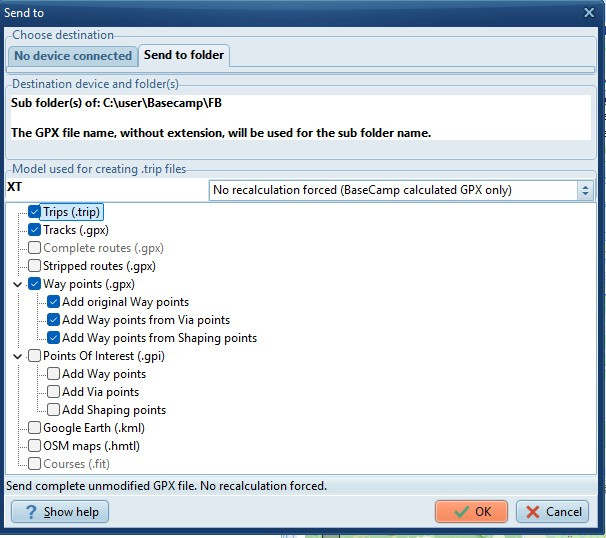

Thanks once again for putting TripManager in the spotlight.
I would like to add 'if requested' to the quoted remark though. Meaning it will only do that if requested in the 'Send to' dialog.
You have to select the items to send by ticking the corresponding checkboxes.
(Screenshot from V1.6, not yet released) BTW: TripManager would not have evolved to such a useful tool, if it weren't for the help and support of this forum. To name a few @jfheath, @smfollen, @proofresistant, @Peobody, @Stu Apologies to people I forgot to mention.

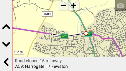

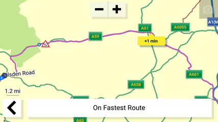

Same route with a start and finish. Lots of nearby 'incidents' listed - but 16 miles ahead a raod closure. No option to recalcluate. No immediate recalculation as had been the case before.
But you can display the map showing the incidents and select the closure. and it will show a detailed map and the nature of the incident. Then from the 3 bar menu, you have te option to recalculate.

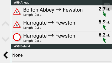

I believe that it is possible to obtain a screen like #5 in this link
app.php/ZXT-P54d
This was obtained from an XT1, but I have reproduced it on an XT2. It only shows the 'items' that are on the route ahead or behind.

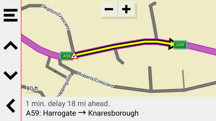

Edit - Additional Info from XT2 screen

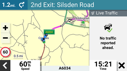

1. Live Traffic is displayed in the right hand pane - by selecting the option from the lower right 3 bar menu menu.
2. A Traffic map can be obtained by tapping on the Live Traffic Pane. Zoom in and scroll around.
3. Tap the banner on top of the main Navigation Screen
This gives a list of turns up ahead, but you can scroll down and see info about traffic delays.
4. Tap one of the incidents on this list.
Here's another example: Tap one of the incidents - eg Lane Closed
This gives a cose up view of the location
The 3 bar menu in the top left corner gives the option to avoid this incident.
5. From the main menu, select Apps -> Traffic -> 3 bar menu -> Incidents
This gives a list of all of the traffic related incidents and road closures in the area. You can then select the road that you are on
You can then tap on the individual incident to get a close up map of the location.
In this particular example, the road isn't closed at all - it has been made one-way. Diversions were in place on the road, but the stanav was quite happy to navigate straight through the one way system in the wrong direction. The black arrow on the map indicates which way the traffic should flow. But to be fair on the XT2 - that white/red circle is at the wrong end of the road. It isn't closed to traffic from the east.
The Zumos do not seem able to extract the fine detail from road closures. IT is either closed or it isn't. So brief road closures some of the time (eg for 10 mins), or as in this case - closed in one direction only. It seems to chose Yes or no. and sometimes gets it wrong. So I tried the simulator going in the opposite direction. It told me that the A59 was closed and was switching to a new route.
So this issue is not a Garmin or an XT2 issue at all - it is whoever is creating the mapping for road closures !
app.php/ZXT-P54d

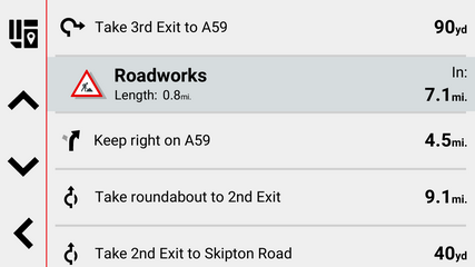

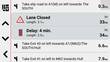

Many thanks, tried #5 today on the M6. The XT2 showed the ahead and behind as your example. It did get confused as I passed through some congestion as on the far side of it it was in the "ahead" section, but with an arrow showing that it was behind me.
A PITA having to scroll through all the minor roads in all directions before being able to select the M6. But, who buys Garmin GPSRs for sensible software?
