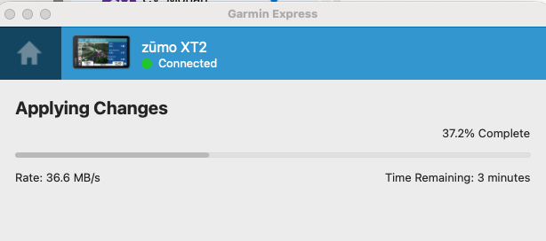

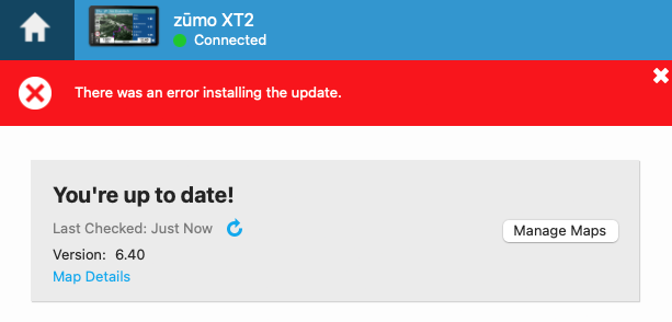

Currently, with the XT2, I am unable to install maps on my Mac.
It starts the download:
Screenshot 2025-12-31 at 12.35.24.png (32.94 KiB) Viewed 624 times
And then when it is around 70% it fails. I tried a dozen times.

Which version of Garmin Express are you using?

Latest - 7.27.0.0.
I just reinstalled it. Removed all cashes and it is still the same.

It doesn't work.
It fails each time around 73% (~5.8GB of City_Navigator_Europe_NTU_2026_30.gmap)
Garmin Express (macOS) consistently fails XT2 install maps to the computer at a similar file size (~5.85 GB, ~73%) on every attempt.
Logs show that multiple map components are successfully downloaded and written before the failure, e.g.:
Starting transfer to [D6210330A.img]
Finished transfer to [D6210330A.img]
Starting transfer to [DA215020A.img]
Finished transfer to [DA215020A.img]
Starting transfer to [D8526110A.img]
Finished transfer to [D8526110A.img]
Starting transfer to [D6159330A.gma]
Finished transfer to [D6159330A.gma]
Immediately after these successful transfers, the install aborts with (that is from log file):
Error Domain=NSPOSIXErrorDomain Code=12 "Cannot allocate memory"
UniversalMapInstallToComputerOperation -> Changed to [Canceled] / [Failed] phase
Same errors regardless of Garmin Express version.
I have plenty of disk space, plenty of free RAM.
I even tried mounting another SSD drive to the folder where it downloads those maps.
Another hours lost on something that Garmin broke! They had great devices few years back, it is just downhill sadly.
Delete the Existing Map files that are on the Zumo - the files that are causing the issues.
These are in: Internal Storage/.System/Map
There are possibly 3 files that have the same prefix, but different suffixes. I would take copies of the smaller files first eg .GMA - just in case - it shouldn't be necessary but .....
You can find out which file belongs to which map with your Zumo connected by USB to Basecamp. Click on the map name under 'Devices' in the XT2 tree, and read the information in the bottom left pane. Mine says D621033a.img for the City Navigator Europe NTU 2026.3
That should help you find the filename that is causing problems for the named map that you are installing. So if City NAv 2026.3 is not installing, delete all of the files that are called D621033a.*
Then reinstall just that one map.
(This is not just a shot in the dark. It happened to me once, and deleting the partially installed map file, before using Express to reinstall it, solved the problem).
But before you do any of that
- just check how much space you have available in internal storage. It may be necessary to delete another map to make room, and install it onto the SD card later
jacq wrote: Wed Dec 31, 2025 12:40 pm And then when it is around 70% it fails. I tried a dozen times.
What do you see if the "Manage Maps" tab is selected?
I see on my Windows lap top what maps are where, including the micro SD card, and it lets me select what map I want to update.
