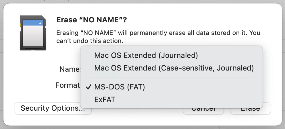

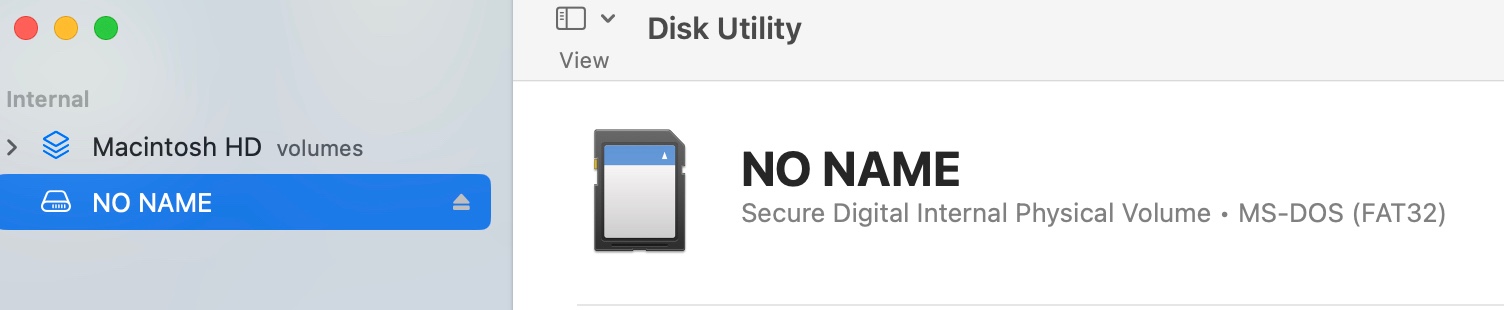

danham wrote: Wed Mar 22, 2023 12:23 am I use FAT 32, which you can do using Disk Utility or the excellent SD Card Formatter app on my iMac. Route files, even long routes, are pretty small, so no need for ExFAT.
Thank You Dan! I'm thinking, no way..... Then I opened Disc Utility. I now see that FAT 32 is the same as MS DOS (FAT) I didn't realize that.....dahh. It does show it in the first pic. :oops: I will indeed run with that! Thanks again! :roll:
FAT32 1.jpg (63 KiB) Viewed 2329 times
