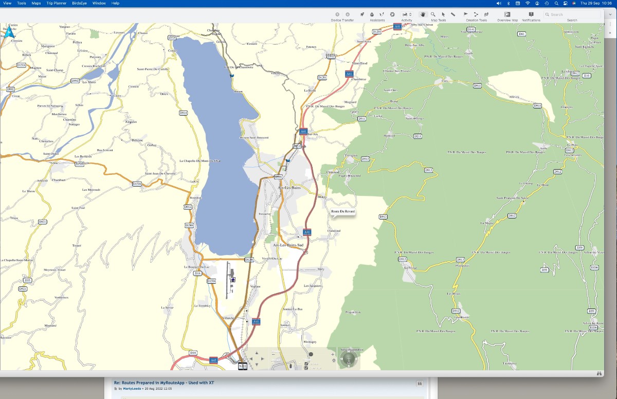

I am back in Blighty and thought I would update you lovely people with my experiences.mad-dawg wrote: Thu Aug 11, 2022 9:40 am Thanks for the report FF
I will give it a test, if I can ever find a front tyre for the bike![]()
The big test will be in September in Germany, they do like to close a motorway and give you no diversion to the next open junction.
Apart from the first day route from Rotterdam to Trier which I planned at home and sent to the XT, all the other days were planned the evening before in MRA on an Ipad.
Each route was sent as 1.1 track/POI, and recalculate was on and the route in MRA had a start and end point with shaping points as required to follow the planned route.
Most days this worked really well, if I went off route I got the U turn thing and then the XT gave up and plotted a route to get back on the original.
Except! on one day travelling from Barcelonnette to Aix-les Bains it acted the fool. When I got within about 30K of Aix it wanted to follow the planned route on the Peage, I being a Yorkshireman decided to follow the signed non peage route to Aix les Bains.
The XT repeatedly demanded U turns for the rest of the journey, trying to force me back to the motorway, even when I got to the town and pulled in a carpark to check google maps to see where I was in relation to my hotel. (About 500m away)
At this point I had travelled 30K north with the XT saying that I should turn round and travel 30K south to join the motorway and then travel about 40K north to Aix les Bains. There were no shaping/via points forcing this and I just muted the voice instructions.
I checked the track in Basecamp yesterday and it shows the planned route and the actual track of the diversion I took, I have no idea why it was sending me on a 70K diversion when the end point was 500m away.
Anyway, thank you John for your help, I now have a process that works most of the time.
- Image 29-09-2022 at 10.37.jpg (187.33 KiB) Viewed 2032 times

Hi @mad-dawg , welcome back. Hope you had a good trip. The last time we were able to tour in Europe was in 2014, when we rode down through France to do parts of the Tours des Grandes Alpes and Route Napolean. A really sepctacular 2 weeks. The second day in France took us to Annecy - about 20 miles north of Aix-les-Bains, and for us the following day, the start of the alipne passes. I thought that we had actually been through it - but looking at my satnav logs we didn't. It must have been the town that was on all of the signs.
Anyway - I am interested in your observations. I wonder if you would mind sending me your route and your track (if you have them) for that day.
The reason I am interested is that I have seen this many times before. Once it gets into a cycle of taking you back - it can never recover. The reason seems to be that it is taking you back to the point of last instruction that it gave you - that being the place where you left the route. Not the original route, but the one that it modified to get you back.
I lodged this issue with Tech Support a good while back, and gave them detailed illustrations, but we have had v6.4 and 6.5 since then and nothing has changed. I mentioned it again a few weeks ago, because I have been able to prove to my satisfaction that every time it repeated the demand to go back, it stops recording the where 'you have been' track in the active logs. I got notice this week that this query has been escalated to a Product Support case.
I've created a new section in Everything you need to know regarding MRA exorts, that you may have missed. app.php/ZXT-P72
V1.1 keeps all of the route points, via and shaping, and allows the XT to claculate a route when it is loaded.
I've noticed that when the XT recalculates the route, it sometimes produces a different route from the one that it calculated when it was first loaded (if shaping points don't pin it down too tightly).
I've also just discovered that if you have a route with a start and end and a middle Via that if you change the middle Via to a Shaping, then the route may calculate differently. Put the shaping back to a via, it goes back to what it was. (Just a couple of tests to create this hypothesis).
BUT - If I put a shaping point immediately after the start and another immedialtely before the end - so that they have no obvious effect on the route, and then switch the middle Via to a Shaping - or Shaping to Via - the route calculated remains the same.
Now this is very odd behaviour, and it suggests a difference between using Vias and Using Shaping points.
I have a route that I use where I know this repeated - perform a U turn continues until I am only a couple of miles to the next Via Point on the route. Until then, it will be routing me back 28 miles to reach the point that is just 2 miles ahead. I know that this particular route (that I evidenced for Garmin Support) had a Via point at each end of this section. I'm wondering now if adding shaping points close to those Vias will make a difference in behaviour.
I performed a test in the car a few weeks ago, and deliberately went off route. This behaved properly. But every single route point was a shaping point.
I'm suspicious of the gpxx subclass data in the gpx file for the Via Points. If you strip out all of that (MRA doesn't include any of it in V1.1) then it solves some other problems - like the fact that the XT renames the route points. It doesn't do it if you send the route from MRA. It doesn't do it if you send the route as a direct route from Basecamp. It doesn't do it if you manually replace the subclass info with the default '000 ... 000FFF ... FFF' value.
This has become a puzzle that I want to solve, rather than something I need to do. I'm happy that I can make a route behave as I want, and as a fallback position, I have the track visible underneath the route.
