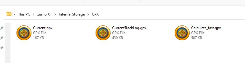

Hi Frank
- if I import your GPX file into Basecamp then the modified route will NOT be loaded fast (same as always ~1mn50s/2mns)
- If I copy your modified GPX directly on the GPS (with the explorer) the modified route will load fast.
Re: when importing route prepared with Basecamp, XT recalculates
Posted: Tue Feb 28, 2023 12:44 pm
by FrankB
Thanks for testing and reporting back Chris. It confirms what I have found.
chris7444 wrote: Tue Feb 28, 2023 12:26 pm - if I import your GPX file into Basecamp then the modified route will NOT be loaded fast (same as always ~1mn50s/2mns)
I assume that you then send the file in Basecamp via USB? That is something I did not test.
Posted: Tue Feb 28, 2023 1:44 pm
by chris7444
FrankB wrote: Tue Feb 28, 2023 12:44 pm Thanks for testing and reporting back Chris. It confirms what I have found.
yes. GPS connected to the PC with USB. Then your file copied to the XT using the file explorer .
correction:
The first time, I imported your GPX in Basecamp then used Basecamp / "Send to Device" to copy it to the SD card. Using this method your GPX file is not loading any faster than the original one (~2mns)
The second time I copied your GPX file on the GPS without importing it into Basecamp (using the file explorer) like in the picture below . In this case the route is imported in less than 1 or 2 seconds
direct copy.png (16.55 KiB) Viewed 3320 times
